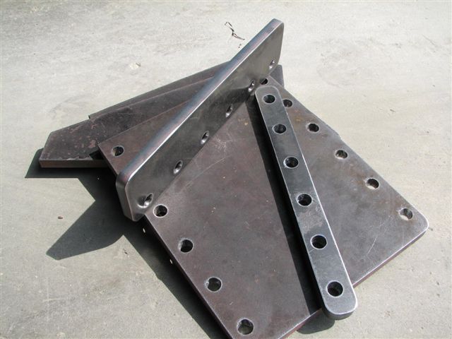

Attached are some pictures of parts cut with my Powermax45 in my home shop....which I use on both a PlasmaCam and a Torchmate cnc machine.
Jim Colt

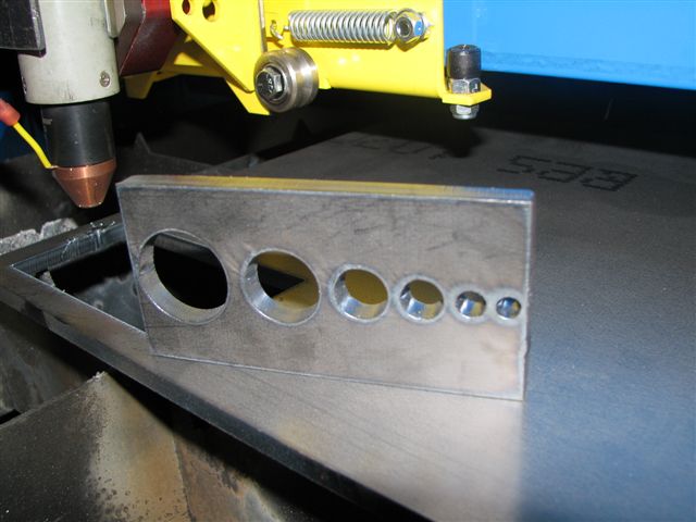

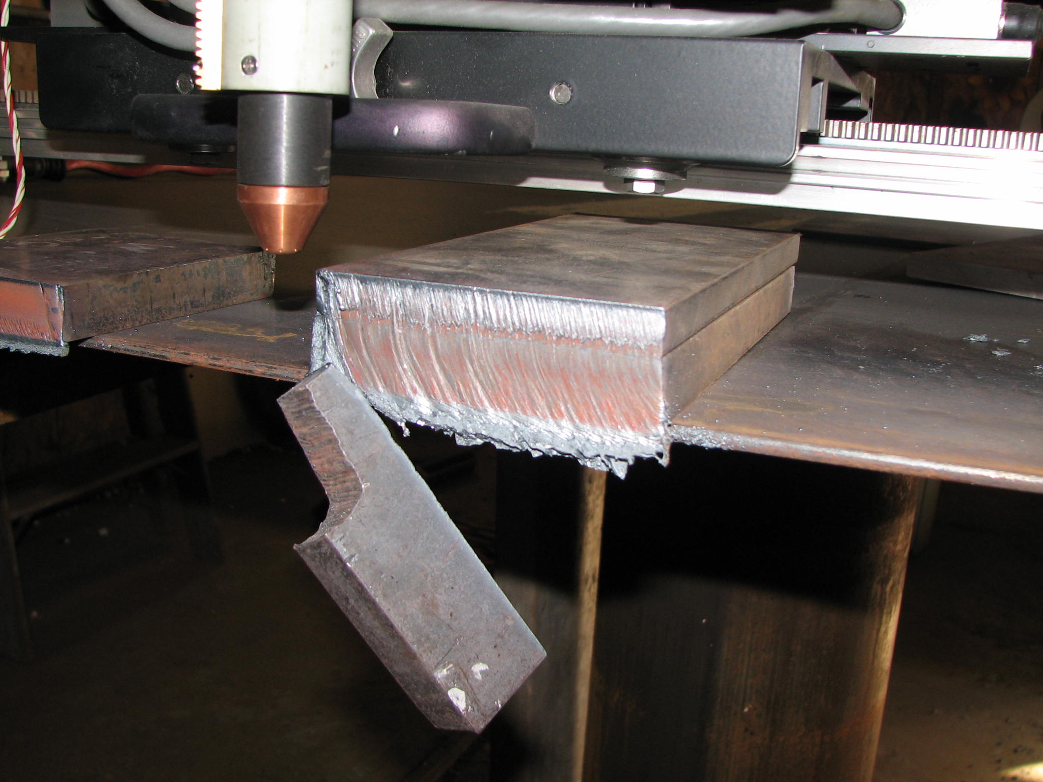

first pic: 1/2" steel parts for a logsplitter, 2nd pic:1/4" steel with holes from 3/16" to 1.5" as cut, 3rd pic: 1/4" steel bracket, all holes cut with the Powermax45....some tapped 1/4"-20, others countersunk, last pic: 1-1/2" steel being severed with the Powermax45!

That's pretty impressive Jim! :thumbsup: Those holes look like they were drilled.

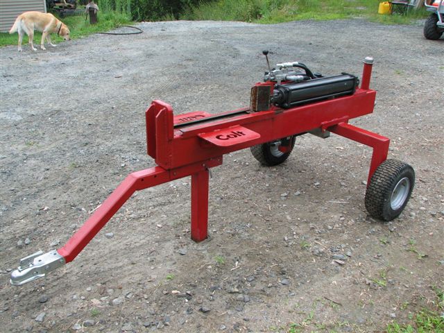

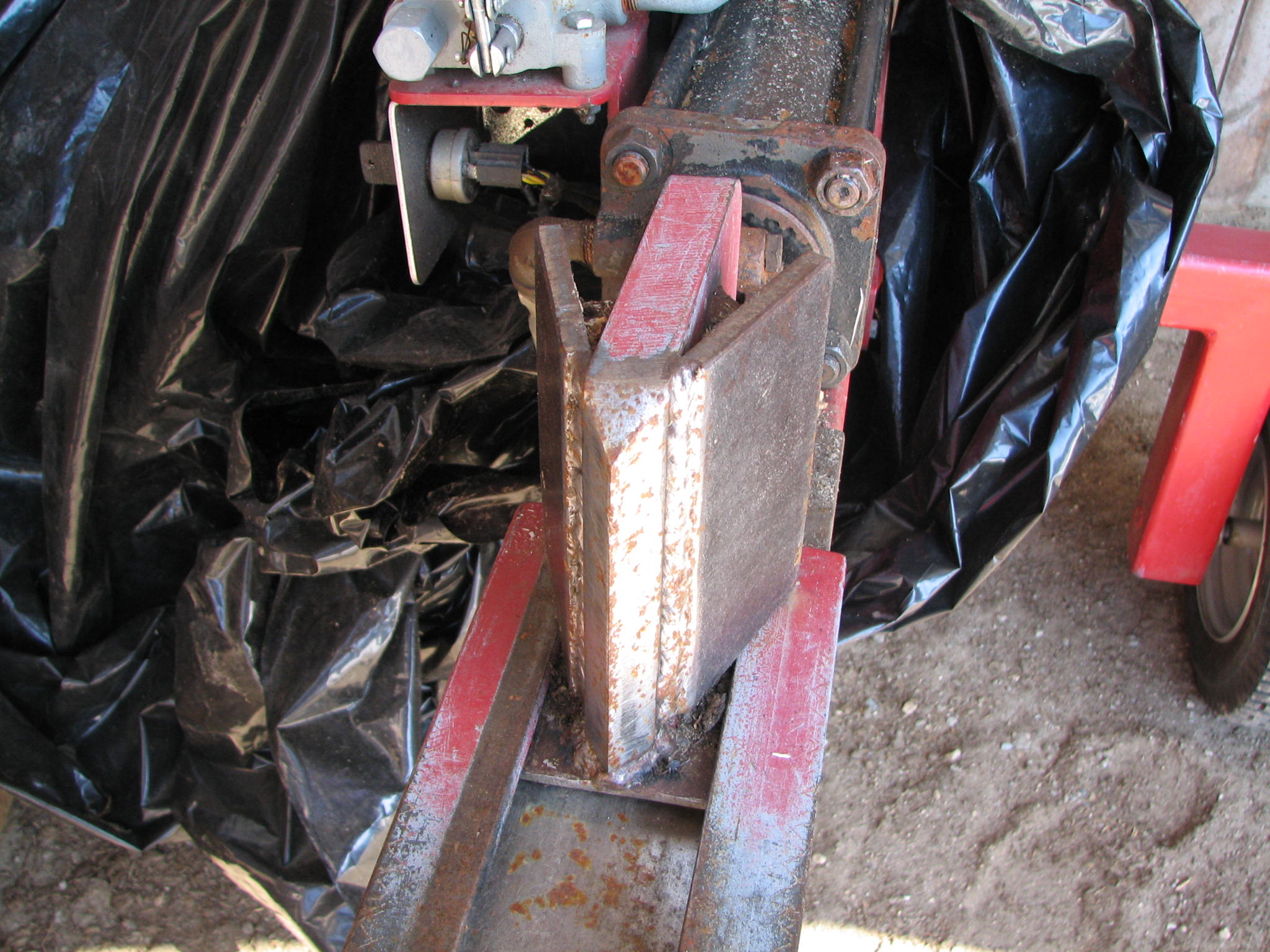

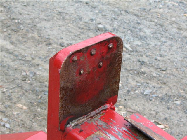

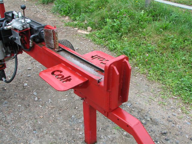

This splitter wedge was cut with my Powermax45....it is 1" steel cut at a 45 degree bevel....which is about 1.4"....slow cut (about 4 inches per minute) but nice. Every piece on this splitter was cut with the 45. Notice the log shelf with my last name cut into it...this is so my friends remember where they borrowed the splitter!
Jim Colt
