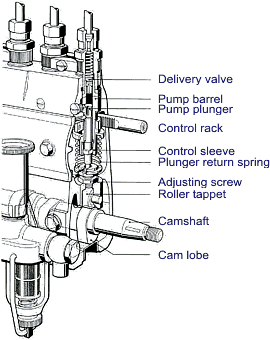

It Just has the spin on filter , what is the sticking rack ? How , can I unstick it if possible ?
Will check banjo fitting for clogged screen Yea I fill thru bleed on spin on , crack injectors till fuel shows
button up and she'll run till fuel drops in filter but with no rpms .
   / Y385 won't stay running #4
There is an upper side cover on the pump assembly. Remove the cover to expose the fuel reservoir and control rack. Be careful of the gasket. The control rack is attached to the governor, NOT the throttle linkage, so be careful.
