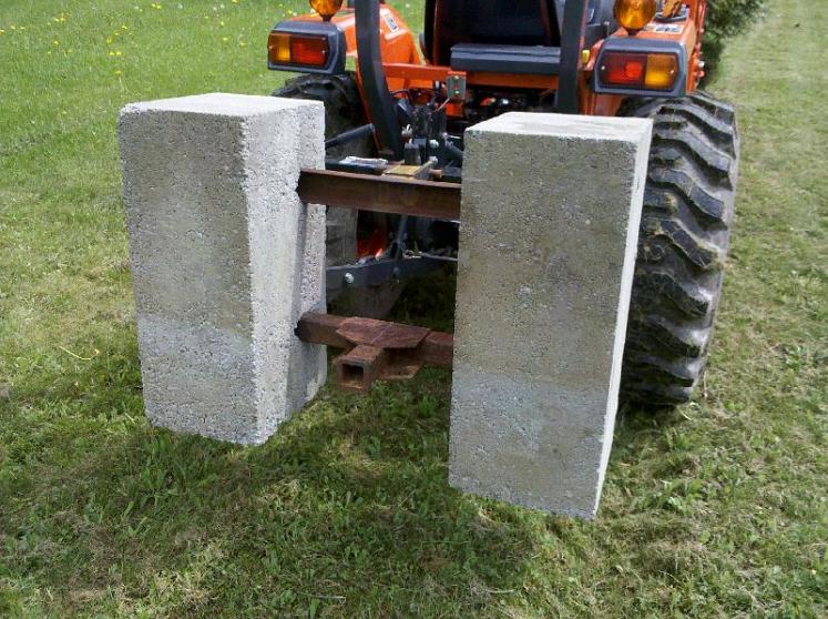

I wasn't really sure where else to post these ballasts that I found on the internet. This first one I found on another website. I forget where I found them, therefore I can't give credit to anyone who designed them.

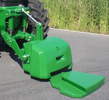

   / YABB (Yet Another Ballast Box) #37
This one I found on the internet as well. It is far from being home-made. Apparently it is available in the UK.
It has a very slick look. I guess we have to give them on the other side of the pond credit for "thinking outside the box".

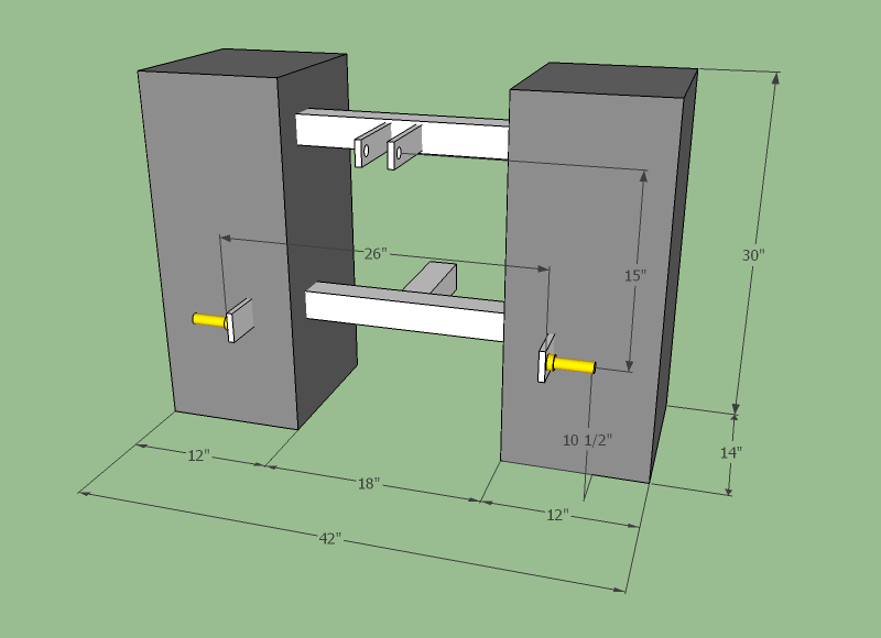

Following some of the many good tips from this forum, I decided to go with a concrete filled ballast box for the 3PH, to help when the FEL is picking up big loads.
My three requirements are:
1) I want to keep it as tight to the back of the tractor as possible for maneuvering around.
2) It needs to weigh about 1200 lbs to provide adequate counterweight.
3) I want to make it work with my HF quickhitch so I can pick it and drop it easily. I really only need it when working with the grapple. The rest of the time it'll sit on a couple dollies.
I know there's 100 different ways to add ballast (i.e. counterweight), but I talked with a local fabricator and he is willing to build a metal box for $150, and the concrete place across the street from him is willing to fill it up for free with leftover mix, so this turned out to be the easiest way for me to do it.
I drew up a (overly complicated) sketch of the box for the welder, and I'm posting it here for any comments or suggestions before I have it made. Any further thoughts on this much covered topic?
HH
I can't get your drawing to open. Computer tells me this type of file is risky, but even with the risk it will not open. Suggestions???
   / YABB (Yet Another Ballast Box) #40
You'll need Adobe Acrobat Reader.
If you have it (Adobe Reader) and it still doesn't open, you may need to update Reader.
