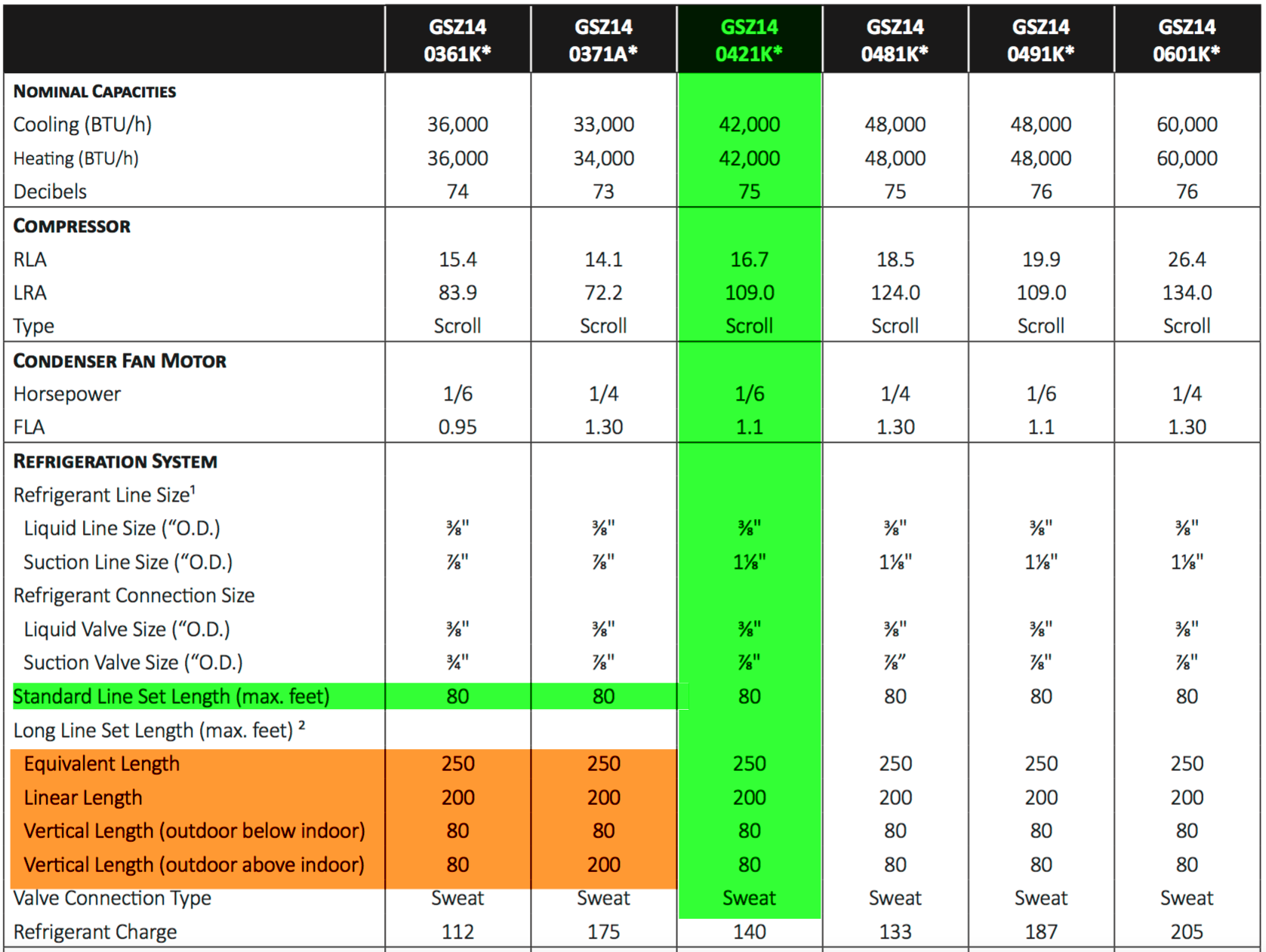

The HVAC guy mentioned the efficiency of the line length.
I'm curious as to what brand he was proposing as most technical data sheets on equipment will give you the capacity loss with extended line set lengths, not the efficiency loss. Generally, on most split non inverter equipment, a long line set isn't considered long until you hit 80'
I don't do Goodman, but see attached what I found online (per the existing size equipment you have, and perhaps what he quoted since it's the brand there now).
You'll notice, even for a 3.5 ton heat pump system, 65' isn't considered "long".
The current unit is Goodman and that is what we will use as a replacement.
Our line is long because it has to go from the outside unit on the north side of the house almost all the way across the house to the south side.
<sigh> This is a big sore point with me and has nothing to do with the current HVAC guy. The HVAC contractor who installed the system when we built the house was the one guy who %^&*( things up. He messed up drilling through the brick for the condensation drain. The mason wanted to do bad things to him. When the equipment was installed in the attic, it was supposed to be built on structure above the ceiling joists to maximize insulation. Instead, they just threw down OSB and installed the equipment. The insulation guy insulated as best he could but I think we put in 30-40 inches of insulation in the attic except where equipment in installed where we could only get 6-8 inches...
The electricians where in the house when I went out to check on progress and they said nothing to me when I was looking at what had been done but they were waiting to see my reaction. :rolleyes: The danged electricians knew the HVAC installation was not installed the way it was supposed to have been done.
The reason the line goes 60ish feet is because they were going to install the outside unit on the south side of the house. This would be much closer to the equipment in the attic but the south side of the house is NOT where the unit was supposed to go. :rolleyes: It was supposed to go on the north side of the house. Now the GC caught this in time to move the compressor but the equipment was already installed in the attic. and thus the long run.
Sooooo, when the current HVAC guy saw the line, he just mentioned in passing that the installation was not efficient. Looks like it is in spec thankfully.
