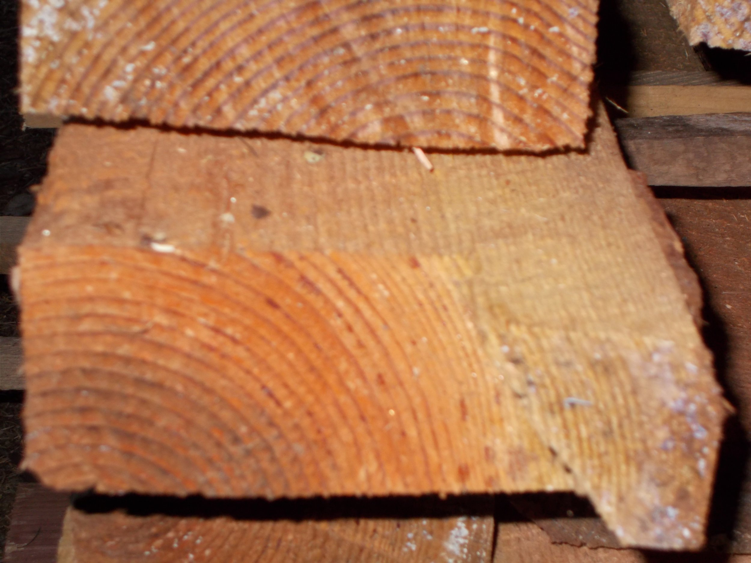

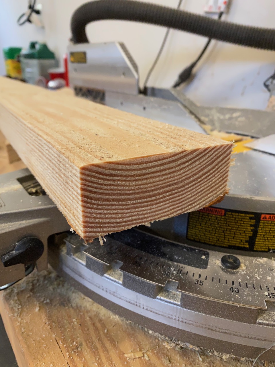

This is an average piece of yellow pine that I saw for 2x lumber. Look at all those rings. Be lucky to get 3-5 rings in a store bought 2x. Tight grain like this will be much more stable and handle much higher bending stresses.
One of the nicest surprises about milling my own lumber is how much better it is than what I can get at a store. They sell junk wood nowadays.
I do careful culling to avoid knots when they would be an issue for structural loads. My reject rate is probably around 5-10% including bad knots, warping, and other defects. I am a bit more liberal with bark on the corners as it rarely matters for framing carpentry.

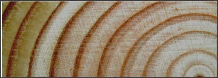

Looks like you have some pretty slow growing & strong trees!
Are they slow growing due to a high elevation?
I am slowly getting rid of some fast growing no-good fir trees (so-called "piss firs") where the annual growth rings are as wide as my thumbnail.

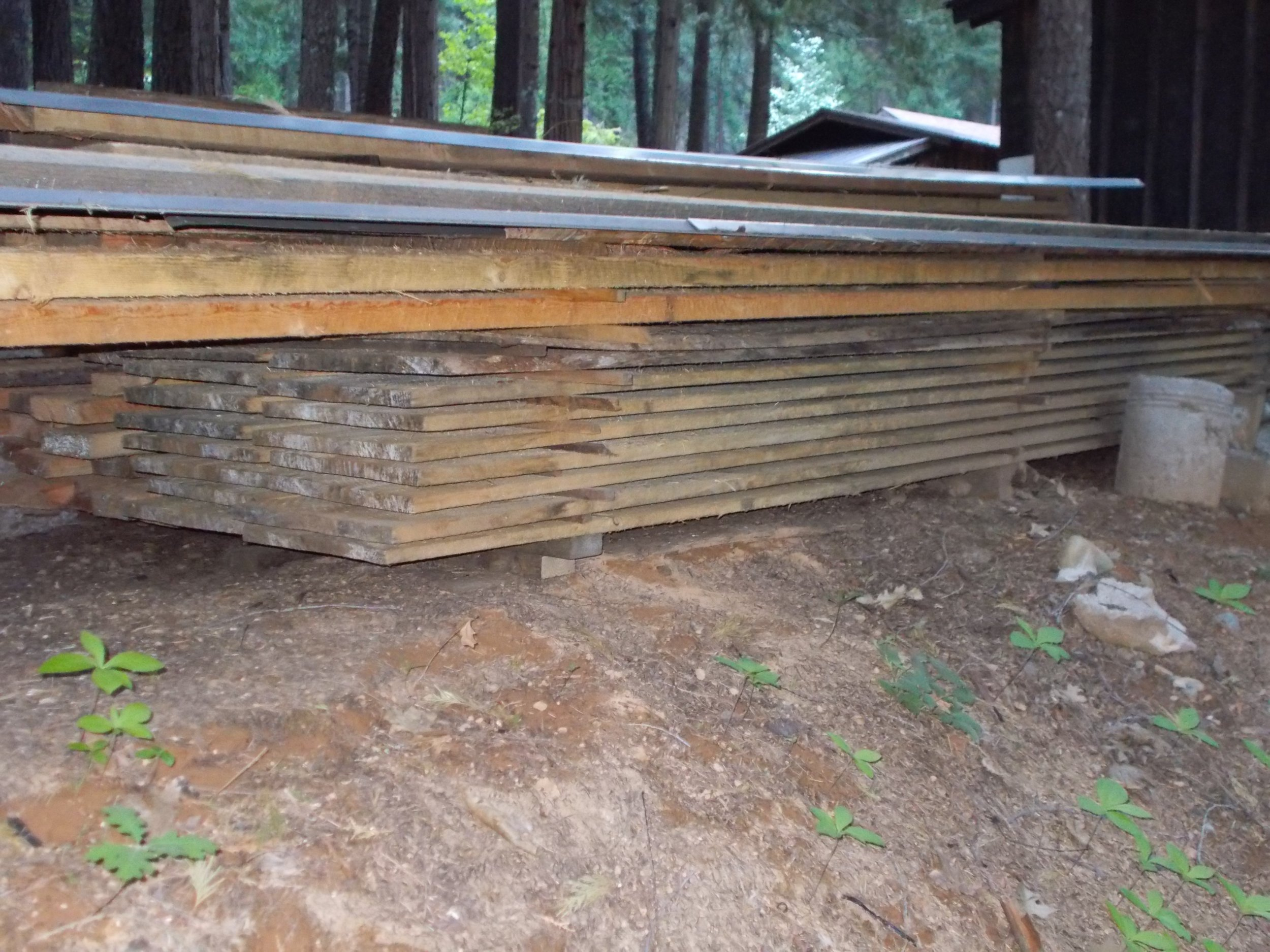

Home milling is the only way to go for me now and for the last 40 years. Some 50+ 2x6x12' doug fir and some 1x12 x12 pine boards all cut last fall. Stickered and covered with metal for a slow dry. The grain is tight compared to commercially sold crap of today. I know from years of being a mill operator and builder what a good board is yet I would need a fresh out of school engineer to certify it? PFFFFFT!DSCN0354.JPGDSCN0356.JPGDSCN0357.JPG
We're only about 40' above sea level in Virginia, near the coast. The trees are about 30-35 years old. I figured they would have some big rings but that has not been the case except for a few trees, and only the center rings tend to be big. I guess they must grow fast at first and then slow way down.
There's also a lot of seasonal variation in the rings, some years they grew faster than other. I imagine I could trace that back to weather and rainfall/drought in those particular years, but I'm too busy sawing and using the wood to get into the science.

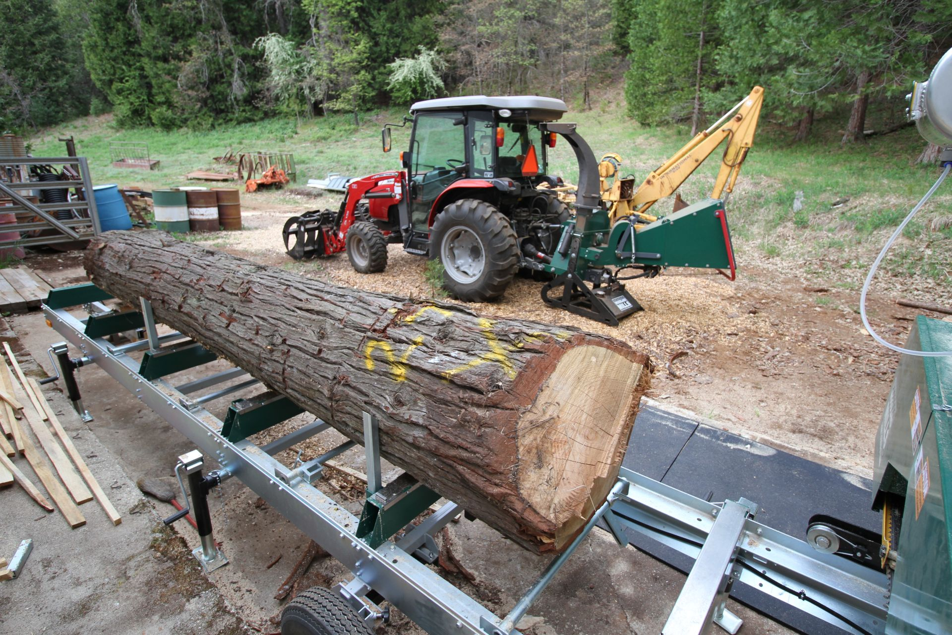

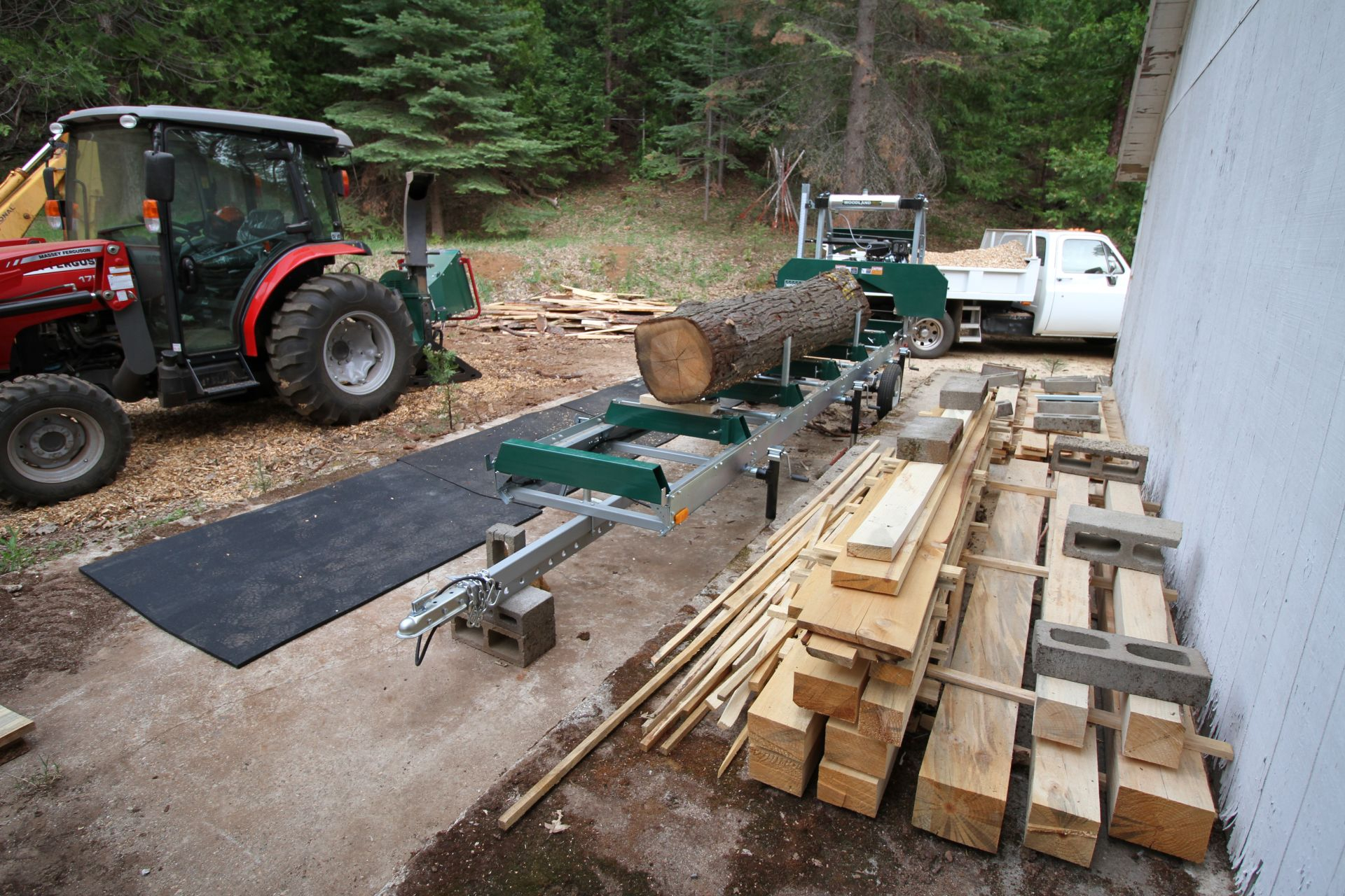

I took a picture of my "trash to treasure" setup tonight. I realize this is "small potatoes" compared to many. But I'm happy with it.
The wood chipper blows the chips into my dump truck and then I spread them; the sawmill makes the lumber. The log on the mill is cedar. It still has removal markings from the utility company. I still have about 15 more logs like this (mostly pine) and haven't yet cut a tree down.
This cedar is 24" at the butt, 20" at the narrow end. It would have gone to waste if I didn't mill it. Tomorrow it will become very nice lumber.
Note: 2nd pix is in next message. For some reason it would only accept 1 pix at a time.
