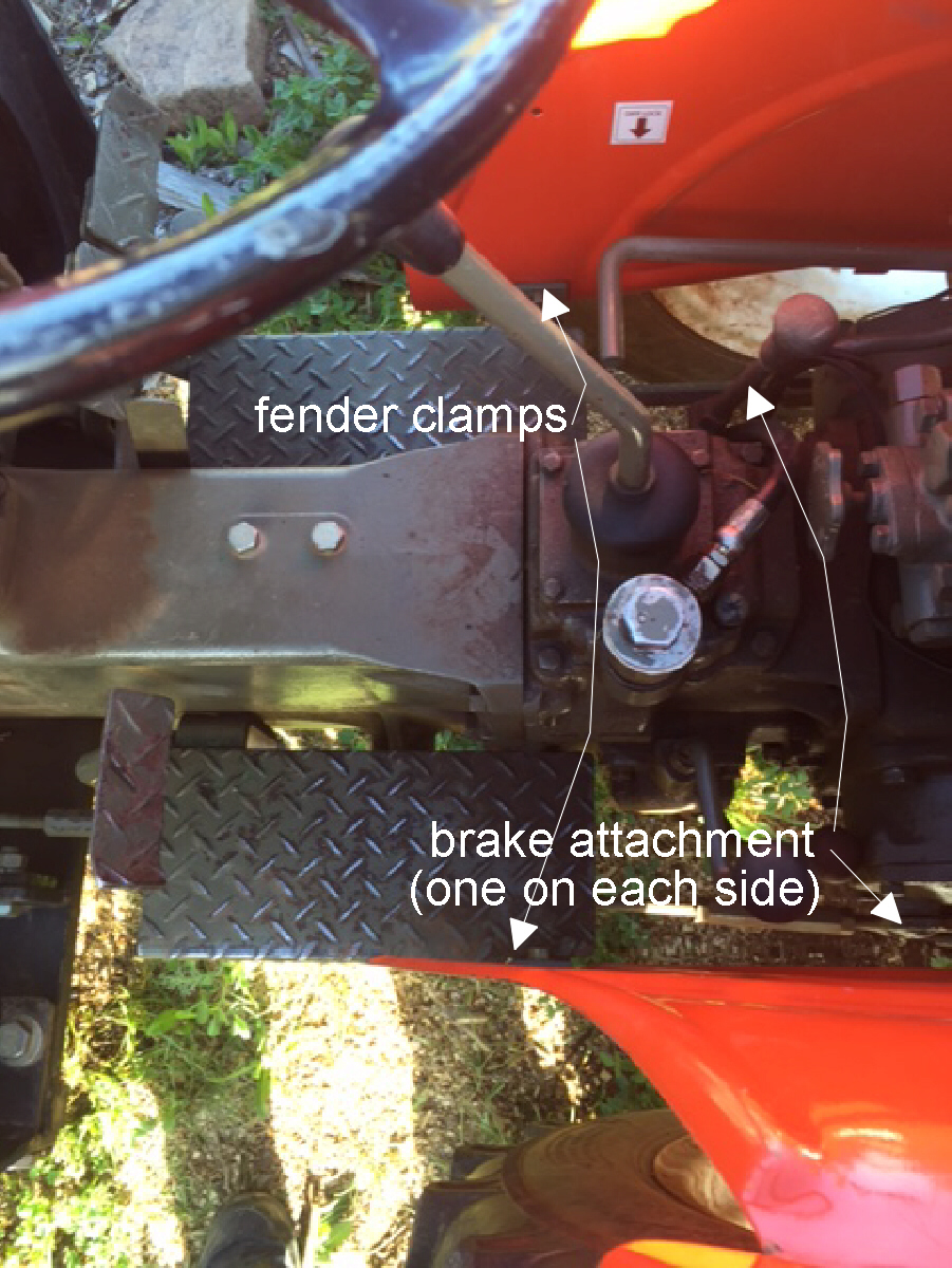

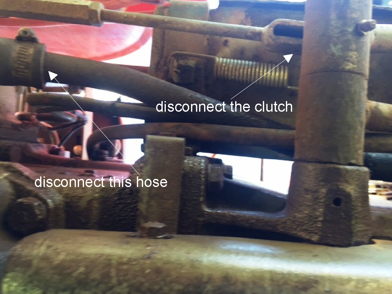

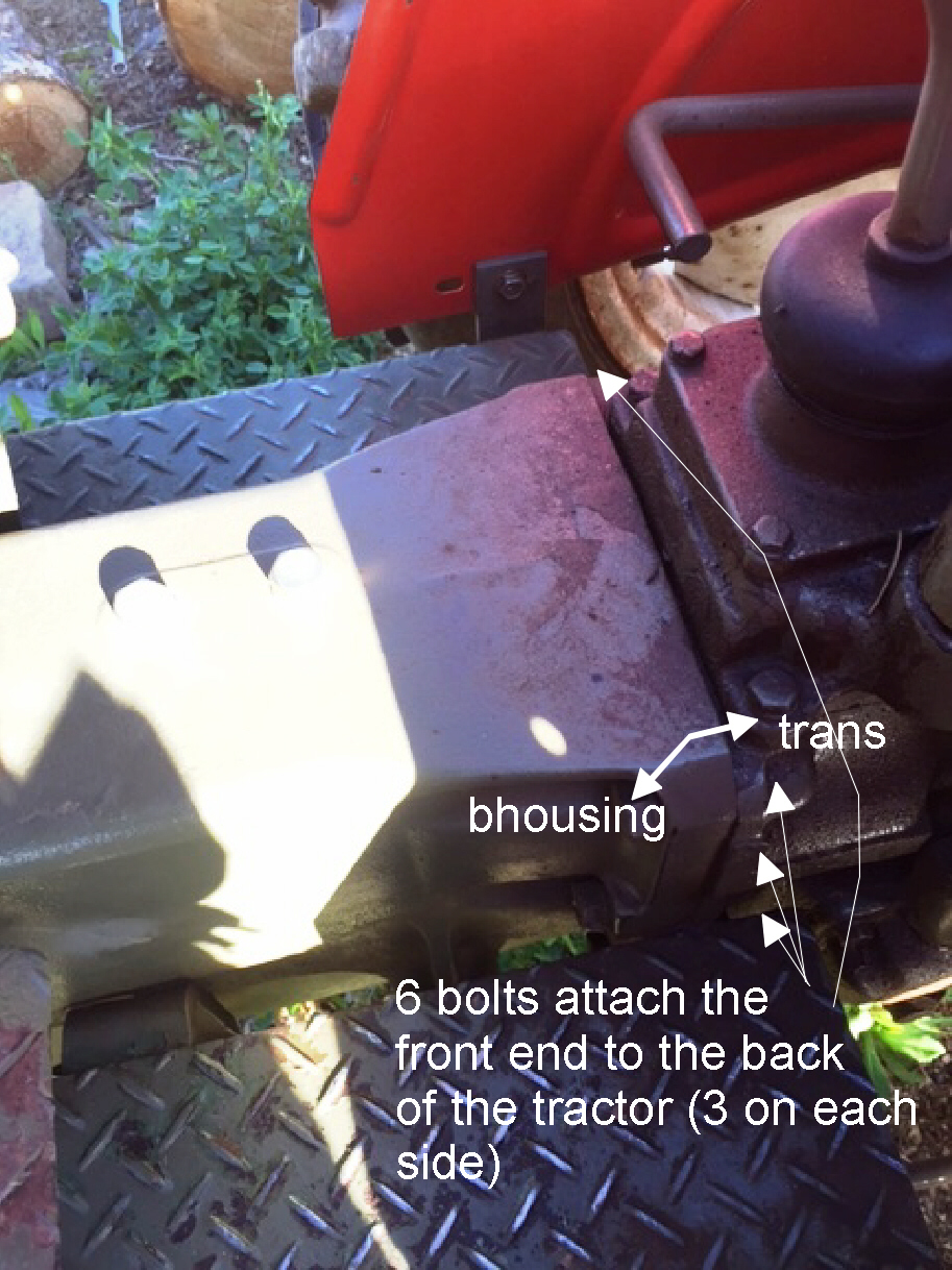

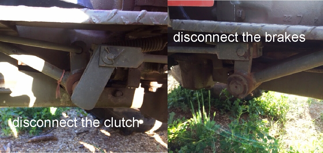

Yes this is the first tractor I've ever owned so I am a newby. It looks likes it is leaking from the Transmission input shaft seal, this looks very easy to repair. Is that the only seal there or is there another one in the front of the bell housing? Here are some photos of images that I took of the tractor, let me know what you think. Thanks. fix1.jpgfix2.jpgfix3.jpgfix4.jpgfix5.jpg

unless your machine has a torque tube, the union needing separating to repalce the tranny input shaft seal, is where the bellhousing attaches to the engine.. not where the trans attaches to the rear of the tractor.
This sound slike your first rodeo.. and there ain't nothing wrong with that. we all did it 'the first time' once. You might want some help on this.. perhaps someone who's done one before.
If you have a parts list for your tractor post it.
I can't tell if your bellhousing is setup similar to a torque tube.. that will tell you where the seal is.

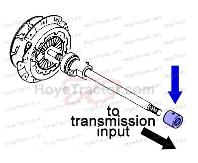

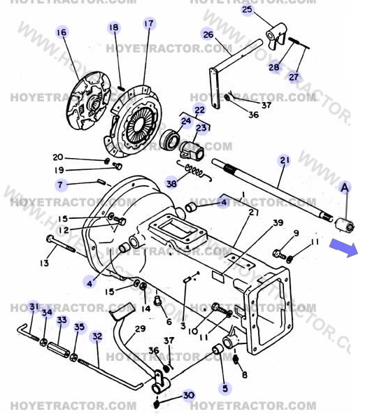

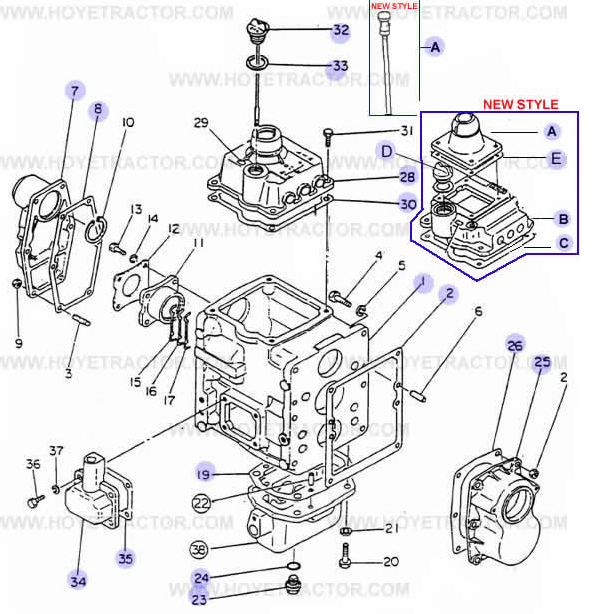

The bellhousing attached to the engine and the bell housing is long about 2 feet. I can't find a seal in the front of the transmission or it doesn't show on on the schematics shown. Here are some pictures but I can't see a seal anywhere. But it's leaking right in front of the bell housing from the starter casing and around the bell housing. Can't figure this thing out. yanmartranny.pngclutchbhousing.png This is all I found with the trans input shaft:transinput.png
   / Yanmar 1500D hydraulic fluid leaking. #15
your setup is running like a torque tube, in that the tranny input shaft is simply a driveshaft from the clutch.
With no descriptions of the pictured parts, I can't help much. On the first picture, and the front of the gearbox where that driveshaft enters there has to be a seal.
if you are leaking oil near the starter, I'd check to make sure that:
1, the rear main is not leaking
2, that the bellhousing is not full of oil due to a clogged drain.

Found the seal!! Hoye helped me find it, but I still have to cut my tractor in half to do this but I really think I can do this. Here is the picture of the seal.yanmartrannyseal.jpg The seal is found behind that tranny input shaft.transinput.png Thanks for all your help Soundguy, appreciate it.

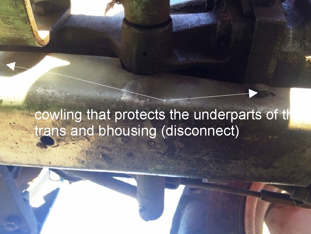

   / Yanmar 1500D hydraulic fluid leaking. #19
yup, tranny input shaft seal.. your input shaft is just a driveshaft like some old farmalls.
and yeah.. rear main is the rear main engine seal.
I'd still check that bellhousing drain..

Is that drain under that cowling under the tranny? I'll check that first. Thanks.
