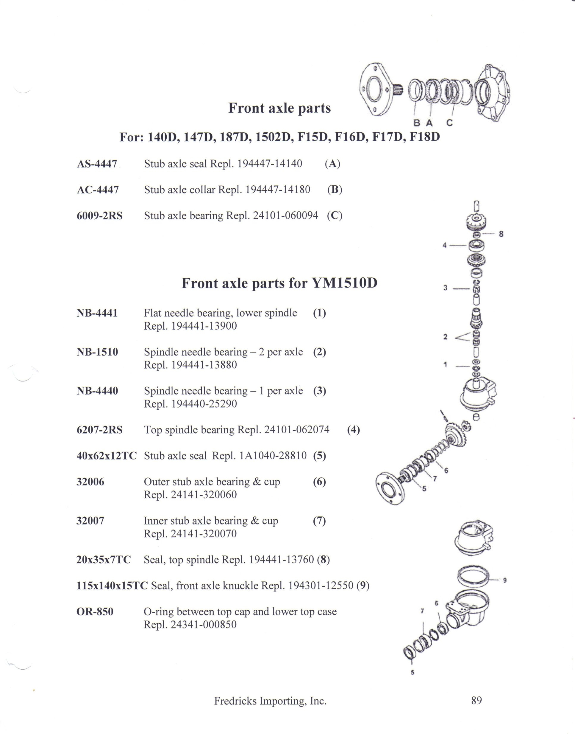

My Wheel fell off the front end of my 1510D, blew a bearing and put it back together with a new bearing and seal. It ended up falling off again because i did not have the spacers push the gear againt the pin between the bearing and gear. I cant find them anywhere. There are four small washers looking spacers. Does anyone know where to find them? or what they are technically called?
If you click the link I'm looking for parts 22,21, and 20.

Did you try calling them, their website may not be complete with the changes they are making. They are typically referred to as spacers or shims.

Part numbers 194301-12730, 194301-12740, 19301-12750, sizes 30 x 45 x 0.1mm, 0.3mm and 0.5mm. Appx .004", .012', and .020". There are a bunch of hits on google for that first part number and it wouldn't be be very hard to buy shim stock and cut your own. Bear in mind just because the parts list shows 1 of each the amount of each shim is dependent on proper backlash on gears.
   / Yanmar 1510D front axle parts #5
Any bearing supplier or place like Mcmaster Carr should have all of that.

The 1510-1510D is a model Fredricks show the parts for. 4 spacers that look to be shims? but no info. or #'s on them. Even have a special sec. on that model so I would ask them on the correct size shims.. Not much doubt they've done a few and Winston maybe correct ? but I would think 4 of the same org.?

Four of the same would be uncommon. The shims are there to get the bearing spacing exactly right as @winston1 explained above. Shims are often sold as a pack of varying thicknesses to enable the buyer to shim each item to the exact amount.
You might have a look on YouTube at some 4WD tractor front end rebuilds to get the general idea. IIRC, "Marty T" did one awhile back.

Just a further note: shims are used to get the exact thickness, trying to use as few as possible. There isn't usually a particular magic to two or three or four... it will depend on the wear and tolerances for your particular hub/gear and may differ left / right on the same tractor and of course between tractors. I.e. don't read too much into the fact that the figure shows four.
