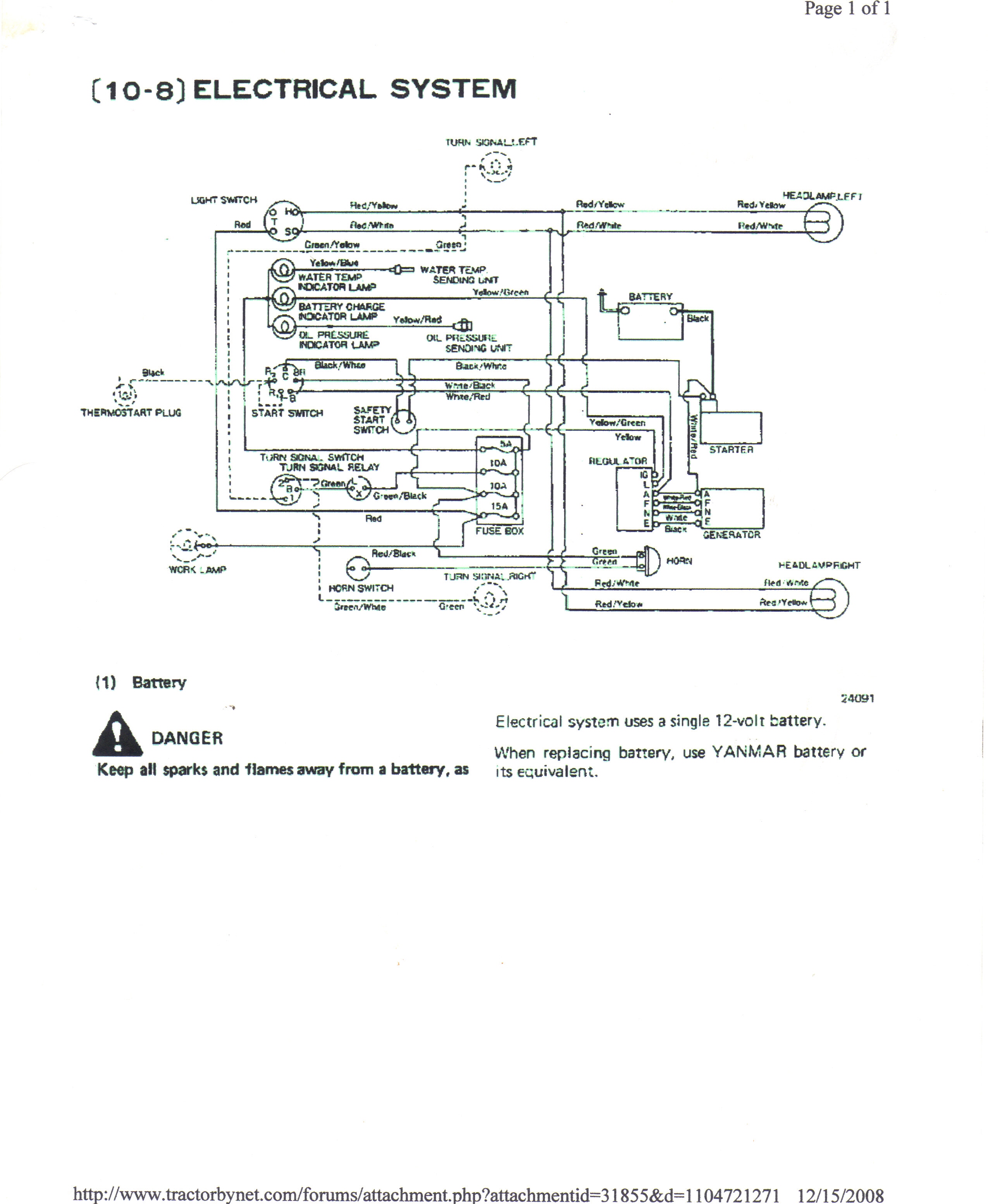

Got a problem: the two peces that hold the ignition switch in the dash stripped last night as I was turning the key while flushing the radiator. I think the tab wore down on the bottom one, causing the thread to develop play on the top nut. Anyway, that's not the issue -- I took the ignition out to look at it and in doing so I brushed it against the frame just perfectly to cause one of the wires to spark. Now the ignition is dead and there's no dash lights or anything when I turn the key. Obviously in retrospect I should have disconnected the battery before I did anything with live electrical stuff. Hopefully I remember that lesson for at least a week.
Anyone run into this before? I got my meter out and started to test connections but it was getting dark. Are those four silly "fuses" the only ones on the tractor? They are all connected -- barely, but connected. I should probably get a more sensitive meter as I couldn't find a current from the battery to anywhere under the dash but it was getting dark fast so I stopped trying. Wiring / electricity is NOT a strong area for me, to say the least. Any ideas?

This will give you a good Idea of the wiring. Make sure you use a good Meter. If it was mine would clean your Ground. Battery and the Frame and the Positive Battery and to the Starter and go from there. May have just burnt a fuse.

Thanks! I ordered the manual but it won't show up until tomorrow.
There was connectivity between each side of the 5A fuse (all four fuses had connectivity) so it doesn't look like that's the issue. But I'll start trying to isolate the problem when I get back this evening. I have a higher quality meter here at work that I can borrow.

That diagram should be pretty close except its for the larger Yanmars with an automotive-type alternator and regulator.
If you just have the little pancake 'dynamo' (belt driven) or the dynamo inside the water pump hub, the charging portion of your system will be simpler.

Those fuses are basically obsolete. Hoye is about the only place to find them. I swapped it out for a mode fuse block replacement. The one they show on their site but I sources all the things separate since I had most of what I needed except the screws and the block itself. Was a good bit cheaper the do it your self routine .
