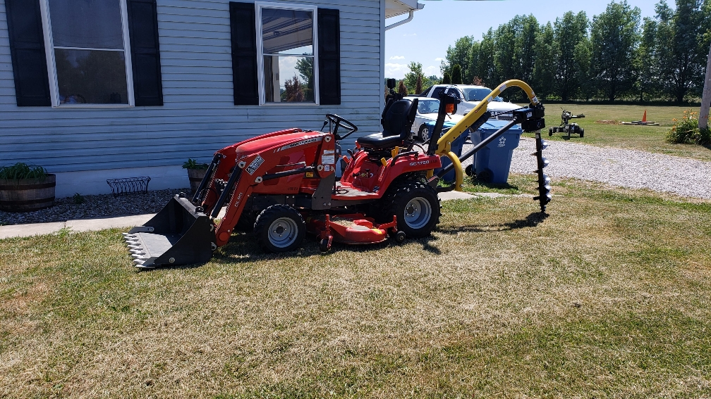

Hello all, I just purchased a Yanmar 155d with a loader and a brush hog in good condition about a year ago! Paid $3750 for it, in case anyone might be wondering, and honestly feel like that was a very fair price. It's been running great (save for a blown hydraulic hose on the bucket, but that was easy enough to replace) and clearing out lots of brush, moving some small piles of dirt, and getting little projects on our 5 acres done.
I recently purchased a 3 point auger and blade attachment for the tractor off of craigslist, and for the first time I realized my Yanmar 155d doesn't have any downward hydraulics for the PTO. With the brush hog that was never an issue, as the weight is far enough out that it gravity drops just fine, but this makes the auger sometimes struggle to bite in hard clay soil. I looked through the manual, but nothing was definitive. I'm guessing this is just how this tractor was made, (I know many are gravity only) but wanted to make sure that this is the case. If it should have down hydraulics for the PTO, I want to dive in and get them working!
Thanks all, I've gleaned a lot from this forum already.

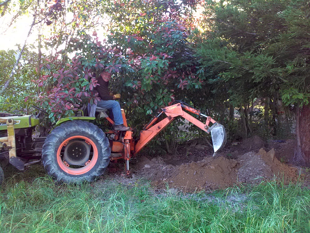

I was just dealing with this today with my 3-point backhoe. Trying to stick the teeth straight down into hard soil just raised the entire hoe. Frustrating. A chassis-mounted hoe would be better, to use the wieght of the tractor for downforce.

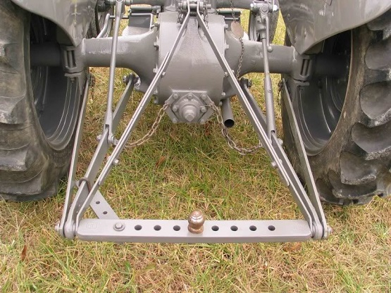

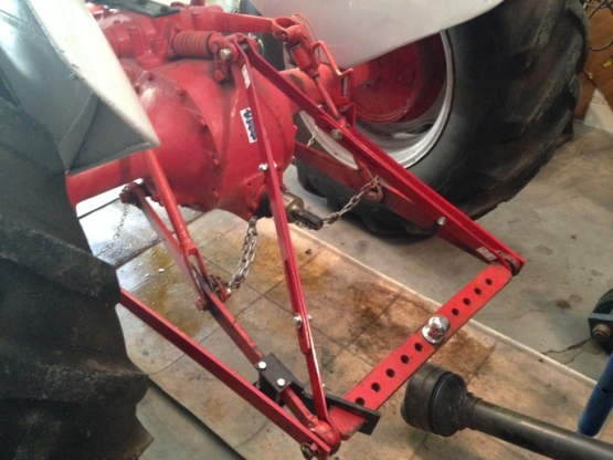

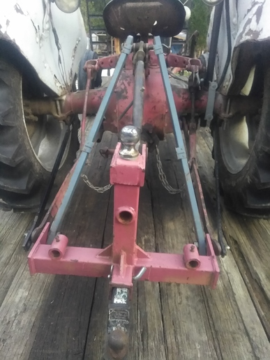

You can add some "stay straps" or "stay bars" to keep the lift arms from raising up:

I've though about making restrainer bars like that. But this hoe is close-coupled and things are already busy under there.
Hooking up, after losing the ability to raise the 3-point to match the parked hoe height, would be difficult.
(First photo was to show using the hoe to pop out new oaks, that are too close to orchard trees for discing to hit).

The YM155(D) is a true SCUT. With this said, a normal 3PT auger PHD sized attachment will fail to work properly with your machine.
The YM155(D) machine needs a true SCUT 3PT auger PHD to properly work well for your machine. Recently, we learned this with a member having a Yanmar SA424 SCUT tractor.
What is the auger diameter are you using? 6, 9 or 12 inch. Size matters too.
The SCUT County Line PHD from Tractor Supply (602377) works super for your sized machine.
The LS PHD 100 is another good auger for SCUT machines.
The WorkSaver 300 is another.
Frontier Equipment PHD 100 made by Rotomec is another to look at.
