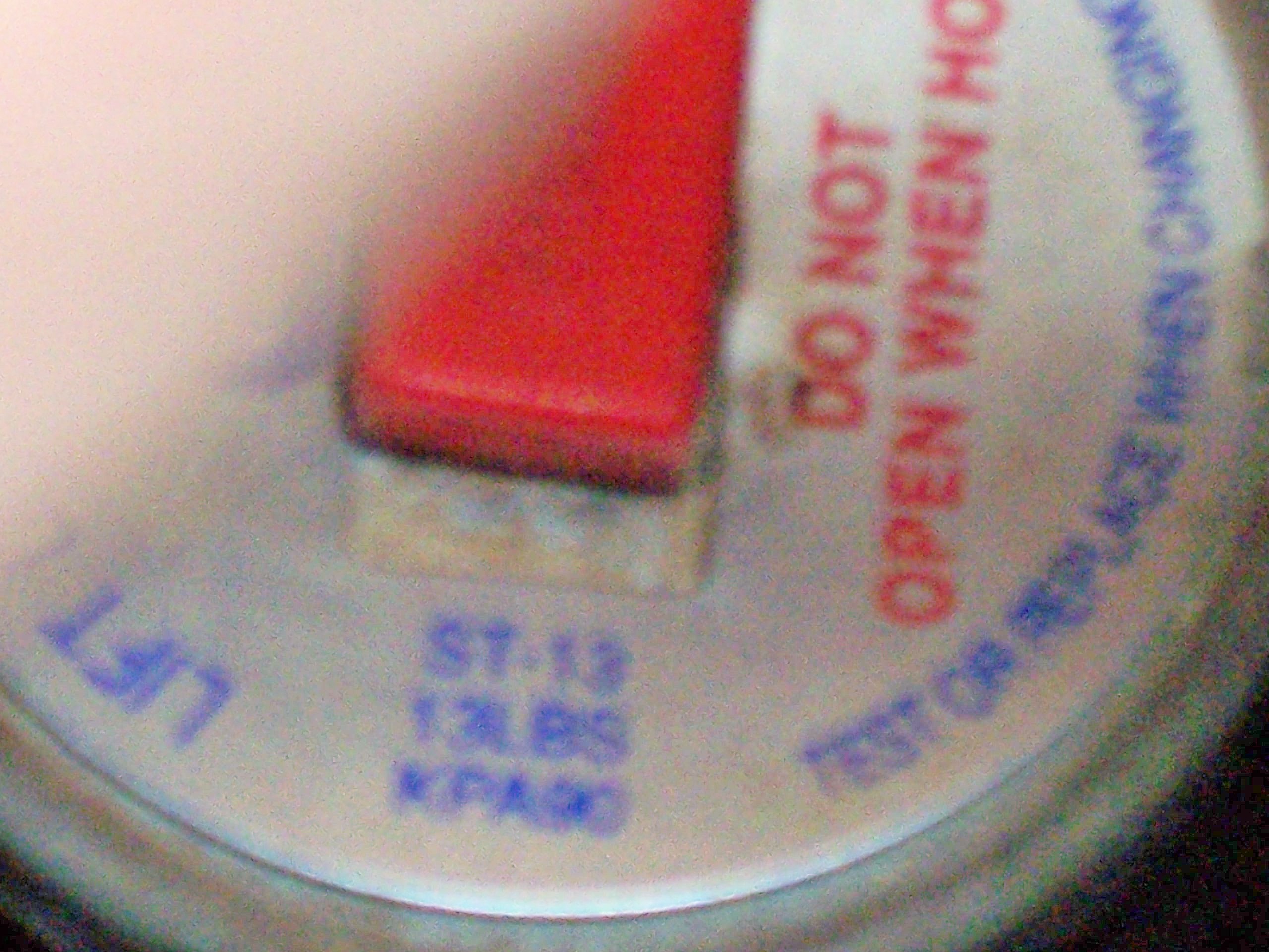

Off the subject Aaron, but what is the PSI of your RC-28 radiator cap?
7psi... I think. I just looked and they are not marked but 7psi sticks in my mind for some reason. I will research more though & see what I can find.

Here was a partial conversation with Winston on SSB forum. He thinks it is 12-13#. I would hate to put my system under 12-13# pressure after 36 years at 7# which I am pretty sure it had..
"You could be right Winston, however I just replaced my original 7# cap, (all printing in Japanese except for a clearly legible Arabic 7), with Hoye's RC-28 cap. a Stant 10228 cap is 7#. Hoye generally uses a partial mfg. part # to ID their aftermarket parts. 7# and 12# caps have been a matter of discussion for years. I suspect Aaron can answer the question.

Just happen to be out back and 13 lbs. is what mine says.

Here was my partial statement on SSB:
"Page 54 in the 135/155 repair manual states radiator is pressurized at 12.8 psi.
Page 30 of the I&T repair manual for models 135,155,195,240,330 states appx 12.8 psi and is maintained by the radiator cap.
Repair manual for 220/226 states on page 220-05-3 "when cooling system pressure exceeds 13
psi a valve in the radiator cap opens to allow steam to discharge into the expansion tank, where it is condensed."
You will note Hoye sells the same cap for each of the above listed models."

How many of those manuals were actually written by Yanmar. Don't know if my YM240, YM195 Yanmar manual even says. It's 750 miles away.
   / Yanmar 1700 Loader quetion #19
Carey is yours an origainal cap?
I dont think service manuals even written by after market companies will give specs that are 40+% over what the factory reccomends.
   / Yanmar 1700 Loader quetion #20
I thought of that also and believe it is the Org. cap. Everything else is on it and being a Mid to Late 70's Era Tractor the Rating of 13 Lbs. and not PSI makes me tend to think it is.
