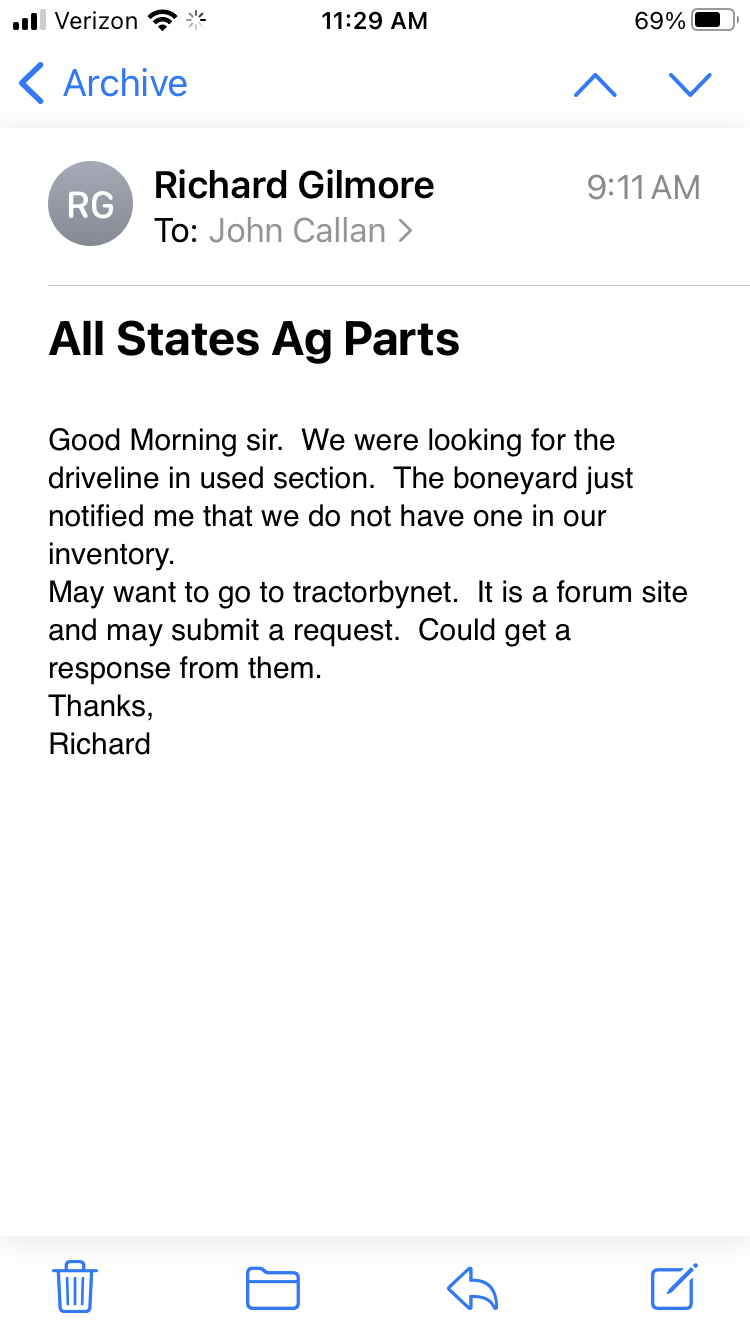

   / Yanmar 1820D front driveline and sheild
Tried Hoye they referred me to this forum
Hoye responded
   / Yanmar 1820D front driveline and sheild #7
Hmm were you requesting a used driveshaft? Perhaps I was mistaken but I looked your shaft up on their website. Maybe the shield is no longer available? What happened to the original driveshaft?
Bought tractor from a guy who bought it from a guy and only used 2wd
   / Yanmar 1820D front driveline and sheild #9
Hoye shows a driveshaft with ujoint end but no splined end for around 200. You could measure the distance from transfer case to differential & if the length is shorter, buy the hoye shaft, take it to a machine shop with the tractor & have them cut and spline/yoke it for you depending on the connection needed. You'll still need shield & ujoint/ fasteners/seals, but the drive shaft should be done. Would need to make sure the xfer case isn't trash ... why would someone pull the shaft from a working xfer case even if they don't use 4wd?
