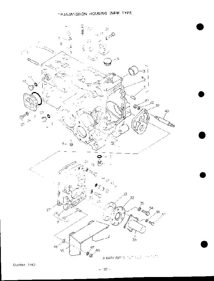

Here is the schematic for the transmission housing. Refer no 32 is the oil seal retainer 194300-24880.
Jeff

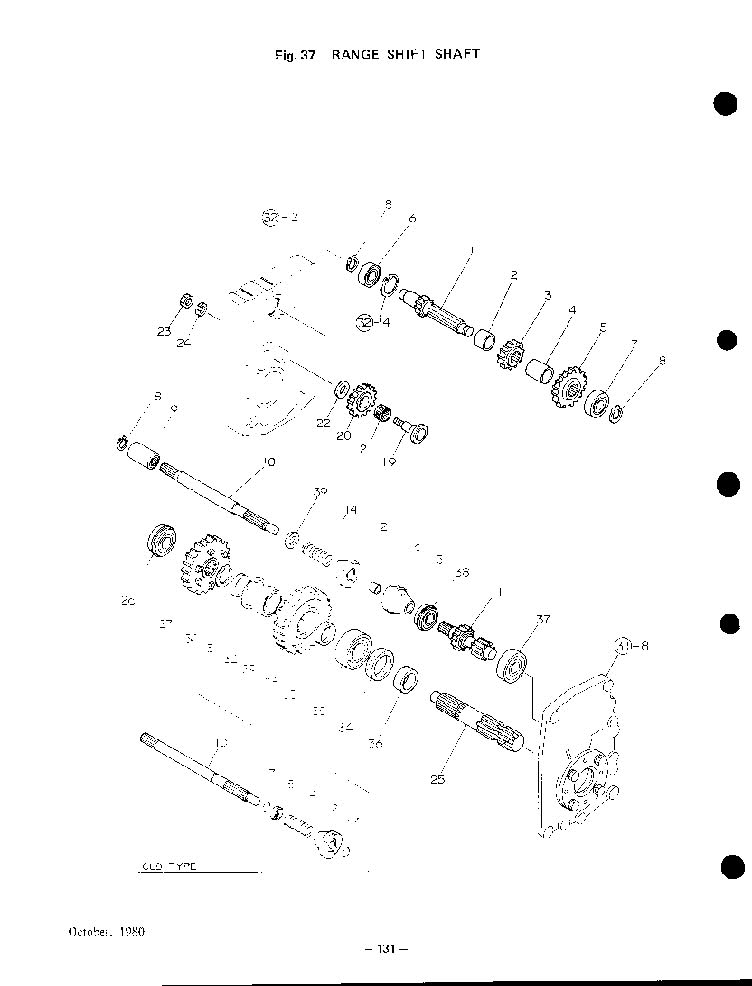

Well, that scan was not as clear as I had hoped it would be. Maybe it will be sufficient to give you an idea of the design. Here is the schematic for the range shift shaft. Refer no 34 is the PTO oil seal, TC 38 55 8 194990-52600
Jeff
