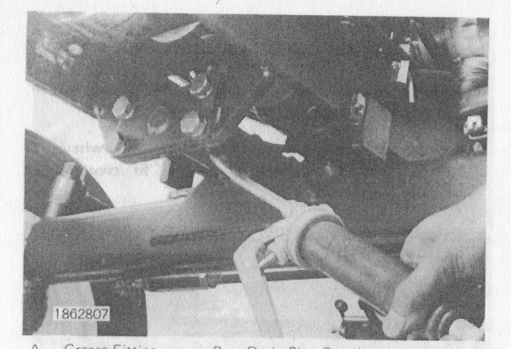

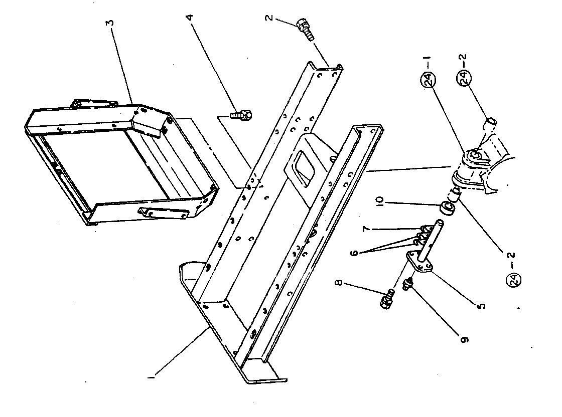

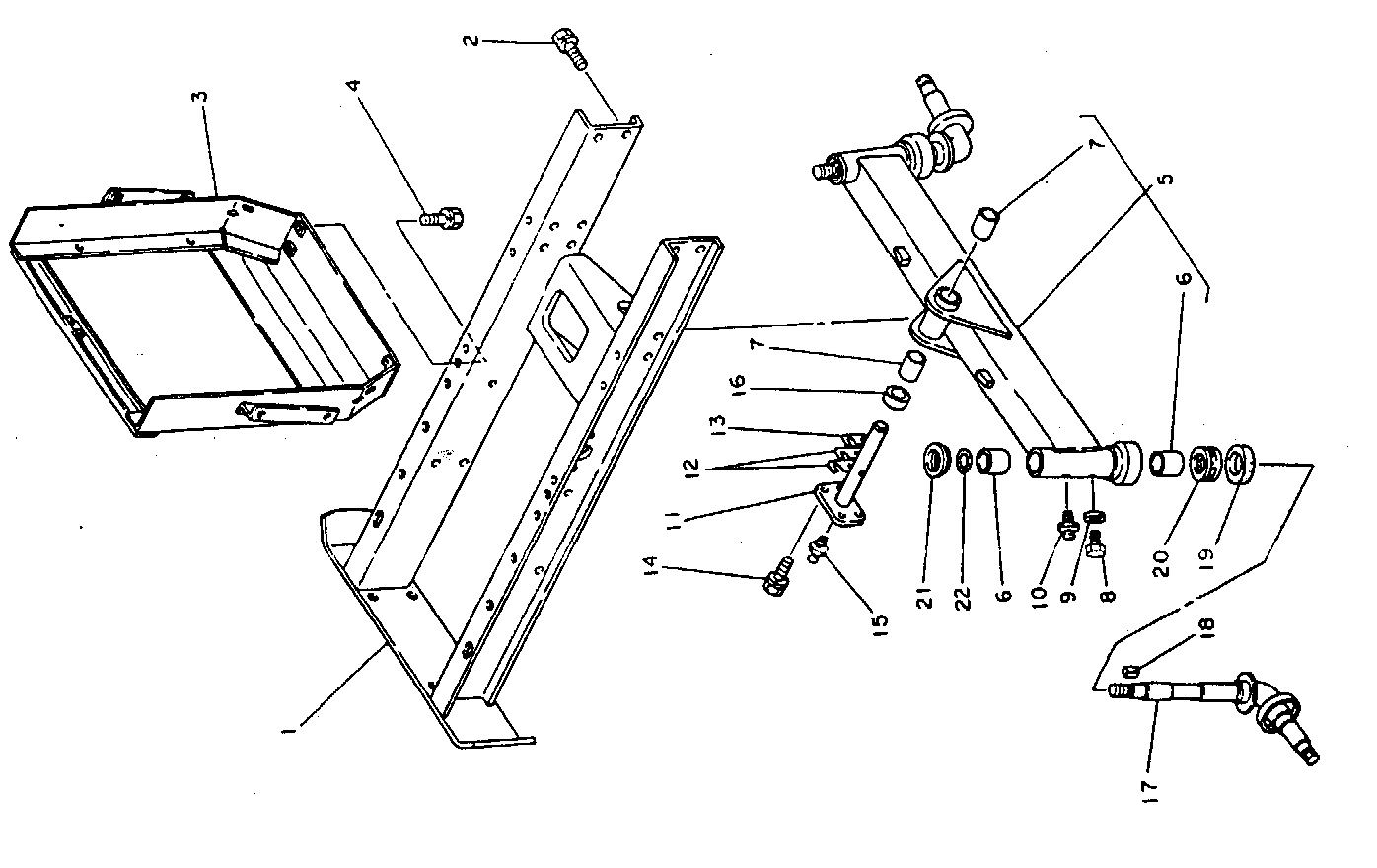

   / yanmar 186d new purchase #23
On a 186 (2 wd) there is a grease fitting on the side of the pin bushings in the axle. The 186D does not seem to have a grease fitting that I can find, but the 1510, 1510D has a grease fitting in the end of the center pivot pin. Another difference between the 186 and 1510?:D
Mike

   / yanmar 186d new purchase #24
186D has a bushing with o-rings . Pin and bushing are splash lubricated from the differential. Works great , no grease needed.

   / yanmar 186d new purchase #26
Buppie is correct. I had the same question on my YM186D.
It is splash lubricated from the front diff.
#27
Yep......no fittings on the 186D....4 wheel drive. I have the service and parts manuals......No fittings on the 4 wheel drive model. :):)
