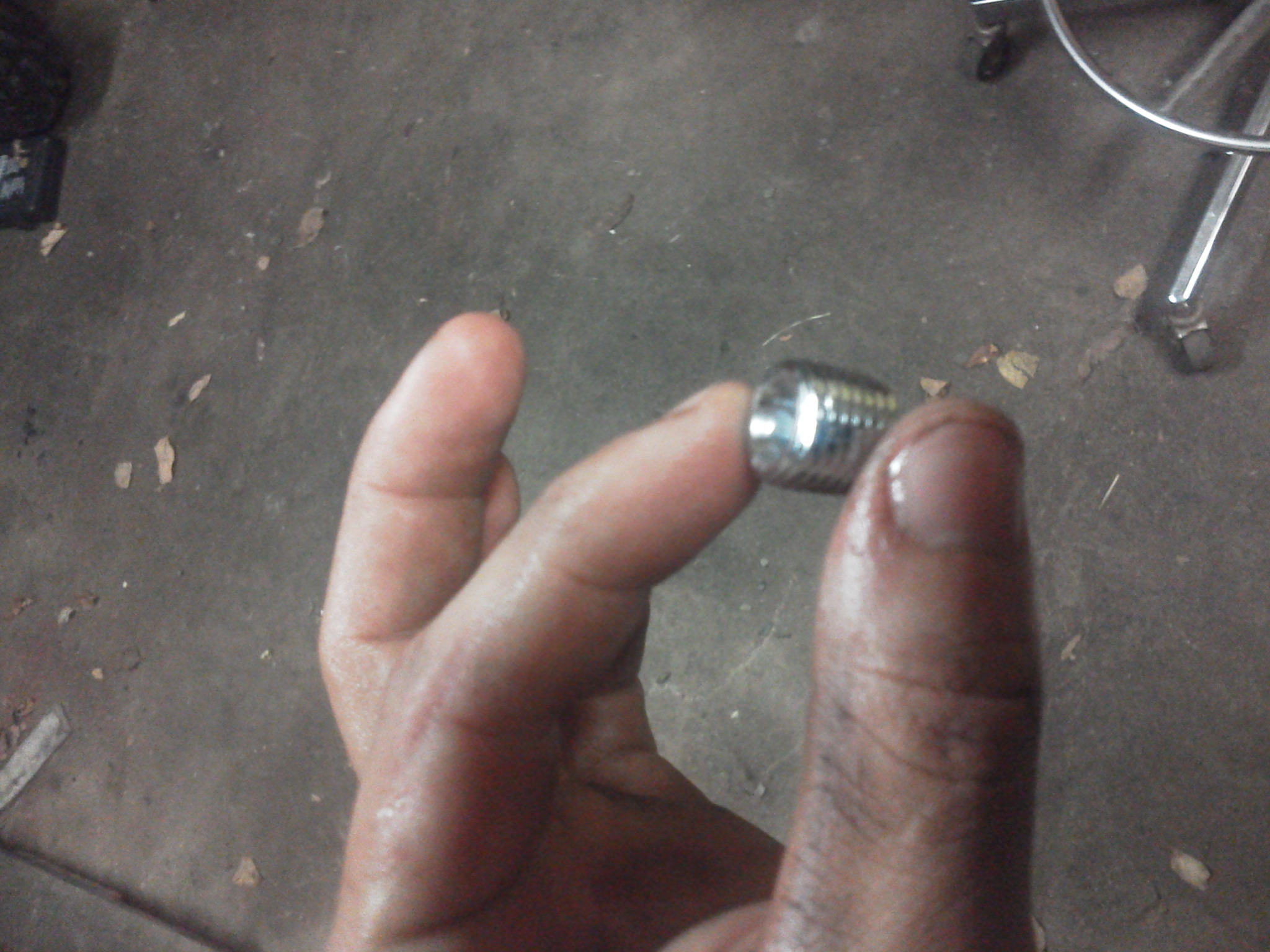

Well guys..... it turns out all i needed was this little plug all along! Went to several stores with no luck until i went to Auto Zone and they had a fancy chrome one in the right size! Installed the plug and sure enough that was the issue! You guys have no idea how much i appreciate all of your help, i really enjoy this tractor and now that the FEL FINALLY is working the way it should it is just that much better. Im also very happy the problem was solved before another cracked valve or who knows. I know the previous owner had a fair amount of hydraulic related problems and MANY blown hydraulic hoses. I guess we will never really know how that plug got removed in the first place but its there now and i aint taken it out! I had help on My Tractor Forum but it was pretty much everyone telling me to cut the steel lines and all kinds of things i didn't want to do. Thanks again guys!

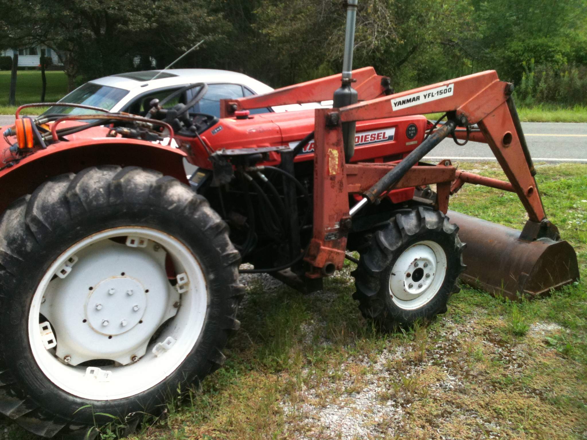

Bulldog,could you post a pic of your ldr valve ? Its a joystick,just looking at how its mounted,i have a 336d w yanmar factory joystick but the mount has been repaired by someone and I dont have room on the r\s to get on\off the tractor,would like to see the correct way to mount that valve

Well to be completely honest im in the same situation as you, someone re-welded the mount closer to the seat and i cannot get on from my right side either. I posted a picture below of a 336D i found online and believe this is the correct mount.
Back in post # 2, I mentioned a PB adapter.
In post #11, you labeled a PB adapter, and in post # 25, you show a hex screw.
Is that fitting labeled PB adapter in post #11 just a fitting, and not a PB adapter?
You normally only have one hex screw or a PB sleeve, but not both.
   / Yanmar 336D FEL only works when 3 point is raised to max and straining the engine!?
#29
The hex screw goes into the remote hydraulic or divider block i believe its called, not the loader control valve. I re-posted it in the Yanmar section and someone sent me a link to a thread where someone had a diagram showing it.
http://www.tractorbynet.com/forums/yanmar/198853-remote-hydraulics-yanmar-336-a.html
Basically installing the hex screw controls the flow of the hydraulic fluid to run through the spool valve like it should and then down stream to the 3 point. The way it was without it the hydro fluid was just bypassing the loader control.
   / Yanmar 336D FEL only works when 3 point is raised to max and straining the engine!? #30
Now, I understand.
That little hex plug is not a PB adapter, but a hex plug to re-route the fluid for the loader.
