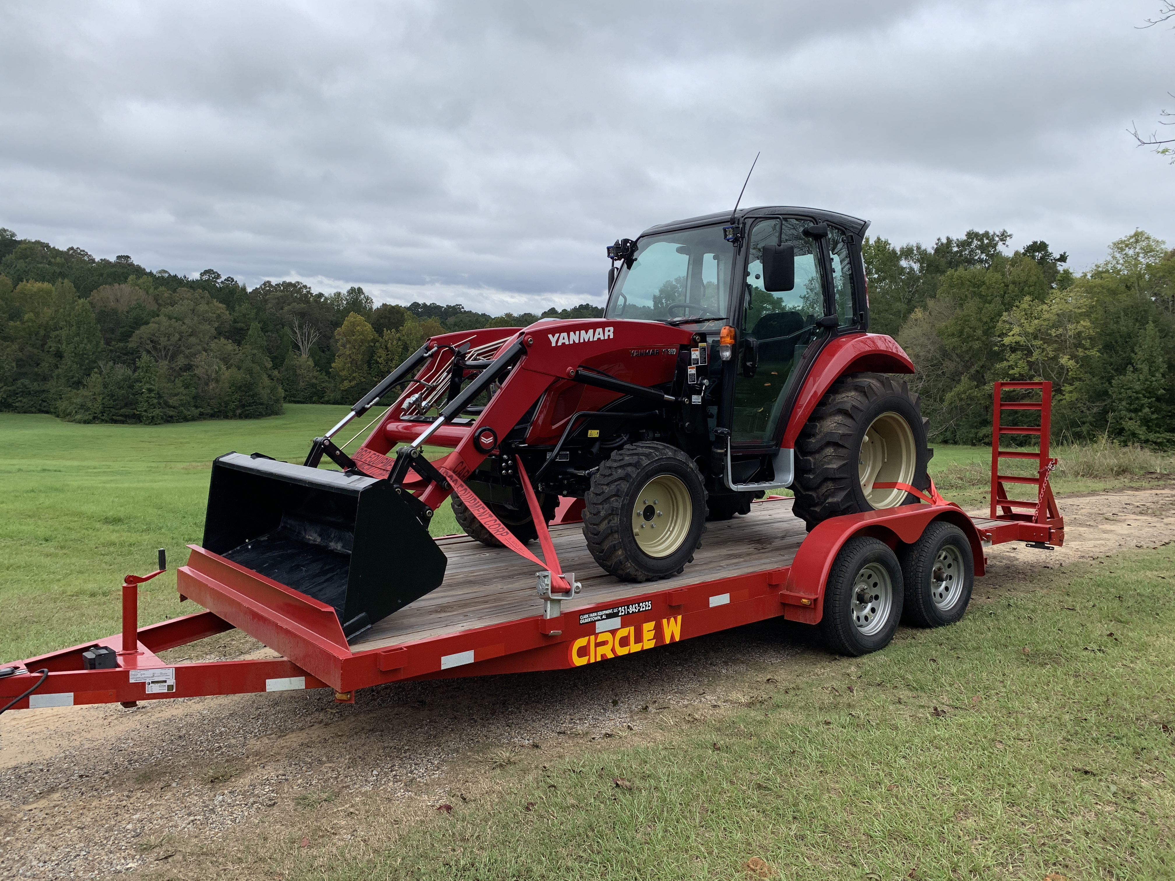

I pulled it off and got a YT 359c

Very nice! I am very happy with mine. Looks like you got it with hydraulic hook ups up front. Be ware, those are a special size you can only get from Yanmar. And the plate that holds them won't hold a standard female receiver without drilling it out a little. I just bought the male parts from Yanmar as I only have one attachment I run up front that needs it

You have a sharp eye
I had to swap out the ends on a grapple I got later

The fittings are H3-63 from Parker or other companies, Grainger has them part # 31A-889
