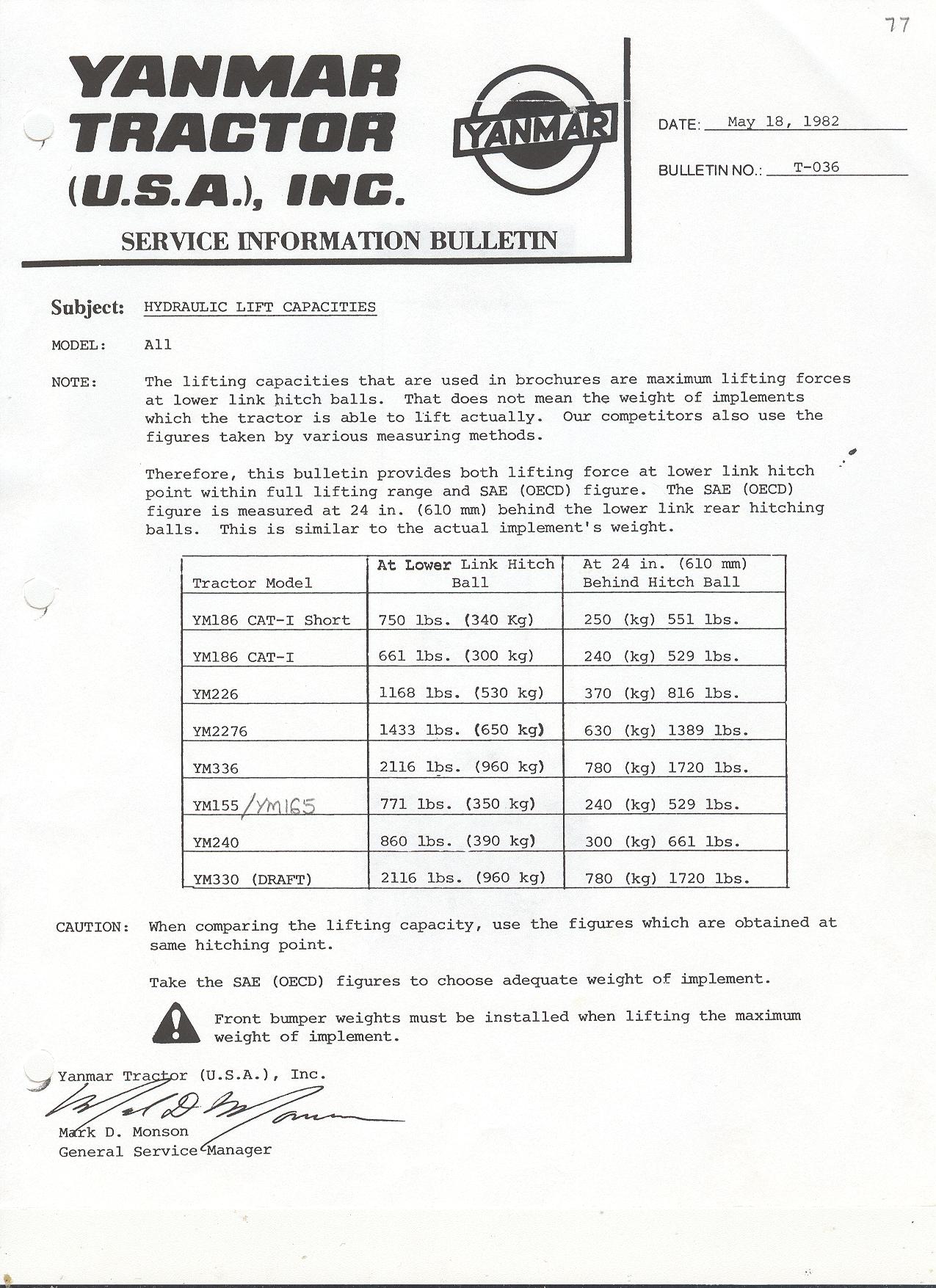

I ran across this page this morning and thought I'd post it.
Some history: Back in the 1970s, the various compact tractor companies were vigorously competing on specsmanship, and one way they did that was by advertising FEL and 3pt lifting specs - but conveniently without mentioning just where these were measured. i.e. not actually lying about it, just helping customers form their own false conclusions....
Yanmar was a guilty as the rest. But dealers and their mechanics needed to also know the correct numbers. So Yanmar provided this sheet to its dealers, and also at about that time they were one of the first to change their advertising to include information presented in this more usable format.

rScotty thank you!
I had only seen the advertised lift numbers (at end of 3-point arms) and wondered why the YM240 struggled to lift the Yanmar backhoe that had been an option for it back in the day. Now I see YM240's 24 inches out rating is only 661 lbs. That chart explains a lot.
I read somewhere this backhoe is 750 lbs, and that's what its previous owner told me, also. No wonder the tractor's relief squeals if I drive over a bump.

My YM186D is rated same lift capacity as YM165 per that chart above. But it can't lift that hoe. It strains and squeals, even if I lift the hoe with its own hydraulics then raise them to shift all the load onto the tractor's 3-point.
Any advice on what I need to do, and how you accomplished using that hoe on your YM165? The only thing that has occurred to me is to remove the safety restrainer under the arms temporarily and test again. As I recall I loosened the restrainer bolts when I tried lifting it but that didn't help.
If I could carry that hoe with the YM186D, I could slim down to just that one tractor.

Hmm.... Yes, our YM165D had no problem lifting the YBH600 hoe. I don't even recall it being borderline. It just lifted it with ease. I'd had that YM165D since new, and it had the best of care so the hydraulics were 100%. And its loader ran off an accessory hyd. pump so that small loss wasn't there. Another plus was the FEL weight probably helped balance the weight of the hoe.
But we didn't use that hoe very often on the YM165D, That tractor - even with the front loader - just isn't heavy enough. Anytime we were digging and hit a tough spot the hoe would just throw the tractor around. So the YM165D had no trouble lifting the hoe, or powering it, or withstanding the hoe stresses....but that tractor+loader just wasn't heavy enough to work the hoe. It was like trying to go for a pleasure ride on a horse that likes to buck.
So we put the YBH600 hoe on our farm tractor, a JD530 that weighs about 5 times as much and has a category 2 hitch. That made a much better backhoe out of it, but it would still bounce the big farm tractor around a surprising amount. When we got the new Kubota TLB, I gave the YBH600 hoe to a friend to uses it on his MF35 farm tractor.
Looking back at the spec sheet, the YM165 is penciled in by me. That's probably because when the YM165D first came out, the dealer and I went over it in detail trying to find any parts he needed to stock that were different from the YM155D. We wondered what made the red tractors 165s instead of a green 155 if everything mechanical was all the same? We couldn't get an answer to that question from Yanmar.
Ultimately we couldn't find anything except I think an injector part number and of course the YM165 used the improved camshaft from the later model YM155s. So we finally concluded that the combination of injector and cam gave one extra HP (16 hp vs 15). And we figured that all the other specs were the same too.....
We could have been wrong. Maybe the lift specs 155 to 165 really are different. After all, the YN186 and the YM187 have very different 3pt specs. The YM187 lifts over 1000 lbs at the hitch points.

Dang. Now I need to go look for a YM187. :) Or maybe put on YM165 3-point hydraulics and lifting components.
Hmm - I wonder if putting shorter arms on the YM186D would improve its lift capacity enough.

Yes, if nothing else changes, shorter arms should improve the lift ability. You can compare the specs at the hitch ends vs 24" behind the hitch ends to get an idea of what you would gain by shorter arms. It would be an interesting experiment.
