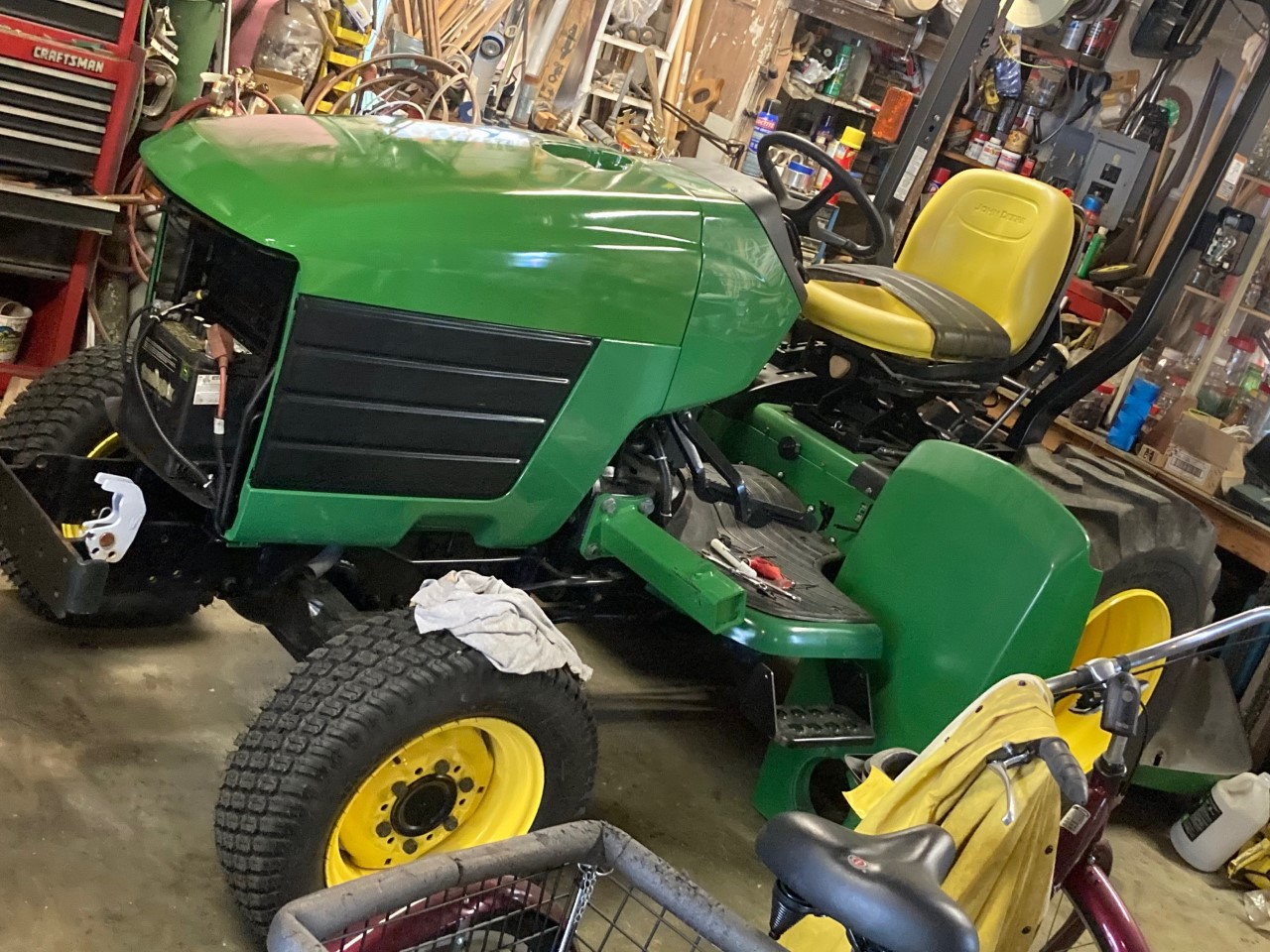

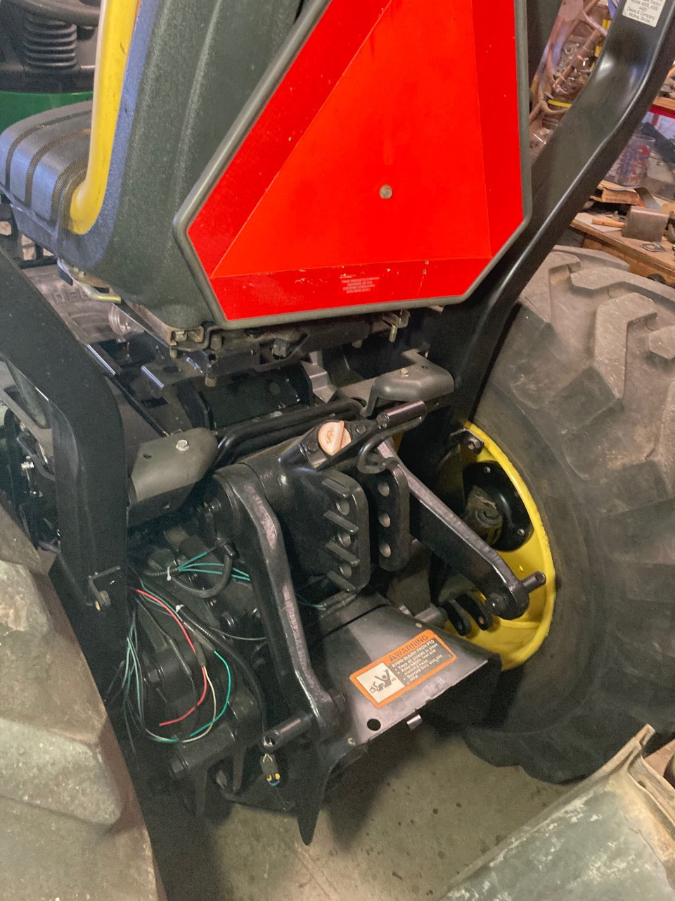

Thought I would undate you all on where I am at with the restoration. Haven't done much in a month but here is where she is at.
Have been out driving it around. Hooked up the loader and it works fine.
Needs the grille fitted the rear fenders repaired/cleaned up and installed, the seat cover glued back onto the base and the already painted extendable 3 point arms attached. Oh and finish the taillights(attaching lenses.
I don' t think I mentioned that I have the original Fiberglass hood for the tractor. YES Fiberglass!! Sitting on the tractor in the pictures.
It is pretty much done and feels great and nice and tight.
Regards all, Gary

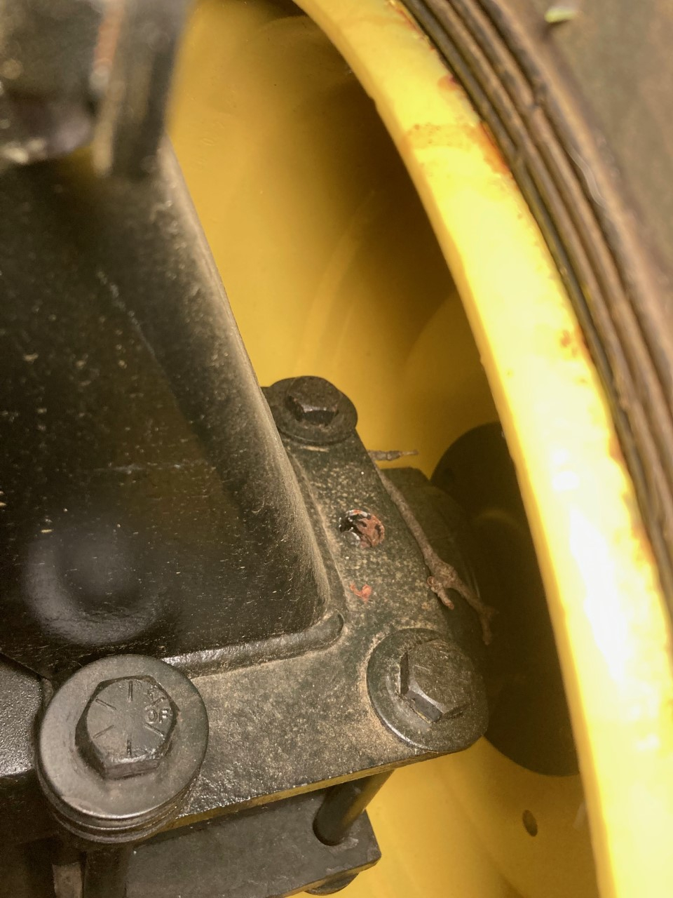

Gary,
Did the ROPS come with the machine?
Could you take a few pix of the ROPS and also where it mounts on each side. :)
   / Yanmar 3TNE88 diesel Water Cooled Engine Oil question
#13
Hello
with the tires on it is hard to get a good picture of the rops mounts.
the tractor mfg june 28, 1998. The rps came off of q 200 year 4200
tractor.
The rops angles backwards from the tractor. on mine there is a hole im the middle outside of the bottom plate of the actual rops. that should match up to a tit on the top side of the axle housing on each side.
I sort of have a picture of that...tight quarters and a twig in the way.
the torque is 170 ft pounds as I recall on the rops bolts.
Hope this helps, Gary
