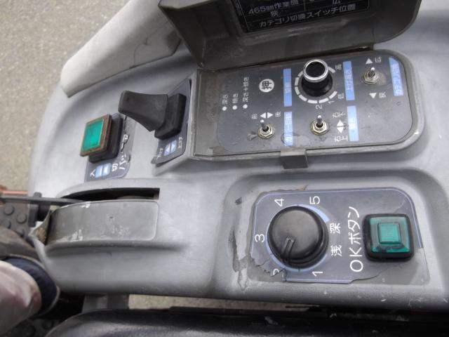

Hello
My name is Filipe Silva, I'm From Portugal and is my first time here.
I just bougth one Yanmar AF 17 Tractor. I can't find the manual and i have some functionalities in the Tiller controls i don't understand.
Looking this picture can some one helo me about the meaning of each switch?
Someone have this tractor or have the manual?
Thanks for your help
Thanks
Filipe Silva

Am I the only one that watches a Spanish channel on TV and try's to figure out what they're saying? I feel that way when I look at that control panel. :confused2:

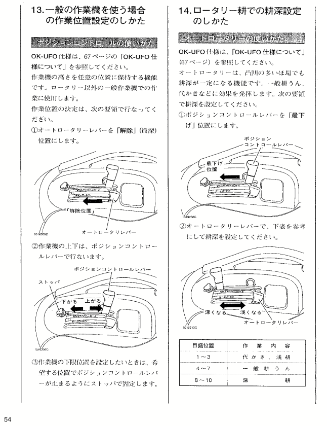

The manual is on the YTOG. Too big to attach here.
YANMAR AF15 AF16 AF17 AF18 OPERATIONS MANUAL 1W3008-11992A 059510-0163S.pdf
There are 4-pages like this. And can be translated via Google, Yandex or DeepL.

Once you have the PDF and need assistance for translating it, I can show you some tricks. The newer manuals are better to translate like this AF series. The YM series are harder due to those being scanned copies of a copy.
