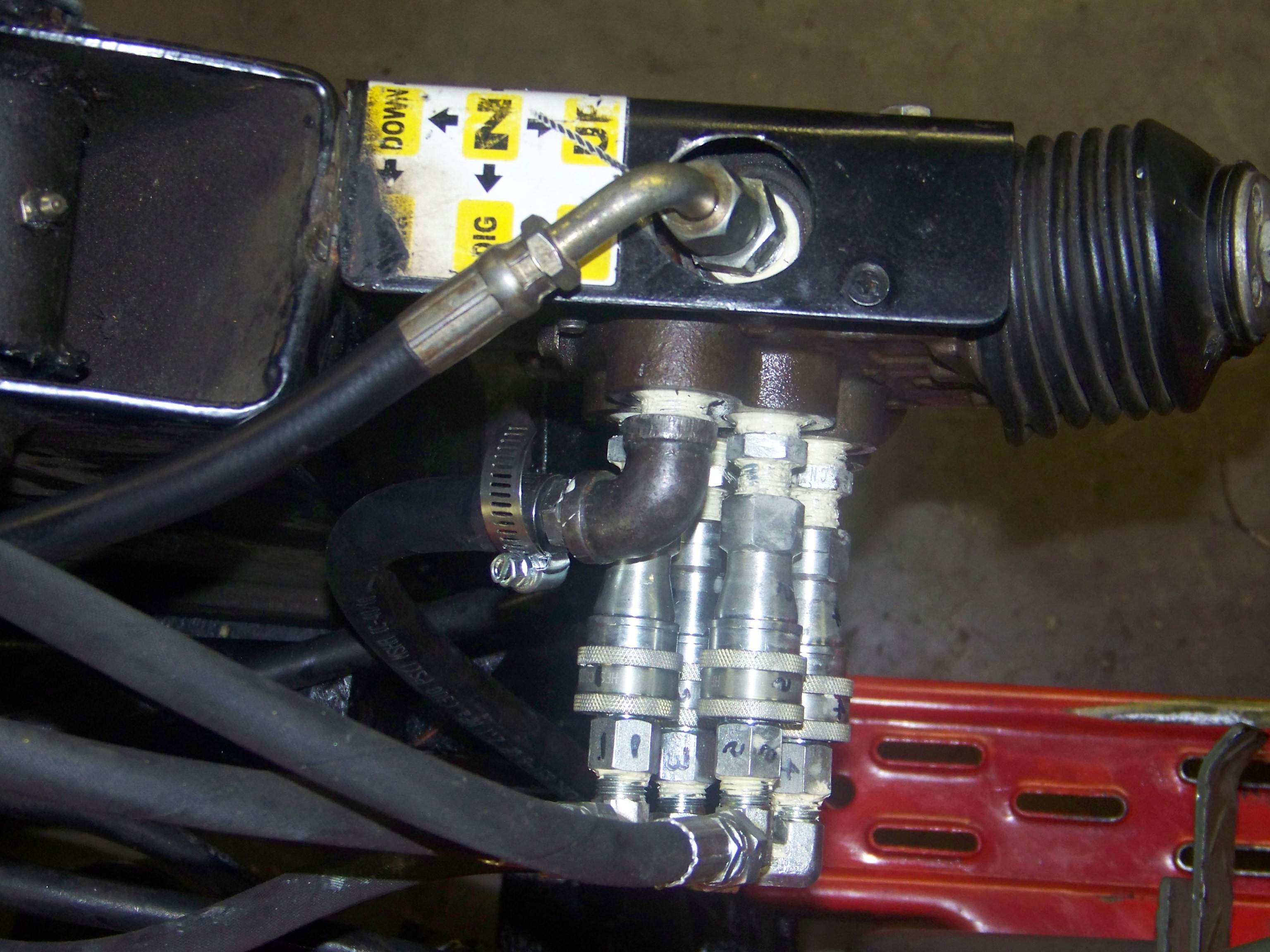

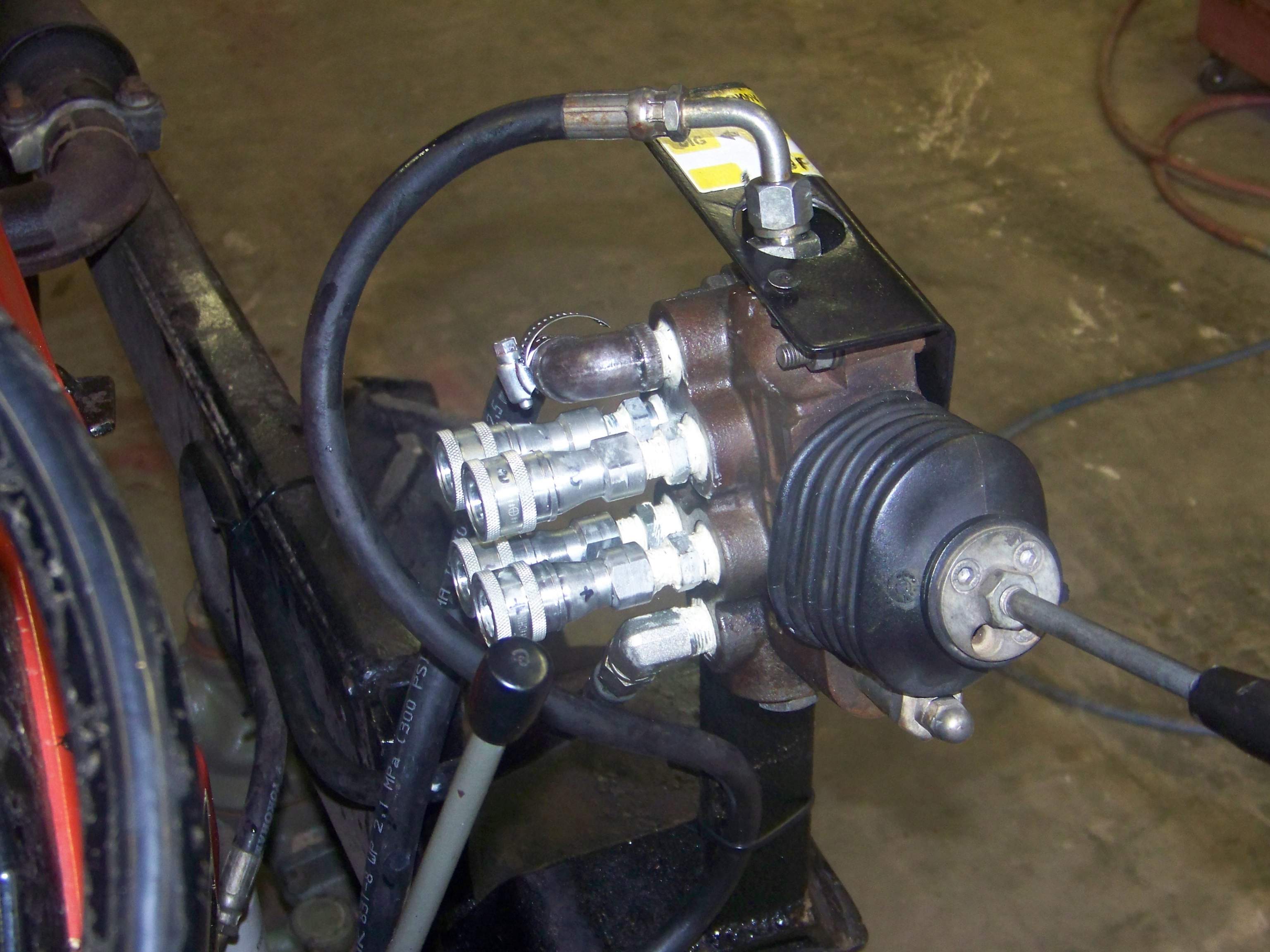

No idea how your loader is plumbed. On my 2002d I mounted the loader valve on the tractor, added quick disconnects so when I remove the loader the valve is still there for use. First picture shows the loader removed from tractor, second picture shows loader plugged into valve.
