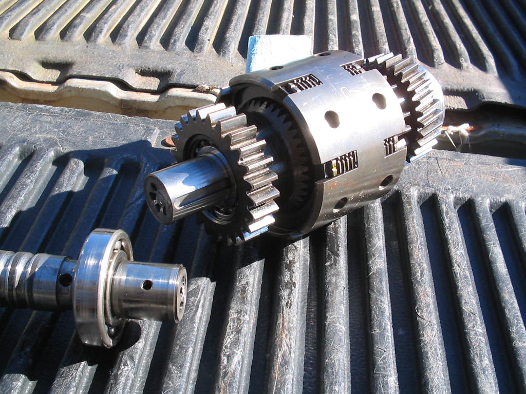

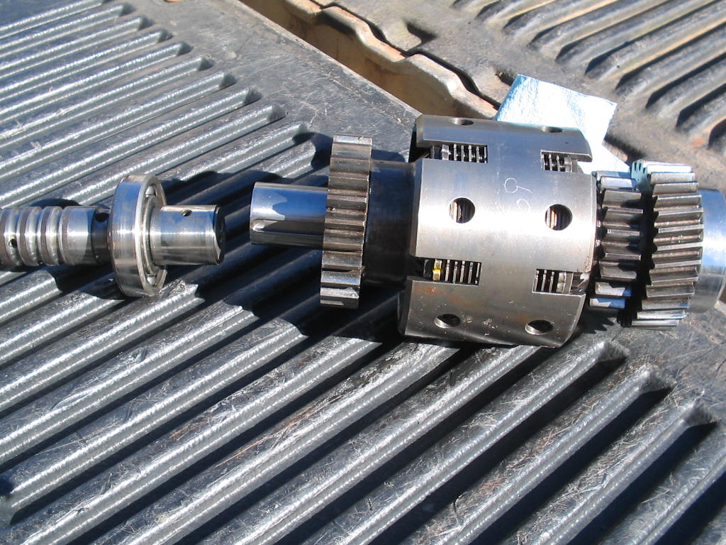

Guys, I need help! Attached are pics of a broken rear shaft off a Yanmar Fx 26d. I took it to a machine shop, they said it couldn't be fixed.(I failed to ask them if they could just build one. I'll do that tomorrow.) But , in the mean time, if anyone has suggestions I would more than appreciate the help. I'm waiting on one more call but it is doubtful. There is one company that has this used part, but it will cost $1850. I told our customer that I would try one last place and that is here. HELP!

Wow, that is pretty much the whole power shift unit. Believing the two shaft pieces are suppose to be one it is mysterious just how they went together there? Just my curiosity. Any hint on what caused it to break? :confused3:
Are they charging 1850 just for the shaft or for the whole assembly? Either way, I think a used shaft or assembly is going to be your only hope. That is a complicated piece of machine work. Without a print I am doubtful anyone would undertake machining one. Also wonder if there is heat treating on any of it? Very possible this gentleman Sheaffer's Town & Country Tractor could get the shaft but I would expect the price to be high. If your not in a big hurry you might get with him. Seems sometimes it takes a good while just to get a quote response from Japan.

Could Abuse be the problem of the break? That's what I'm trying to figure out. Whats your opinion?
   / Yanmar fx 26 transmission shaft broke and a replacement will cost $1850 #6
Well. I don't know about abuse... looking where it broke, (in the pic) it doesn't appear to be much metal in the area of the break. I would have though that the shaft would have been solid in that area. If not solid, at least more metal than what it has. I would imagine ,there are a lot of forces applied to that small area at times... Looks like a weak design to me. Other opinions will probably vary
   / Yanmar fx 26 transmission shaft broke and a replacement will cost $1850 #7
Do you operate the pto with an over run clutch? If not, I believe that could be a partial cause, especially if you shift the powershift without clutching and at high rpm. Part of this comes from an experienced tractor Ernie and part from a smigin of operating and experimenting with an FX24D that had a sheared ring gear bolts.

Winston, Is it just me or do you think the shaft should have been a little more robust in that area. Look at the small amount of area that broke off.

If you have tried the usual suspects, WKYT, and Southern Global, to no avail, I am guessing your customer now has a parts tractor. That does look like a weak point, but I suspect it took some serious abuse to break it.
It does look a little weak there. Maybe the pictures are decieving?
