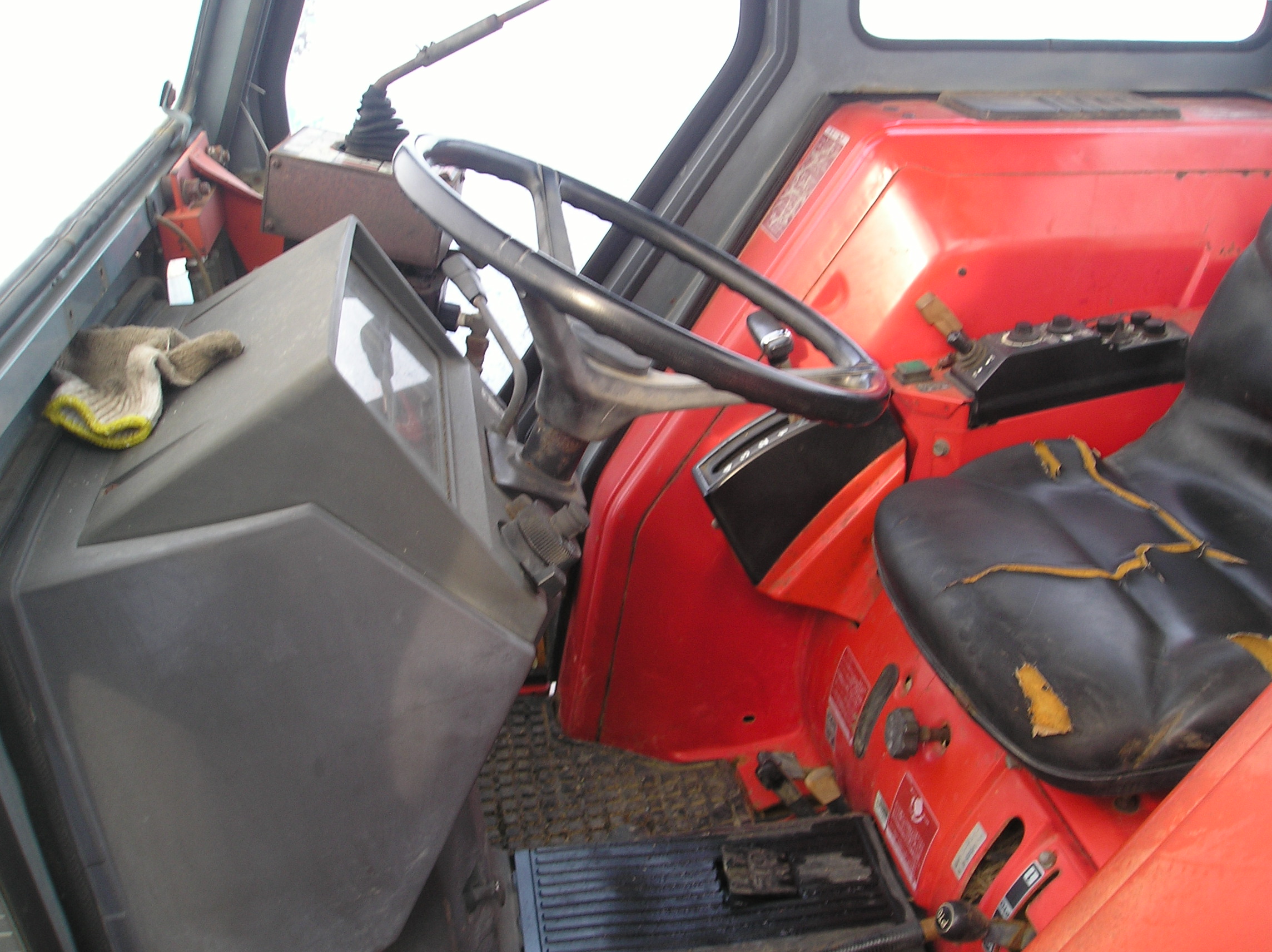

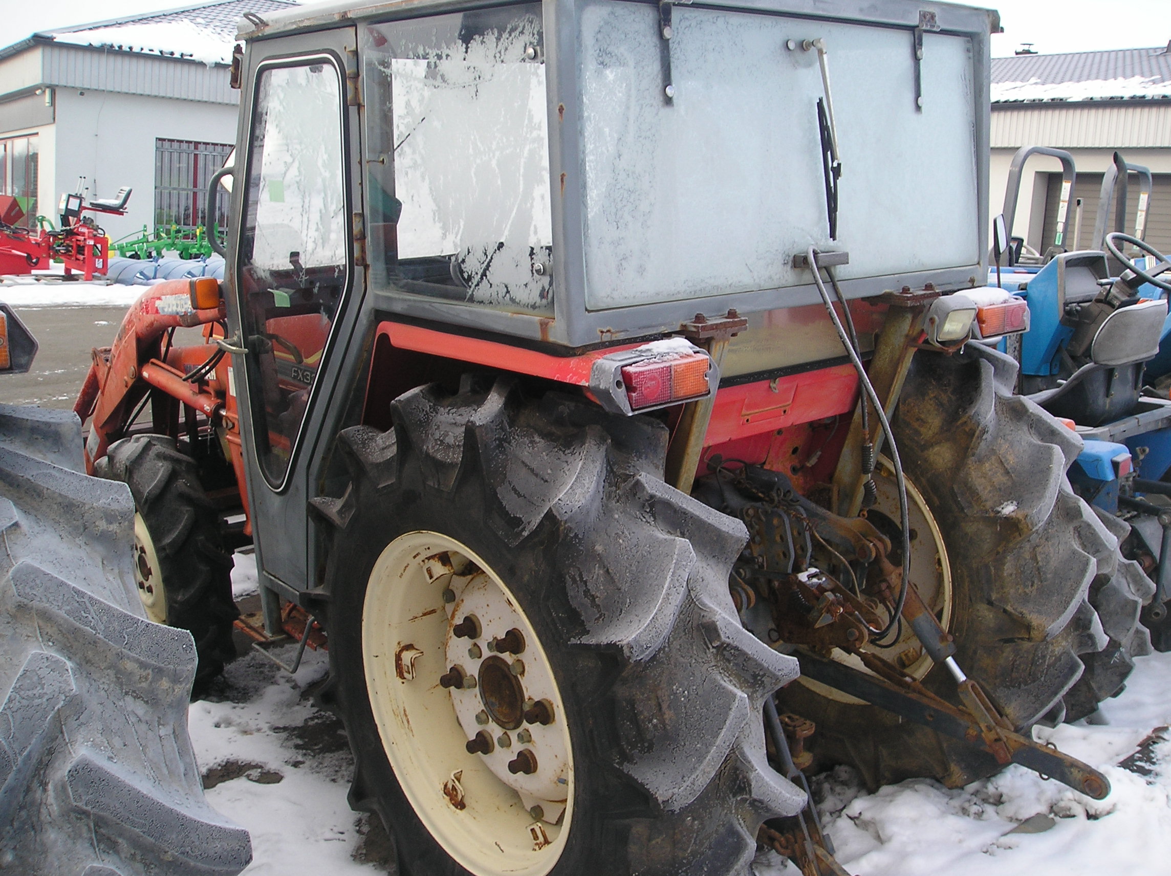

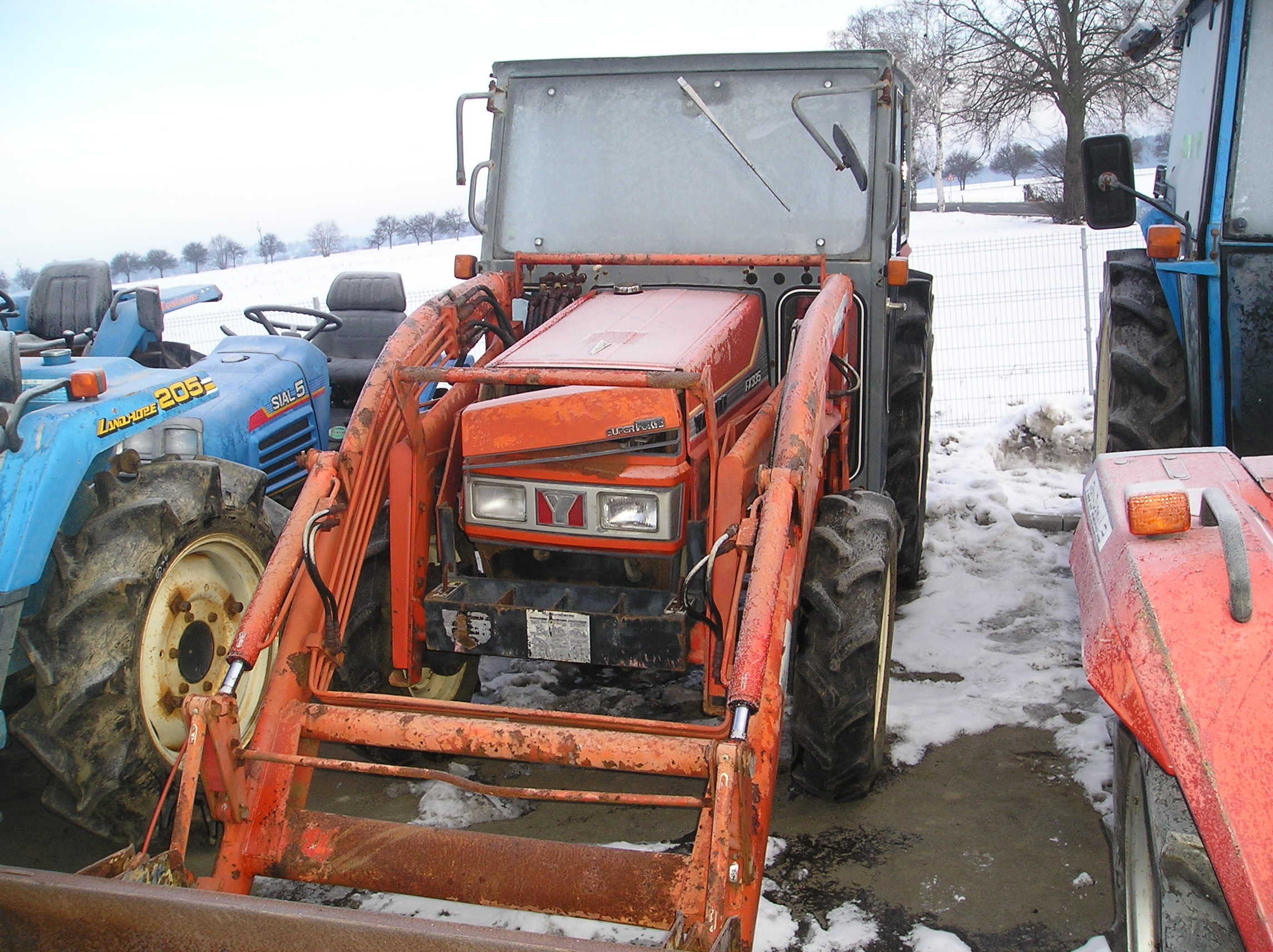

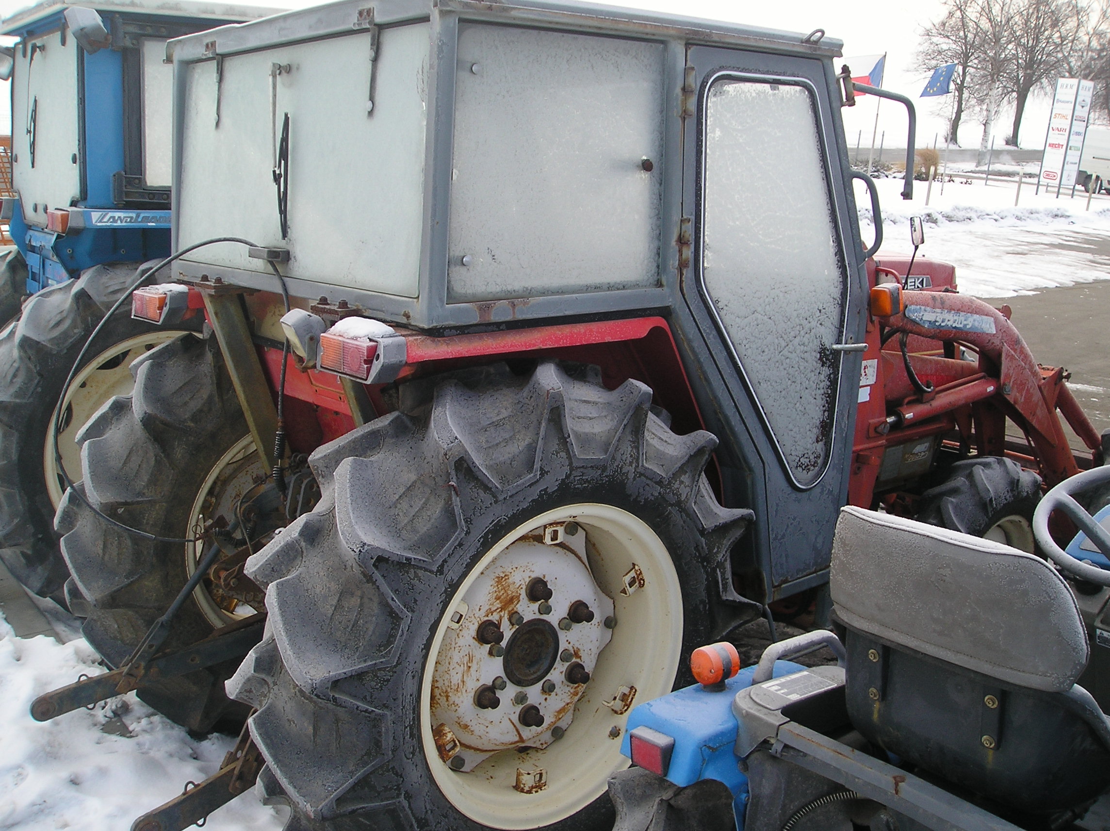

I found in Czechia now a Yanmar for sale, that on the technical side looks good. On the cosmetic side, it looks rough. What would be some sort of checklist if I go see what to go over and look for? Attached are photos of it. The seller said the loader has a 600kg/1200lb capacity and 2.8m / 9ft lift.

Make sure you run in all gears, high and low speeds. Make sure 4 wheel drive operates correctly. Check front wheel knuckles and axles for signs of leaks. Check all fluids for correct level and condition. Take a look at the air filter. Make sure coolant level is correct and overflow tank has a level. Try pto in all speeds. Make sure 3 point operates as it should and has no fast drop with engine off. Work loader in all positions making sure it also has no fast drop with engine off. That's a few things you can check. Good luck with your purchase.

The other aspect to consider is support. If that tractor has lived there for years then there must be some local support. If it was brought there used and there is no local support, then you may wait at least weeks for repair parts when it eventually needs attention.
My first Yanmar looked equally beat-up but I found all essential components were in good condition. But it took me a month to find and install all the small stuff that should have been repaired long ago by the previous owner.
I found things like the fuel filter assembly (which he had discarded) at a source he hadn't discovered: an importer of repainted tractors like the importer you found. If you don't have local support then expect that the tractor could be out of service for weeks while you wait for mail order parts. For hobby use that may be acceptable. If you have a critical need such as delivering hay to livestock in all weather, then maybe a locally supported brand might be a better choice.
But Yanmar tractors are excellent. If you buy it, you will love it.
One other comment: The tractors you found with nice paint are random quality, in some cases assembled out of pieces from several junk tractors then an excellent paint job applied. There are factories in Vietnam that specialize in this. It is believed that some of their input is tractors that served one useful life in Japan, then after retirement a second life in Vietnam, then when retired in VN as worn out, they get put through the 'reconditioning' factory. Long ago posters here told of visiting used tractor junkyards in Japan where they saw random salvaged tractor parts loaded for shipment to the VN 'reconditioning' factories.
So this one in original condition may provide useful life for the future as good as, or better, than a repainted one that is claimed 'reconditioned'.

fx335 is my favorite Yanmar. how many hours on it? looks to not be redone which is great. if you are mechanically inclined i think you'll be ok.

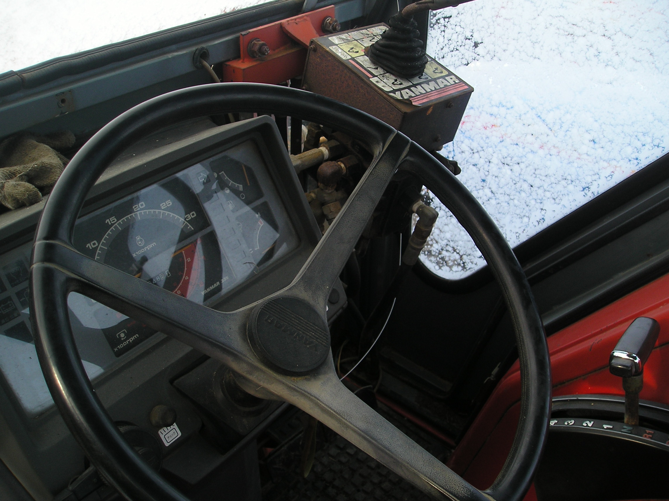

At least 548 hours-- but in the photo the steering wheel blocks the thousands place, so potentially 9548 hours :)

Well, the video sent isn't terribly confidence inspiring to me. Yanmar FX355 - YouTube
I see holes rusted through the FEL bucket, which, well, they are pretty thick steel, aren't they?
And we asked if he could lift the bucket to full height with 300kg in it (e.g. 6 50kg bags of wheat, which aren't hard to come by in the countryside), but it seems that getting the bucket to lift up off the ground took quite a bit of effort.
I may just have to pass this one by and keep looking.
