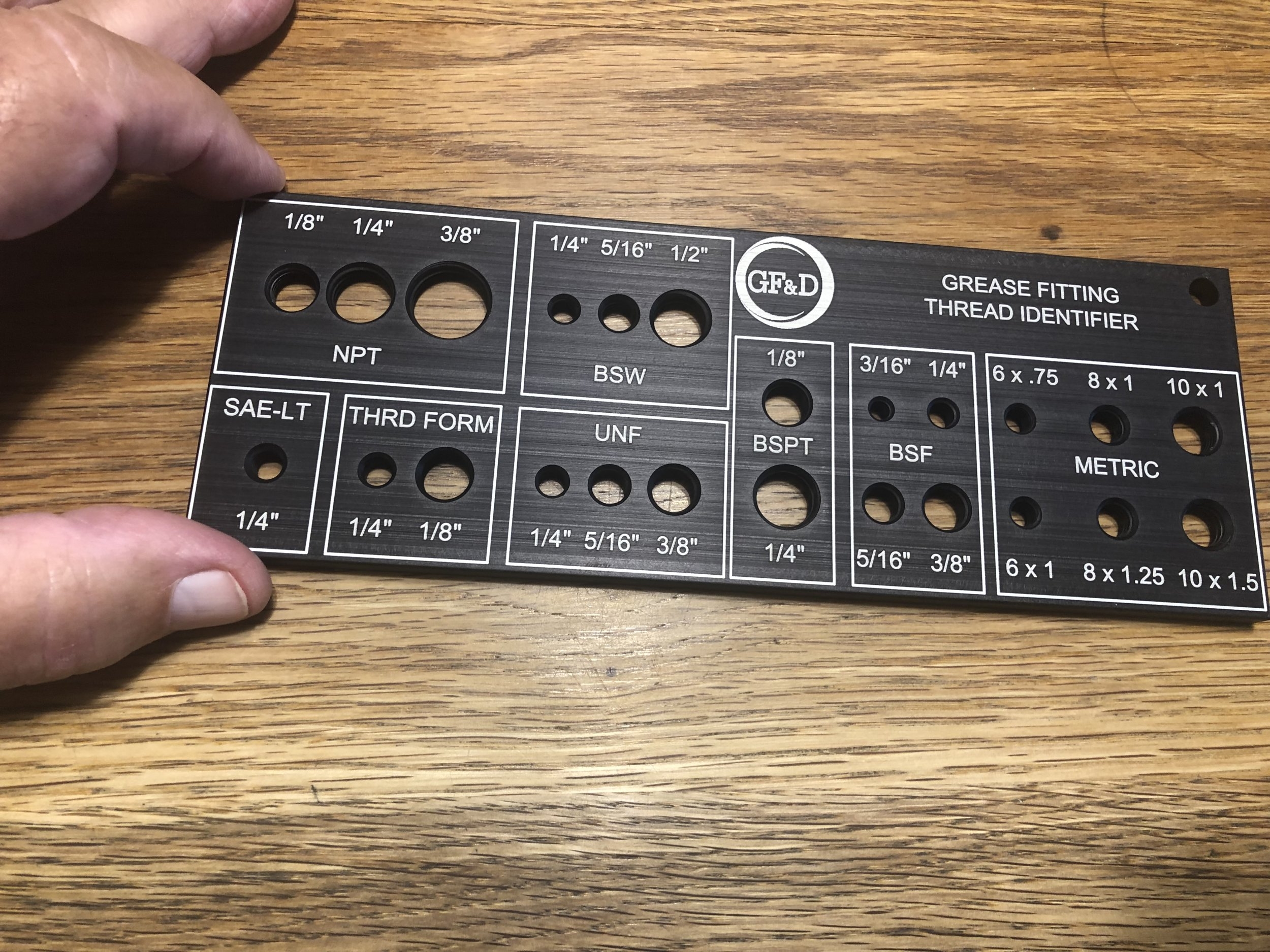

The three issues that I have with changing the threads for grease fittings are that I need to have a blind, or bottoming, tap to be effective, I am not a fan of trying to change threads in an existing hole for strength reasons, and I need some way to ensure that I don't let metal chips from the tap get into the bearings. It is the latter one that keeps me from rethreading blind bearing fittings if I can't completely disassemble them. I may be too cautious, but there it is.
That said, I would love to have a set of thread checkers that could thread into BSPT, metric, and SAE threads. I used to help maintain a machine with Whitworth fittings and threads. Nightmare finding parts in the US. I find myself with a micrometer trying to measure fittings, then checking threads, and then going back thinking "that can't be right". Kubota apparently has some fitting threads used only on their machines.

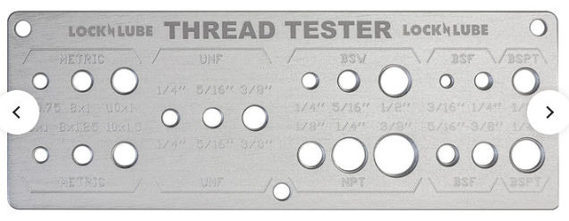

I dont know how to do a search on here. Someone has probably already addressed this, but I cant seem to figure out what size my zerks are.
I tried metric and they dont fit. SAE either, although 1/8" NPT seems close.
What the heck am I dealing with here?
Hi John,
You may have already found the answer, but I too fought with these grease fitting replacements on my 2015 SA424 FEL. Long story short, they are M8x0.75. I used the LockNLube thread tester. After finding out they are more expensive to source, I tapped them all to M8x1.
Much more common, in stock, and cheaper. Hope this helps everyone.
   / Yanmar Grease Fittings #17
Lock and lube the way to go! Then you can get it out.
