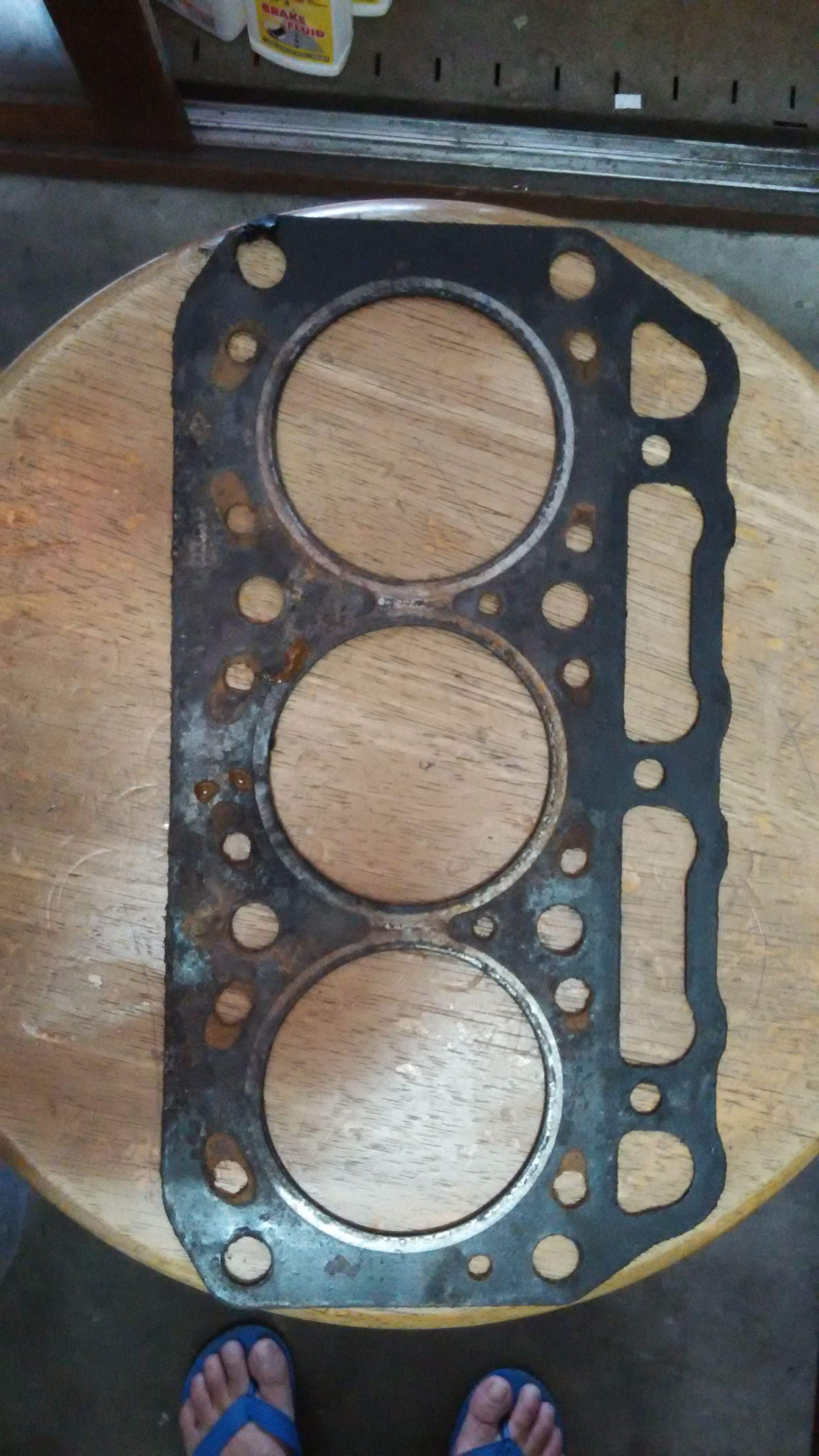

Hi, I am currently looking for a head gasket for Yanmar engine. Does anyone know this head gasket is for which engine model?

No engine model or tractor model??:confused3:
/ Yanmar head gasket #3

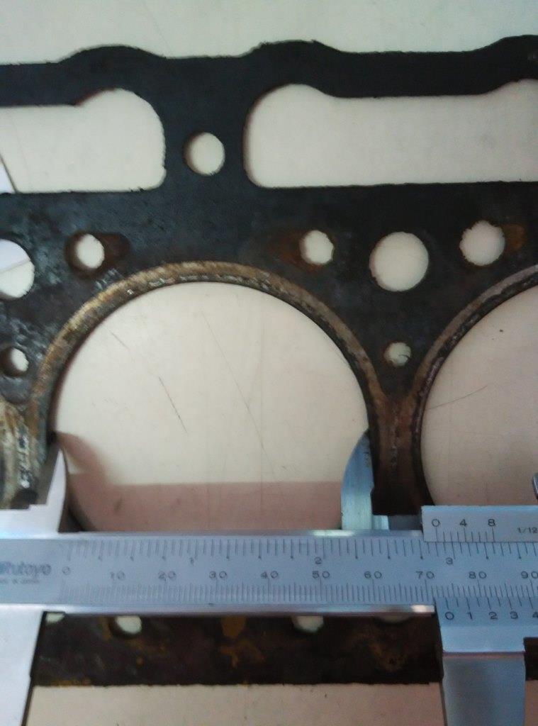

If you can't find an engine model number we might be able to help with a bore diameter and distance between cylinders.
/ Yanmar head gasket #5
How about some more photos? The whole tractor, engine id plate, head and valve cover, maybe the dashboard. Or is it in a forklift or something?
So far that gasket could be anything.

It's similar to the 3T engine family. The 3T80, 3T90, 3T84 and such.
hi hoye tractor,
i have attach a picture for your convenient. the diameter of the old head gasket was about 73.5mm. thats all the info i have at the moment

Well, he did say it's a Yanmar "engine". Maybe it's industrial or Marine and not even a tractor. ;)

That's why I replied asking if the engine wasn't a tractor but actually Marine or Industrial. Yanmar makes a 3T80LE that can be used in a Firetruck as a pump engine or other applications too. If you have a Yanmar YM2500, YM2610, or John Deere 850/950 one could use the 3T80LE as a drop-in replacement long as a few minor parts from the original engine are moved over. Thus, you have let's say a 1981 tractor, but with a 2015 engine. lol

I see a few thousandths over 2 7/8" on that vernier scale.

Here's a 3T70B
3T75U (fits YM1601, YM1602, YM1610, YM1702, YM1720, F16)
head-gasket-yanmar4.jpg <---- My guess is this one.
Yanmar OE p/n 121470-01332
3T72SA (fits YM1510 and others)
3T75U-NA (fits YM1702 and others)
3T72SB (fits YM1401 and others)
3T75U (fits YM1610 and others)
/ Yanmar head gasket #18
OK, I've taken both pixs and flipped and resized to compare.
The original
The 3T75U
So, Yanmar OE p/n 121470-01332 should be the head gasket. The prices range from $35 to $100.

The distance between the Cylinders are way off. Twice as big on the Old HG. than the 3t75u new one. I don't believe that's it. Maybe the Same Eng. but with a larger Cyl. Bore. Jefferycks is showing 73.5.mm so that will be easy to check if it's the correct one.
/ Yanmar head gasket #20
Looking at a few historic threads on the Yanmar forum, California and a few others understood that taking lets say the 3T75U and compare the numbers. 3 = number of cylinders. T is engine series. 75 the cly bore or piston size. U for the variant of that engine.
75 and 73.5 in millimeters is tight. Thus, I would conclude that the HG could be the match.
