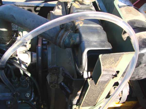

BIG DISCOVERY TODAY!!!!!!!!!!
I phoned the recommended diesel shop but they don't work on tractors, only injectors and pumps so I decided to do more research.
It is DEFINITELY air getting in the line. To test my theory of air getting in the line from the injection pump, I went out and bought a piece of clear polyethelyne tubing to temporarily use as a fuel line so I could see inside the line at what was going on. I installed the fuel line and bled all the air out and started my tractor and let it warm up. After a while, bubbles started floating up in the fuel line from the injection pump. They did not come from the other side of the line leading to the filter. The low quality video I have attached shows the bubbles coming up from the injector pump. The photo shows how much air is in the fuel line when I stopped it. When I let it continue to run, it runs till the line is full of air then stops.
This is proof to me that it is probably a bad injector pump but could it possibly be a bad injector letting compression feed back through the injector pump?
A rebuilt injector pump is $400 and a new one is $660 so I want to be absolutely sure before I spend my cash.
Is there anyone who can find fault with my findings or diagnose the situation differently?

   / Yanmar loses power, slows down & kills #106
I have nothing of any value to add other than I'm glad you finally know what is going on. That was a great idea putting that clear line on, with the bend facing up to collect the air.

My injector pump is nothing like that one. It is much simpler. It has no driveshaft because it works off the cam and had 3 plungers, one for each cylinder. Each of these plungers must have seals that can go bad and let air in. You can see one similar on Hoyes site that is for a 2 cylinder here. INJECTION_PUMP: Yanmar Tractor Parts
I am almost dead certain that this is the problem and I am going back to the diesel shop that said my pump is good tomorrow to discuss this with them. I feel that they tested to make sure my pump was pumping but did not test to see if it was leaking air out the seals.
Now my biggest decision is whether to buy a new pump or rebuilt or get this one rebuilt.:confused:
