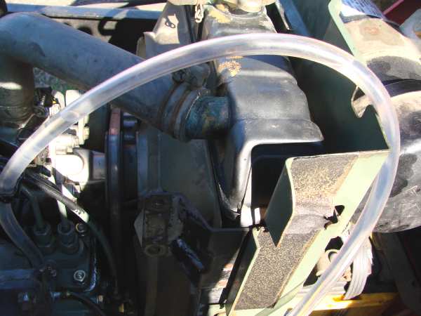

Is there a banjo fitting where the fuel line meets the injector pump? Has it ever been removed?
Seems to me that's the last place air could enter, if it sucks air regardless of which tank is feeding it.

Has he confirmed fuel flow to the injector pump, during the stalling?
   / Yanmar loses power, slows down & kills
#57
UPDATE.....
I had loosened the fuel lines at the injectors while the motor was cool and running well. When I did that it slowed a lot on each cylinder that I loosened. Today was the first time that I loosened the fuel lines when it was WARM and RUNNING BAD.
When I loosen cylinder 3 it starts to kill immediately.
When I loosen cylinder 2 it slows a little but continues to run.
When I loosen cylinder 1 there is no difference.

I am no expert but, it seems to me that cylinder 3 is probably running normally (it keeps the engine running) , cylinder 2 marginal, and cylinder 1 not working at all. Obviously it is fuel related but, whether it is the pump or not I have no idea. I believe you said that you had the injectors tested and replace all of the fuel lines, etc. That kind of leaves the pump as suspect. It may be worth taking off and having it tested at least. (I know that is not a simple job.)
   / Yanmar loses power, slows down & kills #60
That bleed tank that you set up is a little puzzling, and it is true that it is a gravity feed to the pump, but, my manual says that the injectors take 2276 psi to open. That means there is a pump in the injector, and if it pumps out, it must also pump (suck) in. It wasn't designed to pump air, just diesel. There would have to be a heck of a restriction to cause negative pressure on the fuel line, and suck air, since it is much larger than necessary to meet the fuel requirements of the engine. But it is possible especially with rubber lines and primer pumps. I hole can act like a one way flapper valve. I read one of your earlier post about a primer pump:
I have a primer pump by the filter and one by the pump. When I pump the one by the filter it shoots out a good stream of diesel. When I pump the one by the injector pump it shoots out only a little dribble of fuel but this finger pump may not be working well.
Are you talking about the type of pump that is on an outboard motor tank? Is that original? I don't understand why you would even need one with a gravity feed supply. I have seen them stop up and get air leaks on outboards and shut them down. While my manual does not specifically address your engine, this is what it says about the injector pump:
"Yammar PFR2K two plugner fuel injection pump is used on all two cylinder models and Yanmar PFR3K three plunger fuel injection pump is used on all three cylinder models. The nozzles inject into swirl type precombustion chambers. Because of extremely close tolerances and precise requirements of all diesel components, it is of utmost importance that clean fuel and careful maintenance be practiced at all times. Unless necessary special tools are avaiable, service on injectors and injection pump should be limited to removal, installation and exchange of complete assemblies. It is impossible to re-calibrate an injection pump or reset an injector without proper specifications, equipment and training."
If you are going to have to have the pump rebuilt or replaced anyway, it wouldn't hurt to blow the fuel inlet on the injection pump out with air. There may be a piece of trash (rust, rubber line, a piece of o-ring) in there that is stopping the flow. So these ideas are my last shot. If this is something you have already tried or doesn't work, there is nothing left but the pump. I wouldn't think it would be that hard to find someone willing to work on a Yanmar injector pump. They are very common in marine and generator applications.
