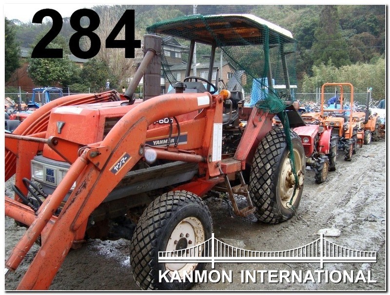

pic f60d
   / Yanmar Models #14
I wonder why one would run dually turf tires on a machine that big. Is the netting for protection against golf balls, or birds nesting in the operator's station? Thanks for the photo.
