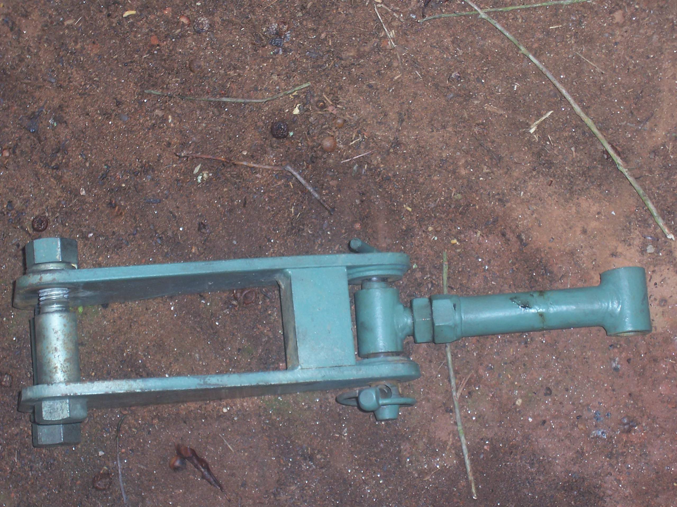

This is a top link for my RS 1400 it worked extremely well for me. My guess at that price it maybe missing both. Dr. shaft and Top link.

Thanks for the picture careyo63. I didn't have mine available to take a picture, so hopefully that will help richriddle out.

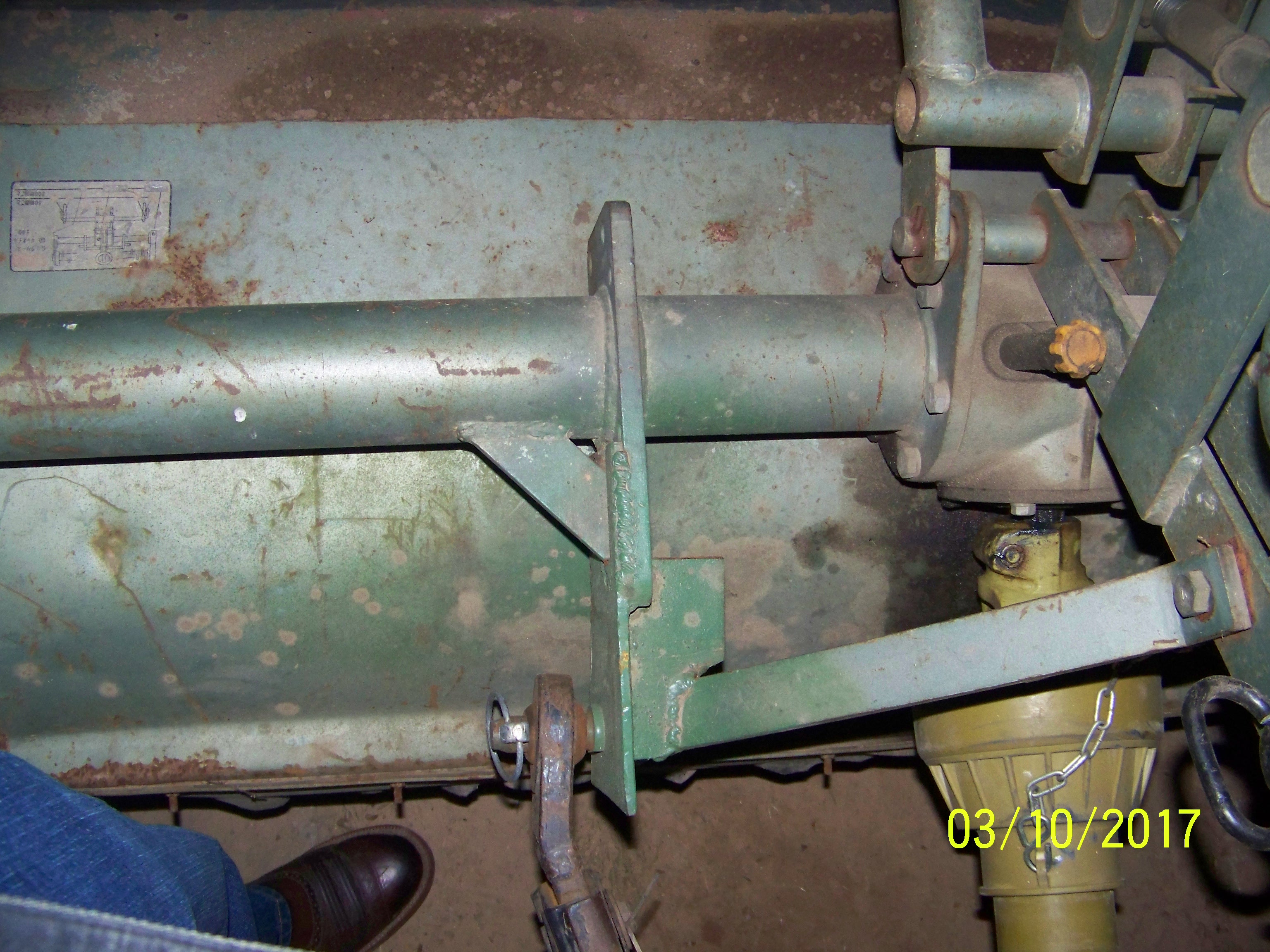

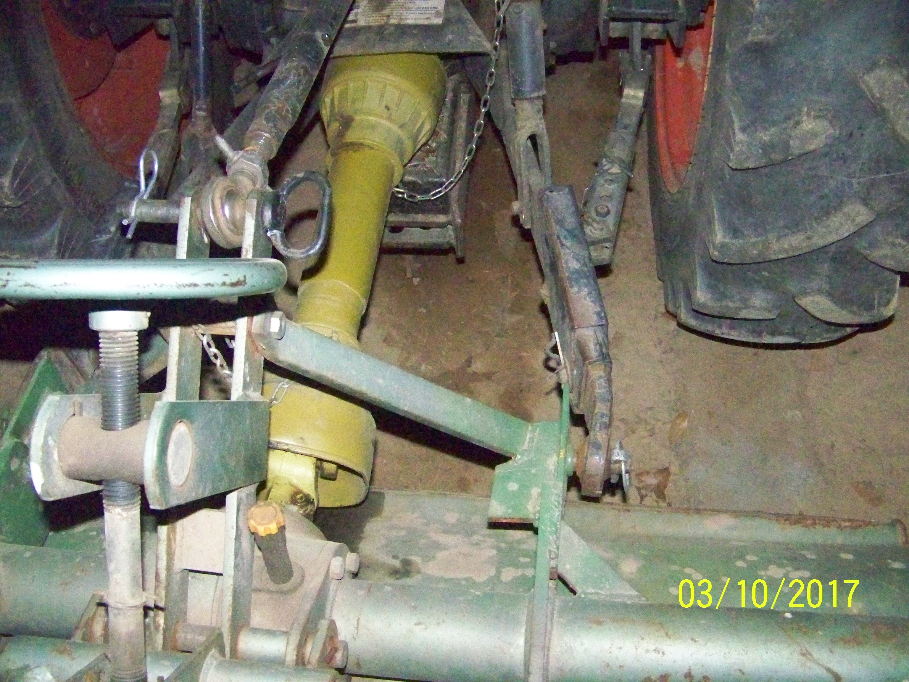

If I didn't have a tiller I would sure be there looking at it. I moved my three point pins forward enabling normal 3 point usage but didn't have to cut anything off the main drive tube.

Nicely done Winston. Those pictures will make a nice reference for many others on here.

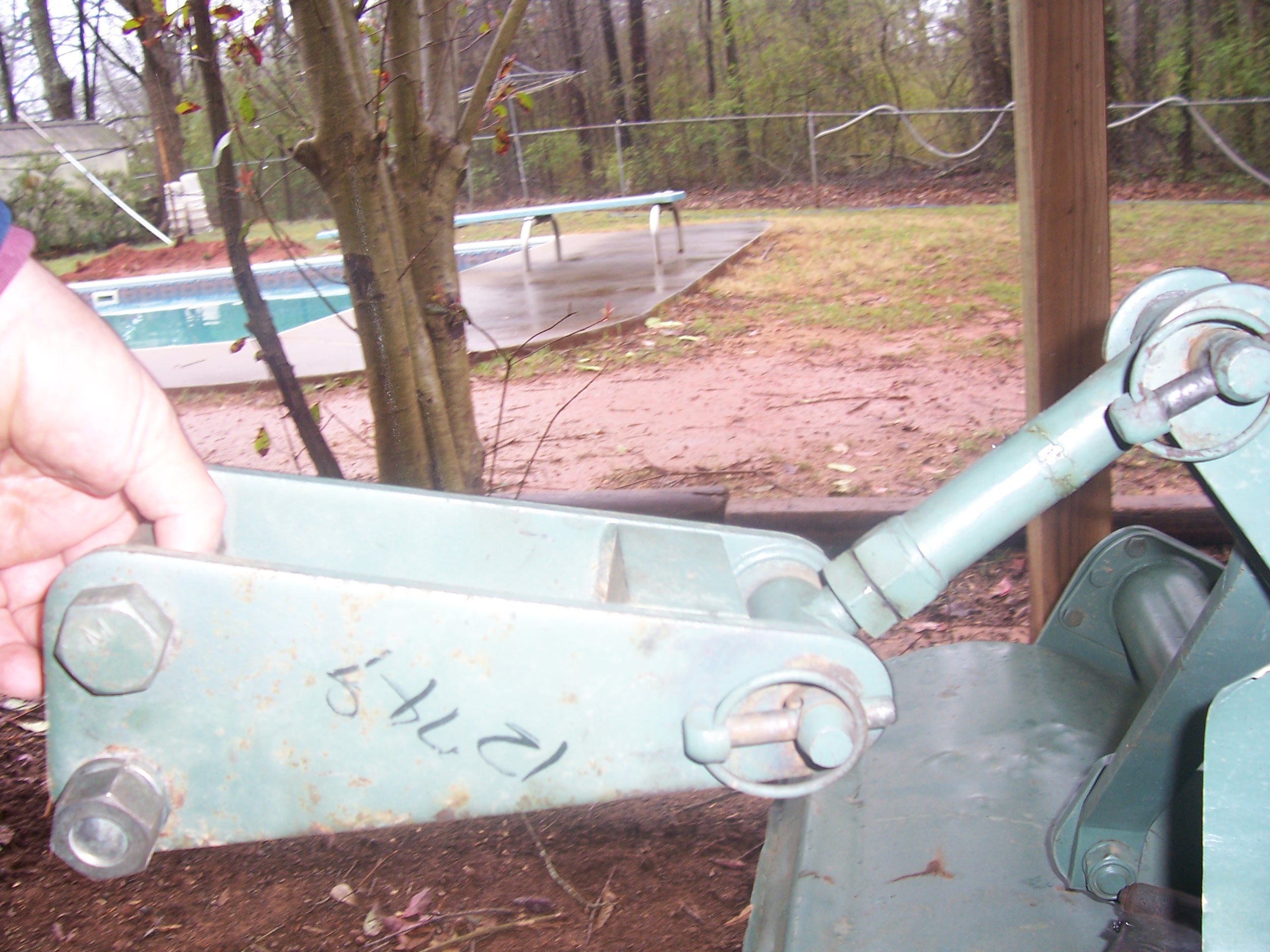

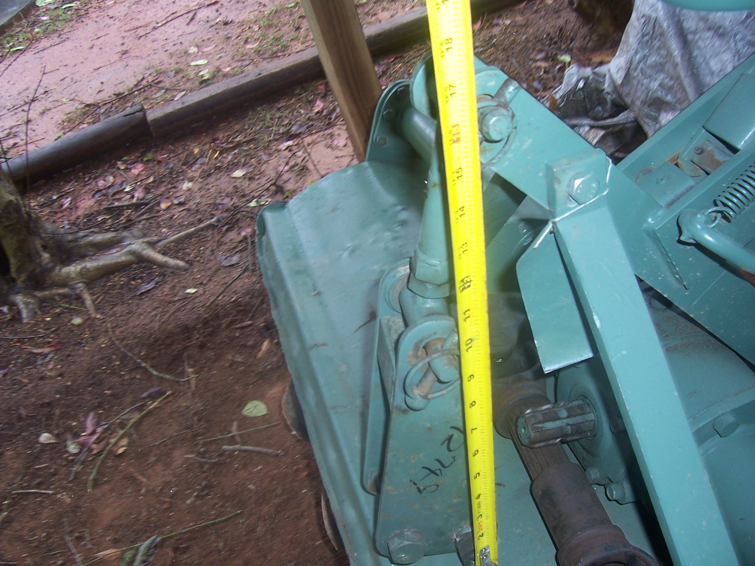

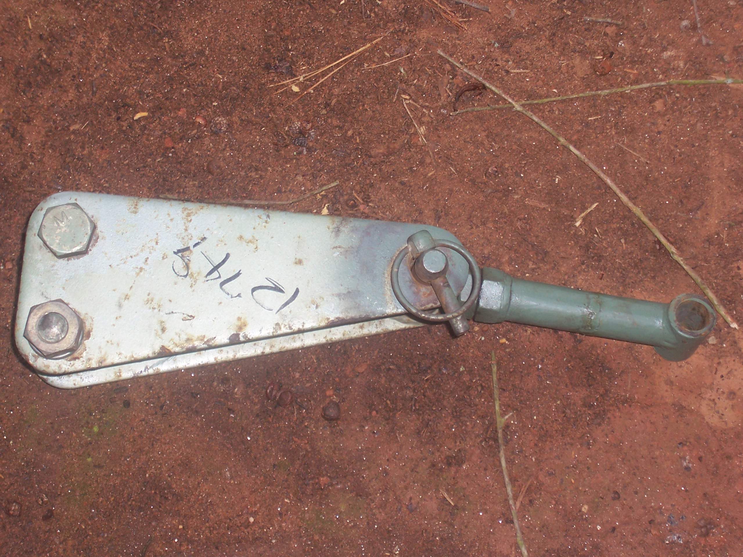

Found the other pic.s of the Top view and the setup of the Yanmar Org. mount. Simple and would be a lot easier to fabricate. The shape of it really doesn't matter all your after it to do is have a movement of out then up when lifting the tiller. I'm taking it that is what was needed for winstons to work on a Kubota considering the Orange wheels?
