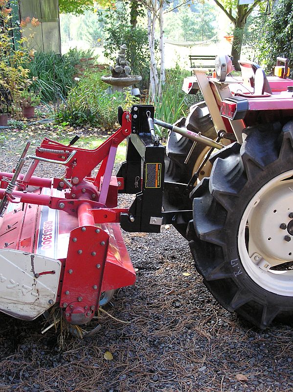

I have a yanmar rs1404 tiller and need to use it on my jd 2305 compact tractor. Can not seem to get it hooked up properly to the three pt hitch. Ideas?

These tractors and tillers were not made to US stds for the 3pt. I have and use a quick mount hitch with spacing to US std and I had to modify all 3 points on the tiller. Had to widen the spacing on the 2 lower points and raise the spacing on the upper point.

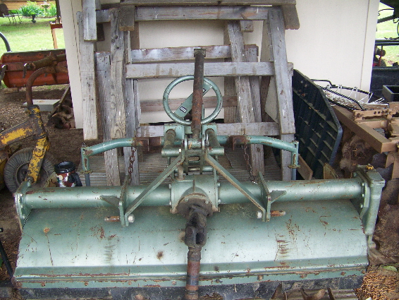

I find the link Winston posted interesting due to a tiller tine issue I had recently. My tines were blue like in this link and the tine profile looks exactly like those in the pictures. Had been lead to believe I had a unique tiller.

Typical. When I bought my RS1400. to use on my YM2000 Fredricks apparently didn't have the correct Dr. Shaft for it.The one they gave me wasn't even close!! I had to cut it up and shorteneded it.8-10 inches :confused: 2 Wks. to get the correct one to me. I was tired of waiting on it Esp. since that is the Tiller for a YM2000 and I am only 11/2Hr.drive away.
