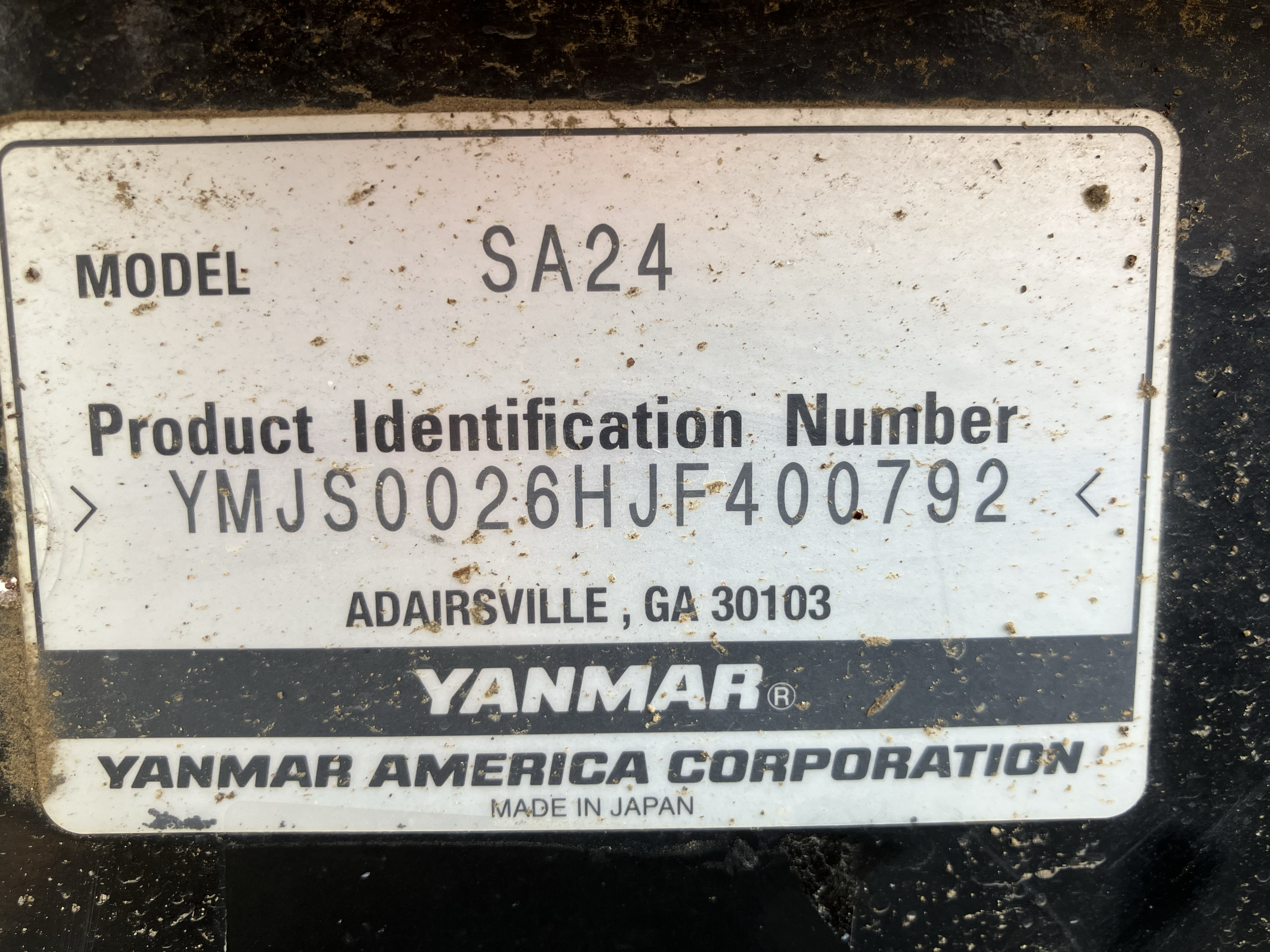

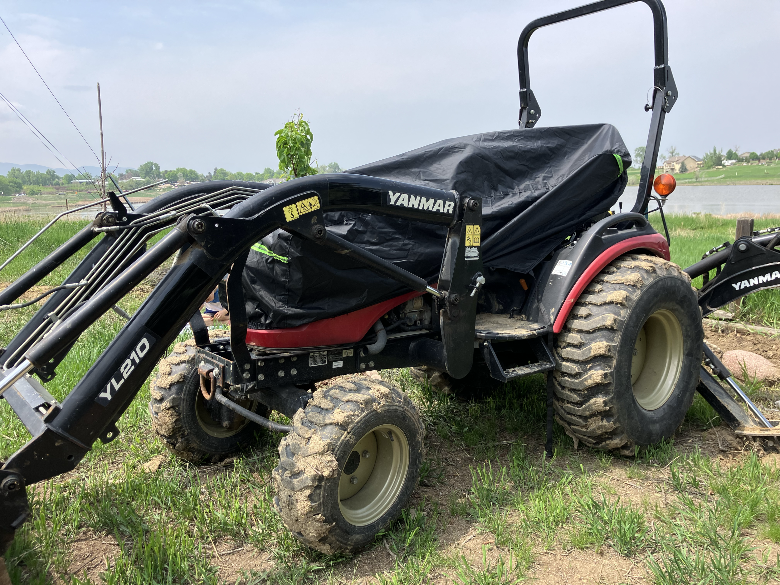

The SAx24 tractor is either a 324 or 424. The wheel size will determine which model it is. As for parts, it doesn't matter which you use, the only difference besides the wheels and tires is the decals. You missing range selector, it is exactly that. HD removed them to protect the tractors. Using in high range to perform heavy work is not good for the tractors. The part numbers you will need are: 1A8330-27501, 1A8060-67780, 22351-035032, and 22351-060032. That is the lever, knob, and the pin springs to hold it into place.

Definitely a "SA24". There are dozens listed on auction sites; all that I have seen came from Home Depot and are ex-rental machines. The larger rear wheels would make this based off the 424 I believe.
