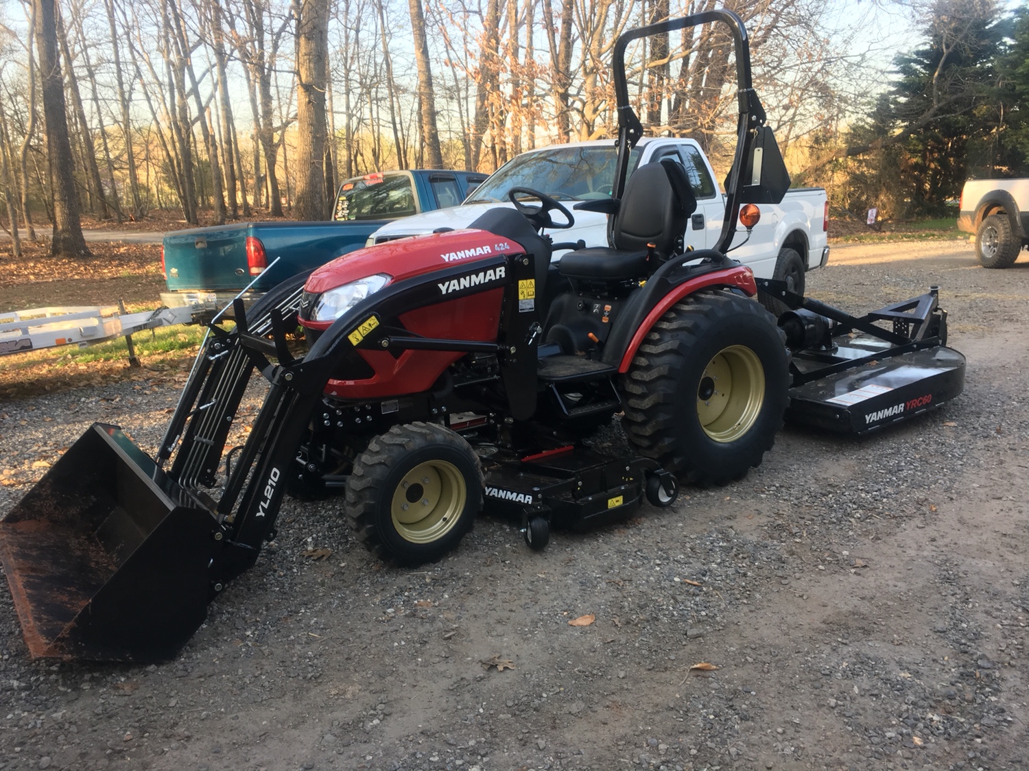

It is a drive over very simple but the pto shaft is a little hard to reachIMG_4249.JPG
Would be really hard to reach on 324
