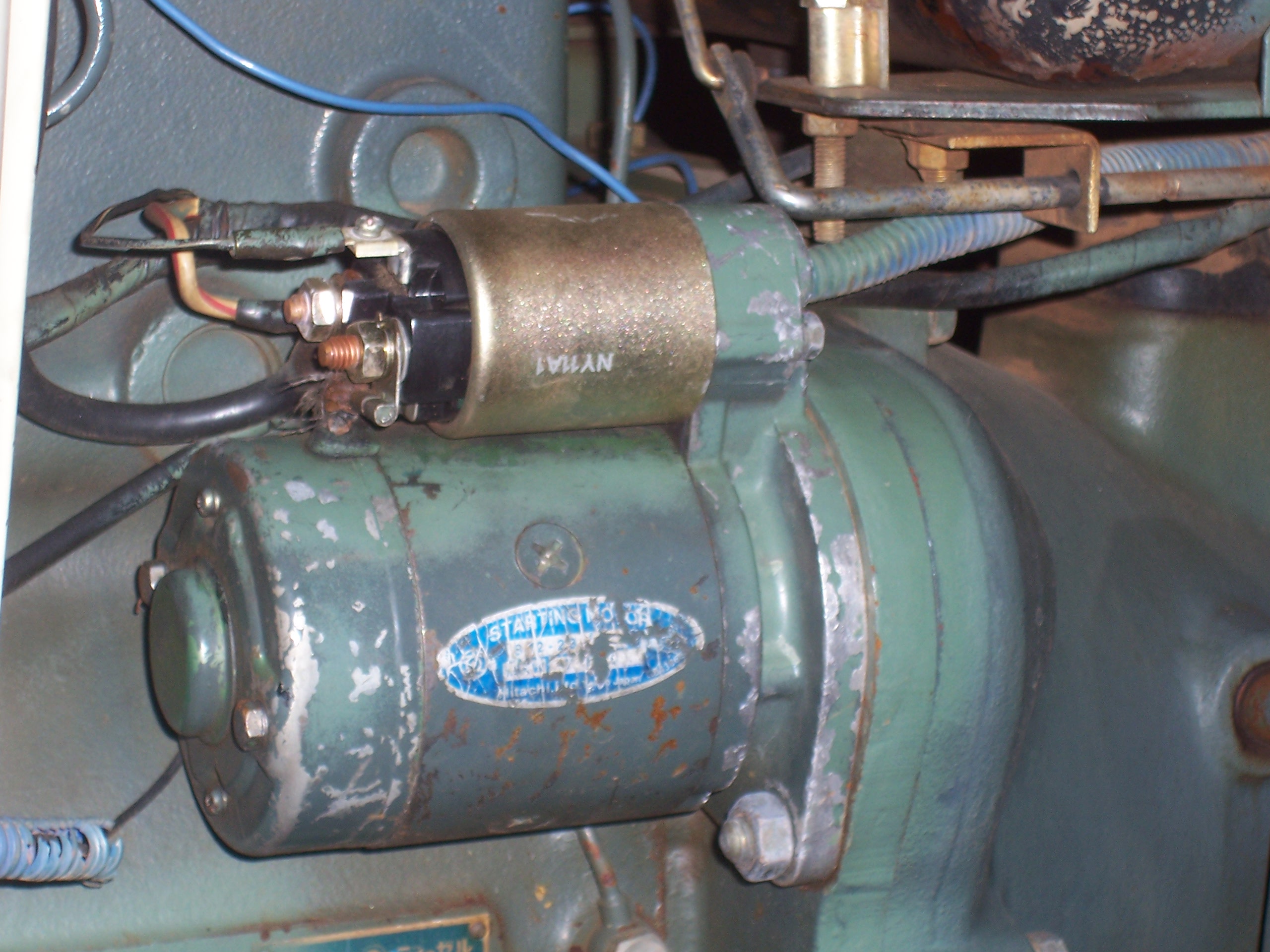

Troubleshooting my 1610 and I have narrowed it down to the starter. Looked it up on Hoyte and Holy Crap?! $400?!

That Motor is repairable from what I'm showing SM-235. I Repaired/Rebuilt mine 10yrs. at 73.00$. Check with a Starter-alternator shop or a Auto Elec. shop. Just don't say Yanmar! Just give them your #....yanmar starter motor SM-235 - Bing - Shopping
/ Yanmar Starters #3
You have narrowed your problem to the starter. What on the starter isn't working? They needn't always be replaced. It may be repairable. A shop which deals in automotive starters can probably fix it if your can't. If they can't fix it they can probably suggest a less expensive alternative to what you found. I say that from experience with my old Mitsubishi. Yanmar didn't MAKE the starter, they bought it somewhere.

SMH. I was even busted by this Shop of being into this motor. Turned the brushes around a yr. or so before having to get it rebuilt. They commented on it!! Actually gave me a thumbs up on how I done it. When I was paying for it stated I got all I could out of that motor. Hasn't been 10yrs, but it's still on there and working so Hey!! I know they had to replace the Brushes LOL. and a new Solenoid. Even at this many yrs. I've seen and had new starters from the El cheapo auto parts that hasn't lasted that long. NAPA. for me from experience over the Yrs.. I keep all Receipts also may need them.
