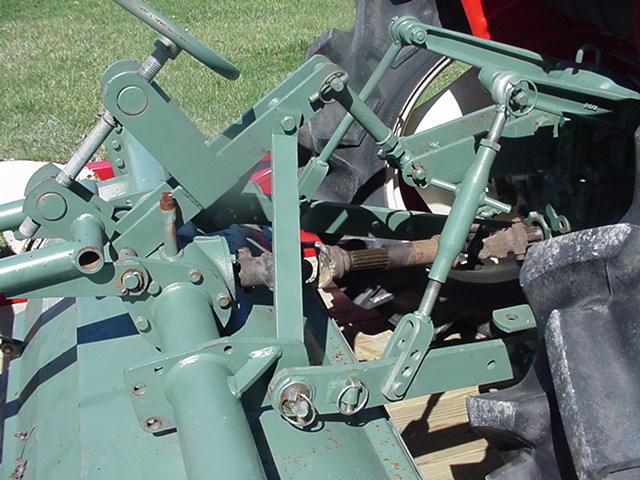

how do you check the oil level on your tiller? I just bought one and I need to know.
   / Yanmar tiller PTO speed
Well, to be honest, I don't really know yet. I've only had mine a few weeks and haven't really look at it that close. It looks like there is a fill plug, or maybe a dip stick on the top of the unit. I'll look a little closer tomorrow and let you know if I figure it out. Maybe someone else will chime in here in the mean time...
I attached a picture to show the plug I'm talking about.

Check out this thread, might help. I'll probably dig into this tomorrow, have to do an oil change on the Cub Cadet anyway, might as well keep going while I'm in the oil changin' mood /forums/images/graemlins/grin.gif
tiller oil change
   / Yanmar tiller PTO speed #10
</font><font color="blue" class="small">( Well, to be honest, I don't really know yet. I've only had mine a few weeks and haven't really look at it that close. It looks like there is a fill plug, or maybe a dip stick on the top of the unit. I'll look a little closer tomorrow and let you know if I figure it out. Maybe someone else will chime in here in the mean time...
I attached a picture to show the plug I'm talking about. )</font>
That's a dipstick on the top of the tiller. (At least it is on my RS1300 tiller). Also, on the left side of the tiller there is a fill plug on the top and an overflow plug on the side. You will want to fill with gear oil from the top until it runs out of the side plug.
