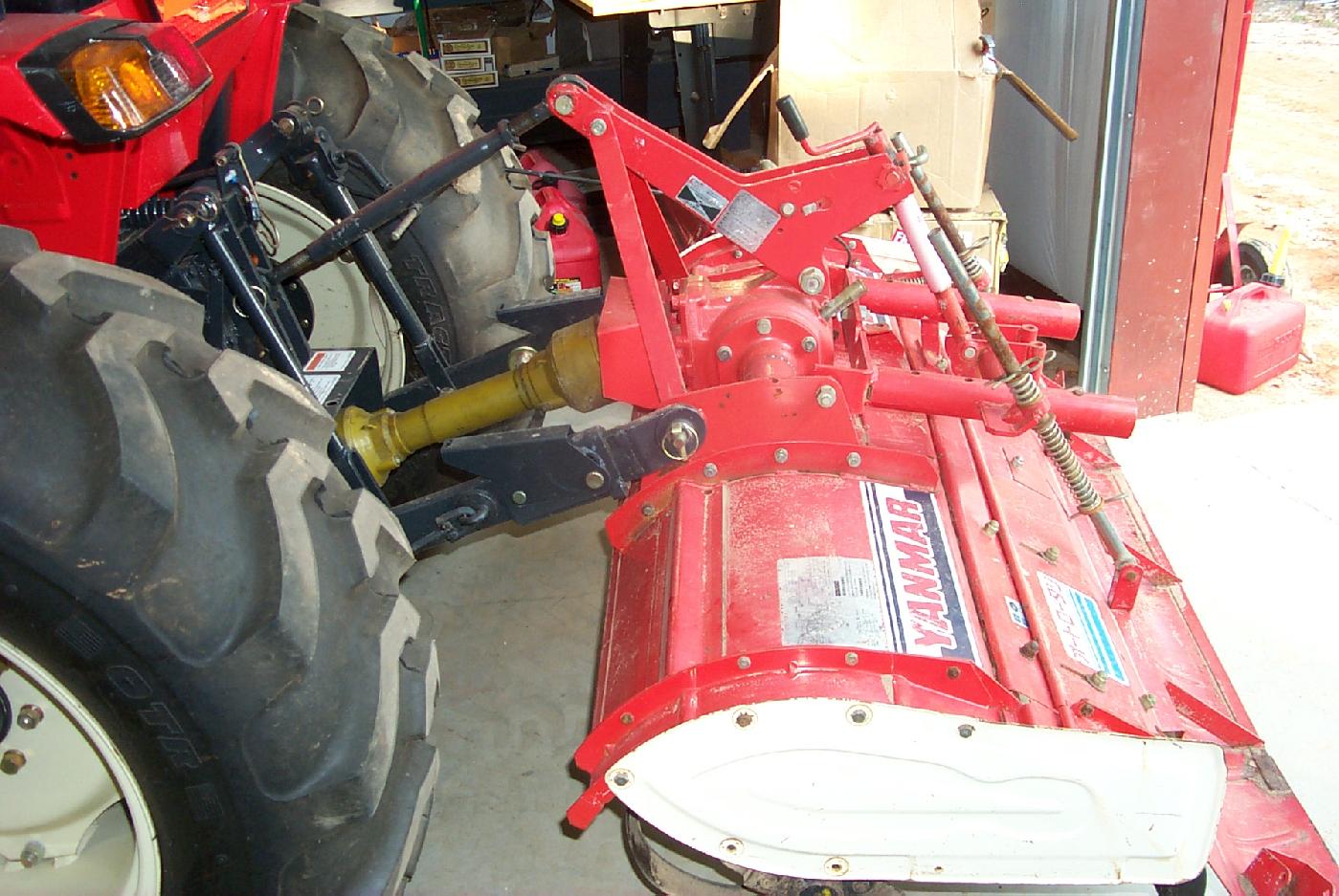

I have a Yanmar RCB 1500 that I use behind my Branson 4220 i tractor. I like it just fine. I use it for a garden spot about 100 by 70 feet. Its quiet and does a good job. On really packed hard clay, it bounces some. I remedied that by switching to 1000 RPM on my PTO, running about 1800 engine RPM, and using my lowest granny gear to inch through t the hard pack at a slower pace. Second or succeding tillings, I used 540 RPM and a little faster tractor speed and engine RPM, and it does great, with minimal bouncing or vibration. If I can attach a picture, I'll send it. I dont have a clutch on my driveline, either. Wish I had one.
Hope this helps.
