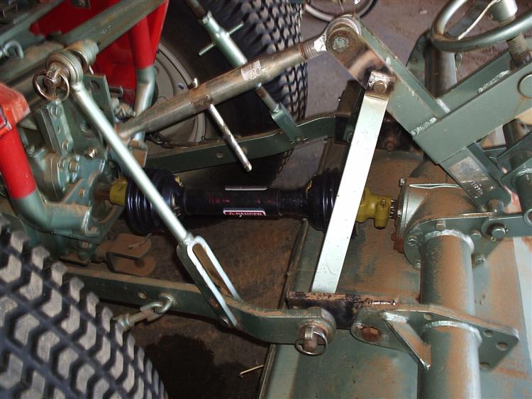

Due to my turf tires being larger than the Rice and Cane tires, I had to modify my hitch to move it back from the tractor. Of course then my drive shaft was too short. I went to Tractor Supply and got a spreader drive shaft and cut it to the right length. They do work just fine. Now to repaint all my modifications.

Those oversize turfs make for one tough looking tractor, but those wimpy front ones have got to go!

Man, Them's Volkswagon tires on the front:p :p :p
