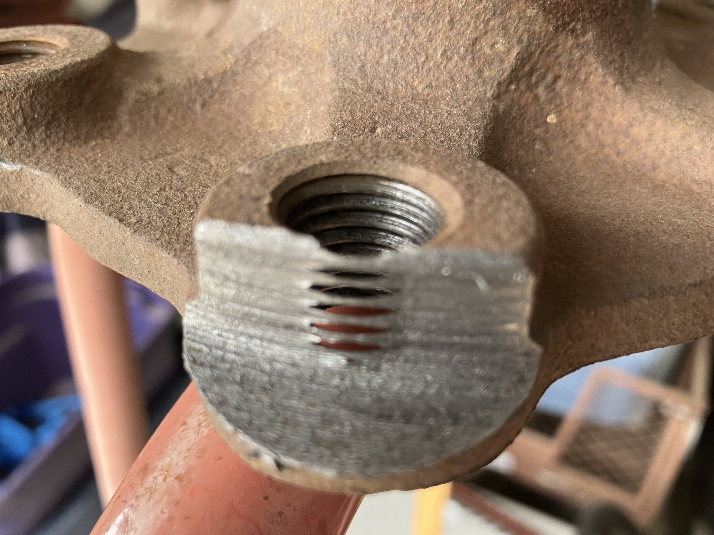

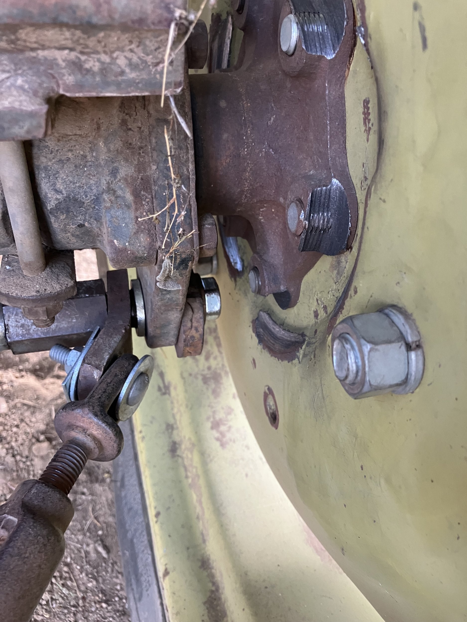

I am always finding, and looking for, loose bolts on my YM240. Here is one I missed. In the first pic you can see the silver head of the horizontal bolt that loosened up. As it slowly unscrewed it pushed out into the hub and hub bolts. Did a surgical job of slowly shearing both the hub and bolts! New hub and bolts, with a bit of blue loctite on them and the 3 point bolt, and everything seems good so far.
