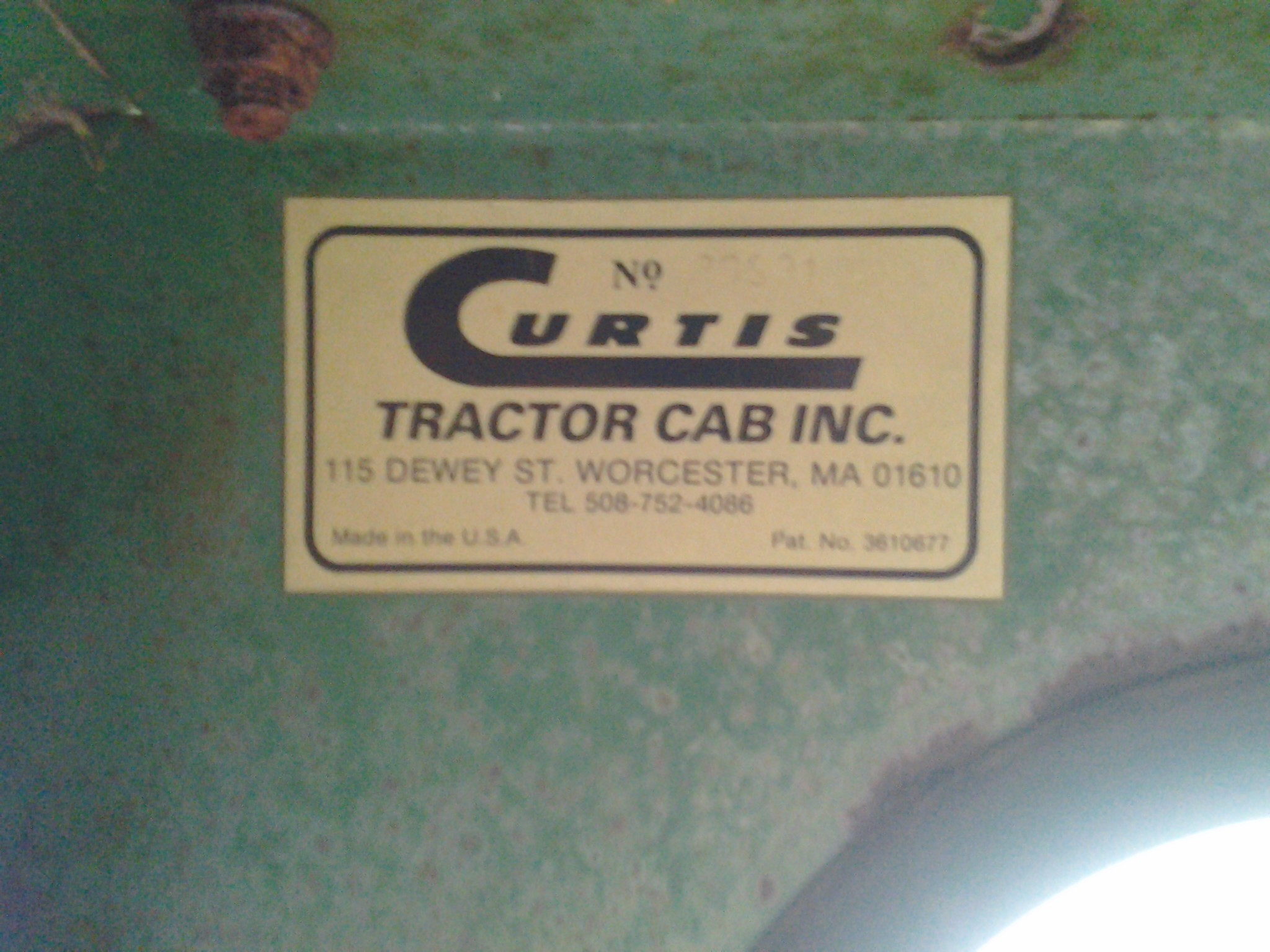

I purchased John Deere 850 4wd (Green Yanmar) project tractor with a Curtis Cab. Have not had time to work on it yet. I would say this cab would fit several Yanmar YM models.
   / Yanmar YM cabs
Do you have a Curtis Cab model number? IF it fits the JD850,950,1050, then I know it will fit the YM2500,YM2610,YM3000, and a few others.
   / Yanmar YM cabs #9
30931 Not sure if this model# or serial#
   / Yanmar YM cabs
Not sure either. It could be the s/n. The other number is a patent. hmmm
On their website, a model number looks like this: 1JD2025RCA2
