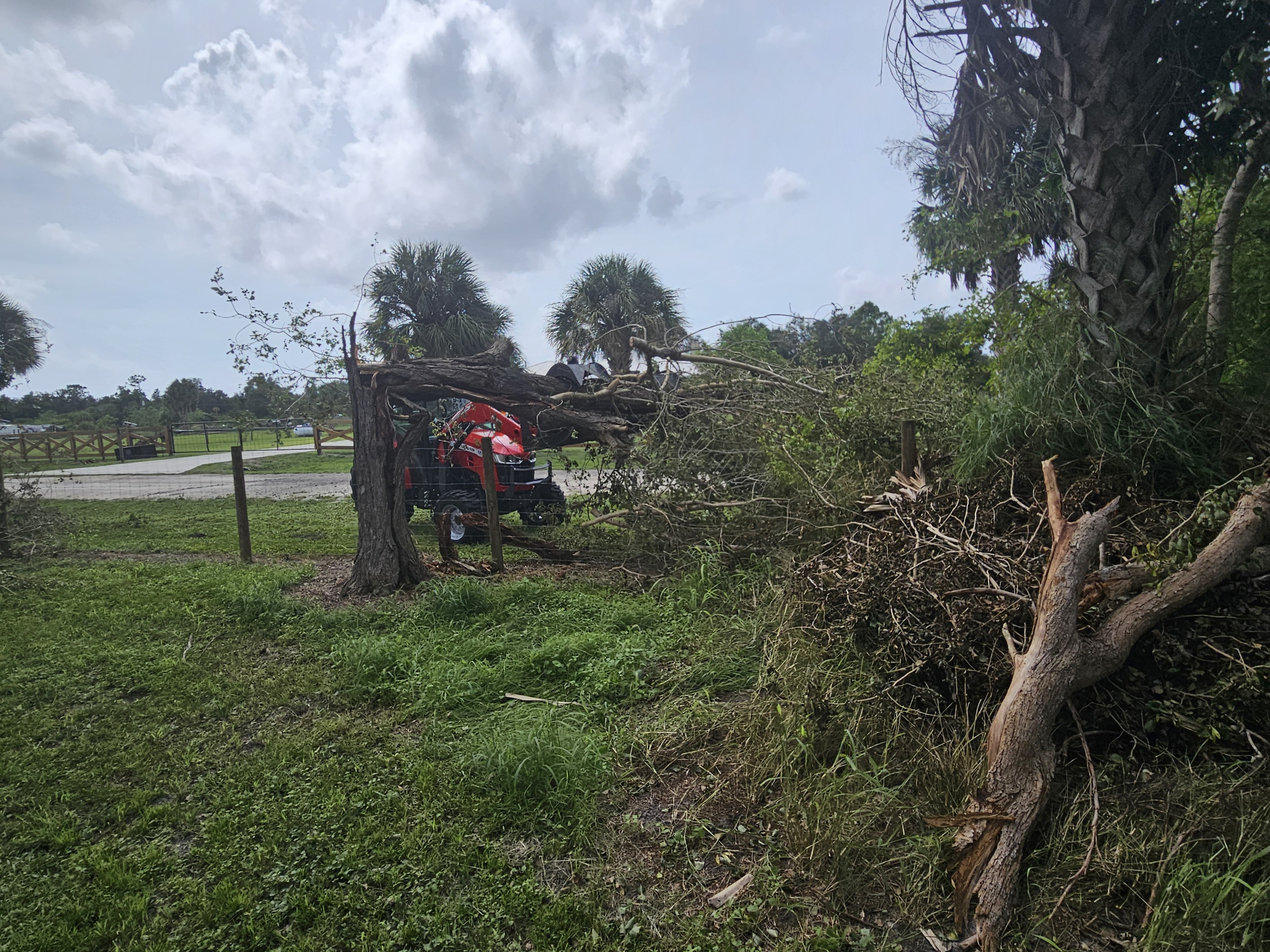

Got my new2024 Massey 2860mh and the ac blows nice and cold. Only have 4 hours on it and noticed while using the loader with the grapple to pick up 2 heavy trees the hydraulic rams got hot I would guess 120 degrees after 45minutes of work is that normal? My old new holland never even got warm. Oil in sight glass is full to the top from dealer

Pics of tree

You're good. Nothing to worry about.

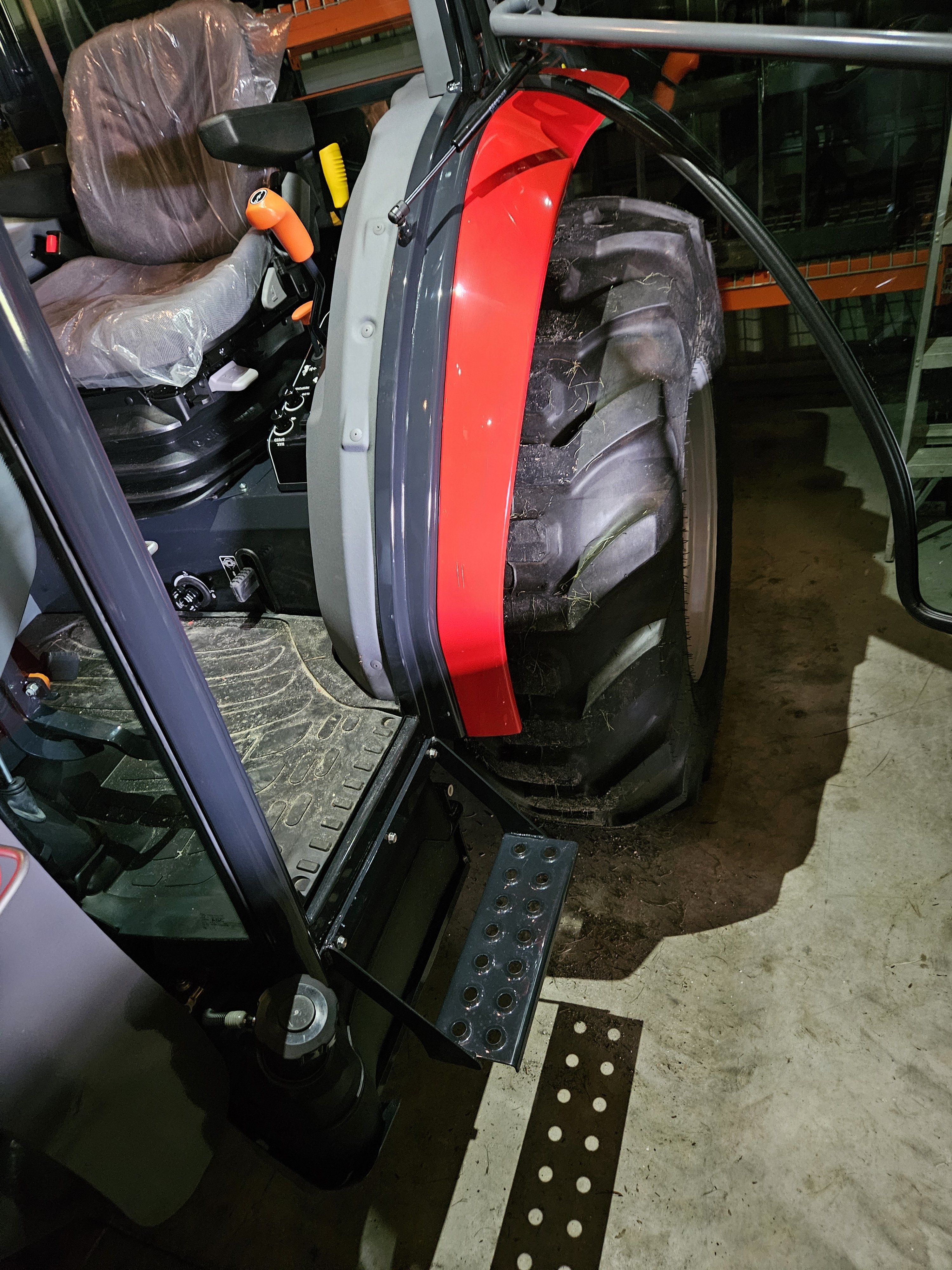

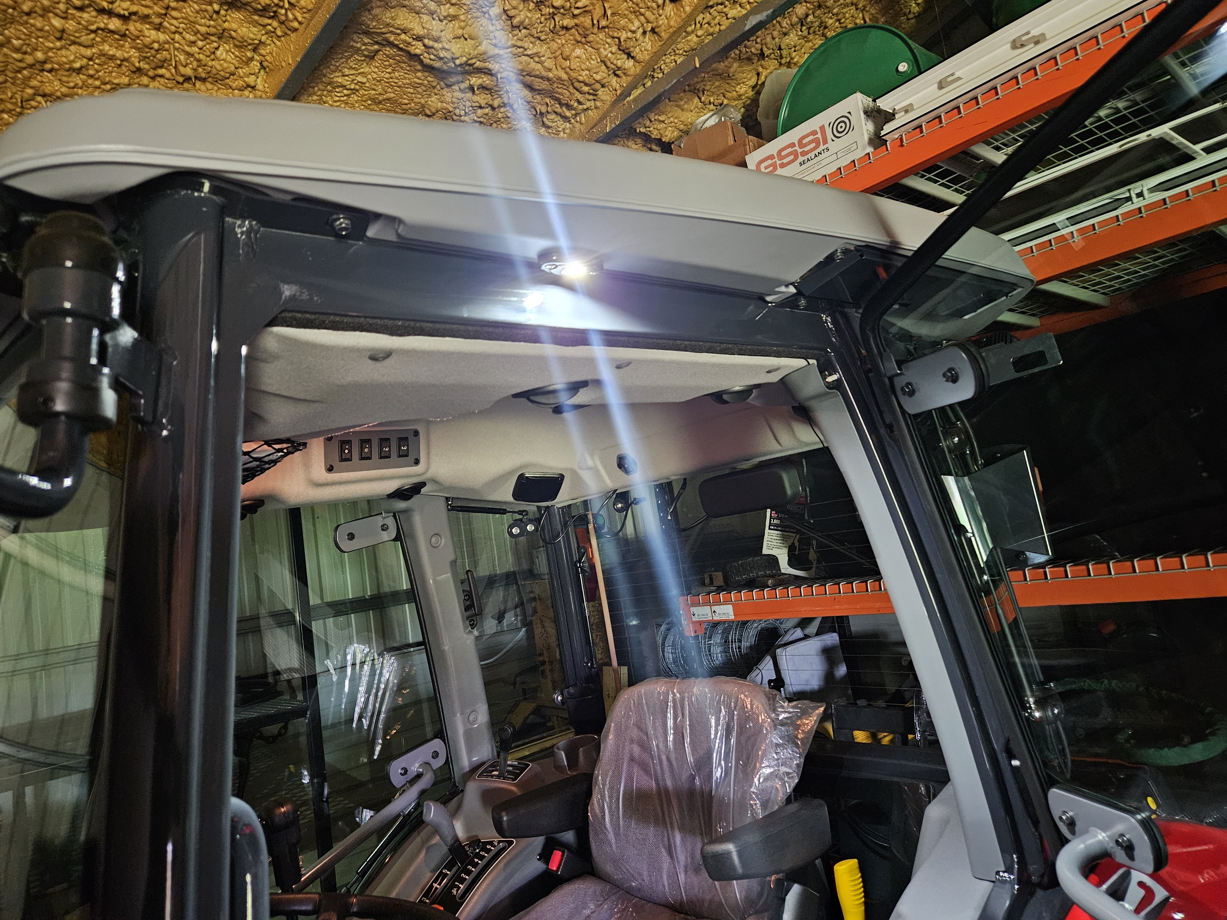

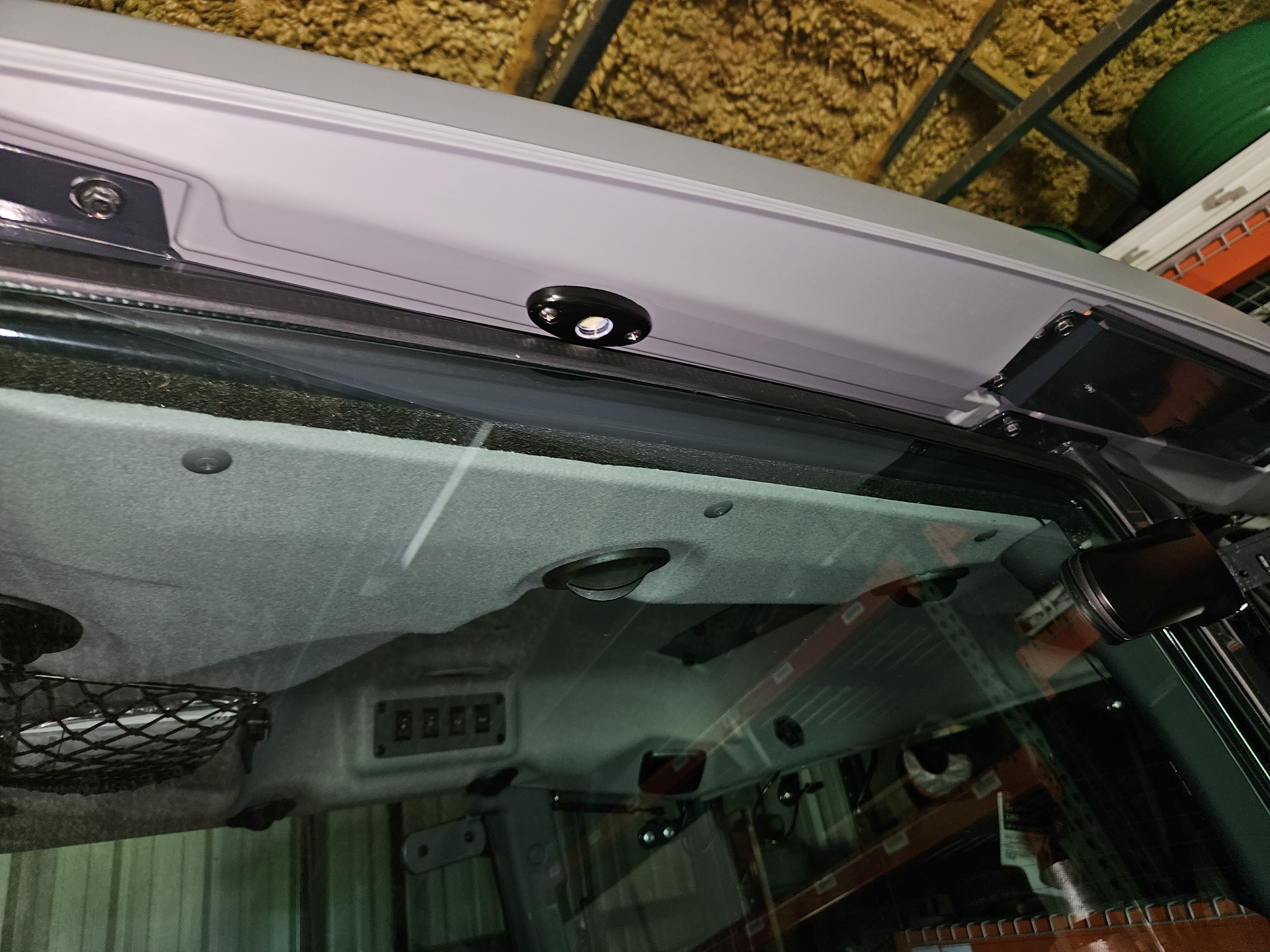

Got all the water spots off the windows now to get them tinted to help the ac here in s. FL
Also installed exterior led lights in the roof over the cab doors wired to the interior light to come on when you open the doors.

   / Massey Ferguson 2860M Cab #19
Led door lights
