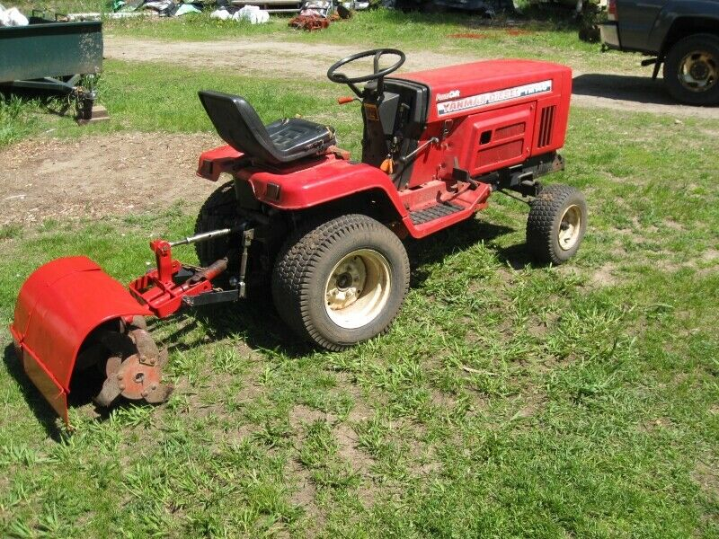

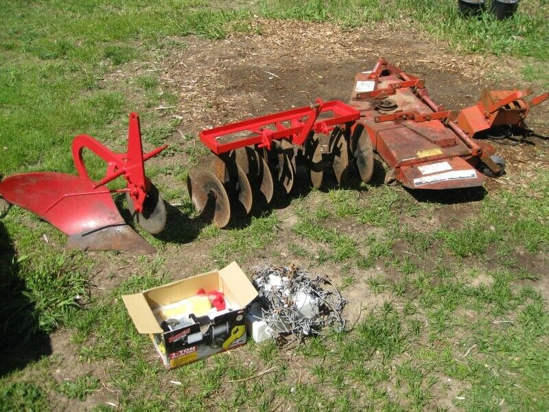

The YM14 no hydraulics was upgraded to a YM146 with hydraulics later on. The USA models also had the 3PT and Ag tires as the EU machines had no 3PT and turf tires. Very odd.
Here are the general attachments for the YM12, YM14, YM122, YM126, YM142 & YM146.
The YM142 & YM146 hydraulic USA models with the 3PT and PTO can run the Yanmar tiller and other attachments. See their parts manual below for all of these models. Can the YM14 be retro fitted?
