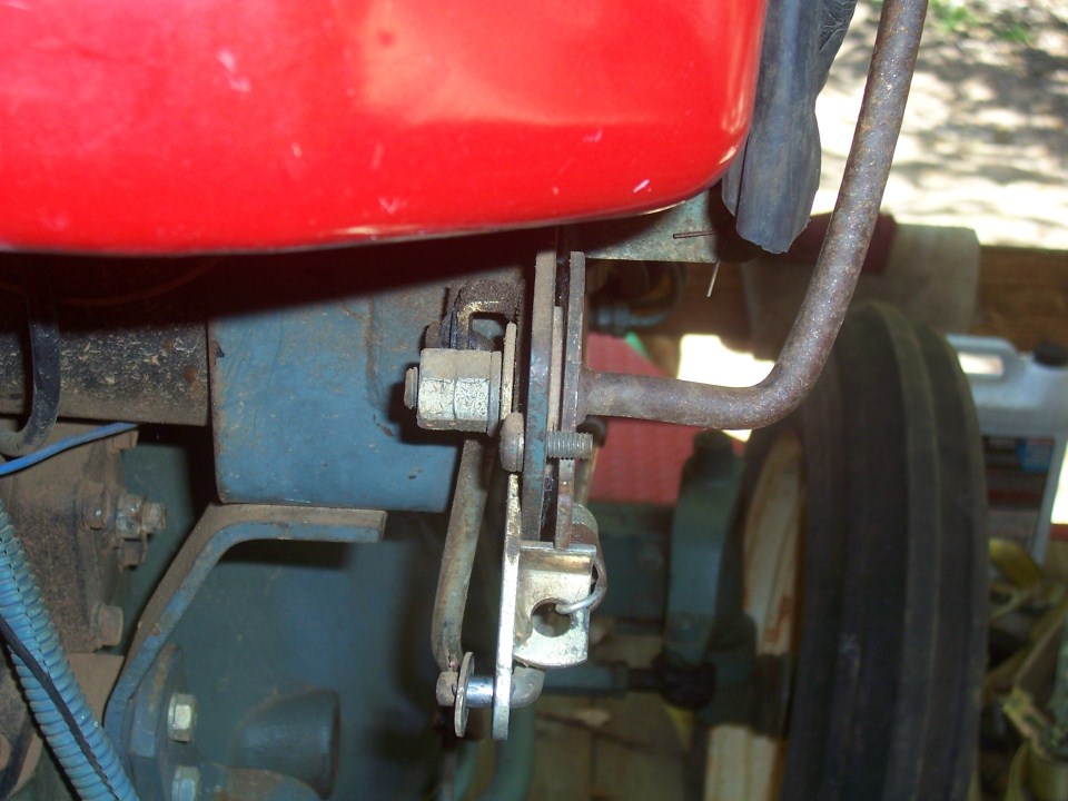

   / Yanmar YM1510D Camber & Toe Adjustment #19
After replacing the Wheel bearings I then could Adj. out all the Play with the steering column sector! The Adj. hard to get to. Pretty much all the same on the YM series
In the Pic your see were to look for the Adj. Set and lock nut on the base of the Gear box. That adj. took all of the last play out! That's been over a decade ago easy.
