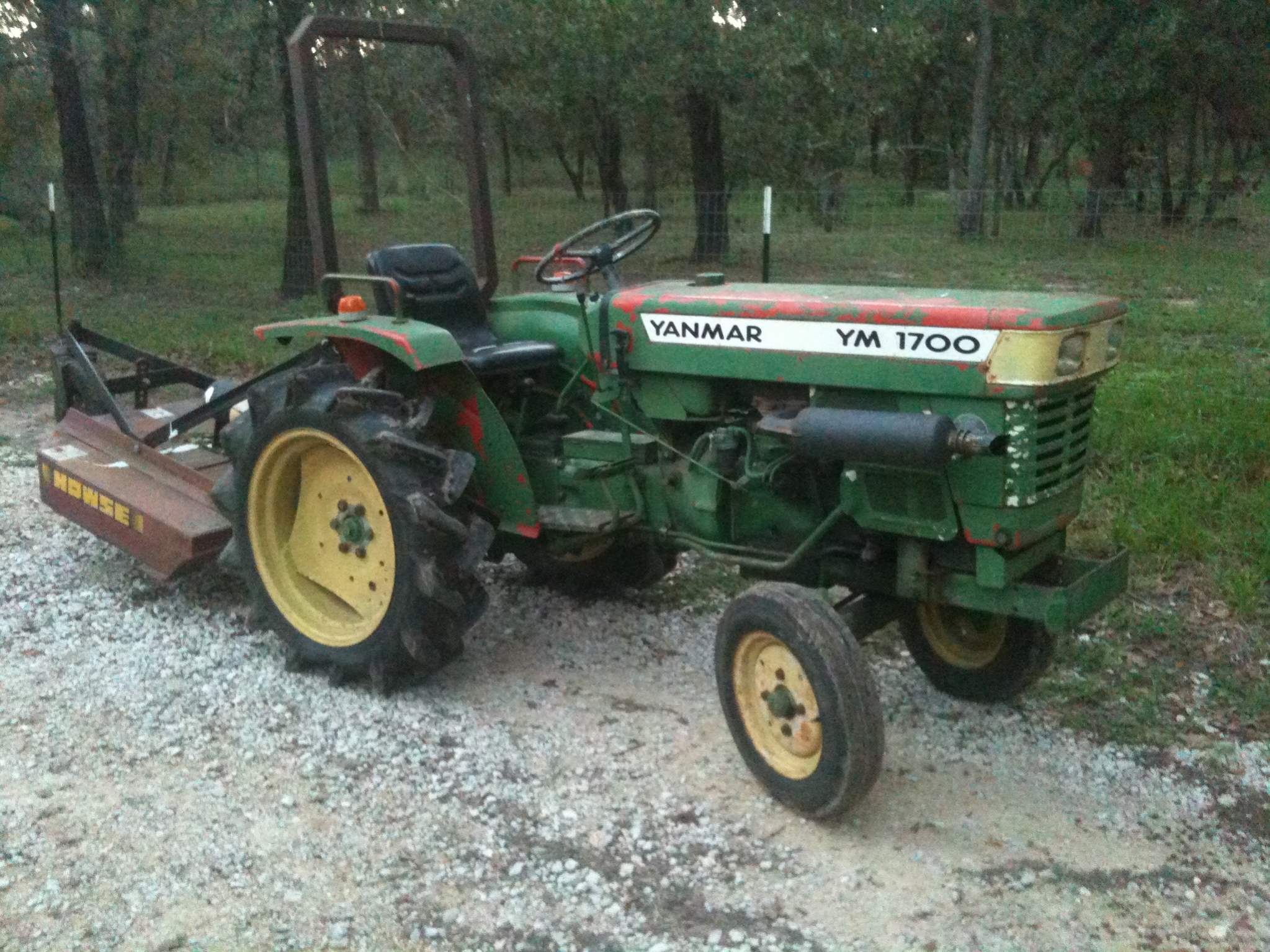

My co-worker has a YM1700 for sale for 1300 or so and I wanted to know if it was worth the price. It isnt beat up and everything works but it is ugly and he doesnt know what year it is. He has had it for 5 years and it was ugly when he got it. It comes with a 48" PTO mower deck. What do yall think? Thanks, Brandon

Well, I did it. I tested it out best I could, every gear and in high and low, PTO, brakes, etc. No issues with anything until I got it home. Once home I had to raise the mower deck all the way up to get the tractor off of the trailer and then it wouldnt go back down. I tapped on the solenoid under the seat and down it came. Aside from that, it doesnt need much I dont think. The temp light stays on from even cold start up so I will need to figure that out. It has always been like he said. I got the headlights to work, cool. The left brake is disconnected under the floorboard so I will need to connect it and see why it was disconnected. Back tires show some dry-rot but hold air. Tractor came with a new operators manual that says these were built between 1975 and 1977 and says that the manual is for a gray market tractor, so i guess mine is gray? Decompression lever was seized I thought at first but it moves now. The guy i bought it from knew nothing about the lever. 694 on the hour meter but havent noticed it working yet. Radiator has a neat-o bug screen on the front of it, full of bugs of course. This is my first tractor so im pretty excited.

If your temp light is on continuous then its wire is grounded somewhere between the bulb and the sensor on the top-front of the head. The way it should work is the sensor grounds internally only if overheated.
These often have a stuck brake after 30+ years. It sticks where the shaft goes through the cover. Disassemble, clean, grease the shaft with only the slightest hint of grease. About an hour or so for a first timer. The project is simple and obvious.

California is right about temp light, could be the sensor itself is grounded out internally. Remove the wire from sensor and see if light goes out, if not wire is grounded, if so, replace sensor. This ought to make you a good workhorse!

I see what you mean about "ugly". it's a shame about that botched paint job. You might experiment with some paint thinners/ removers/acetone and see if you can remove that green paint and get back to the original Yanmar red, and just touch that up, if need be.

No, that's obviously a red Yanmar with a bad green paint job and an aftermarket or homemade sticker. A pressure cleaner might strip that green paint off.

His JD green/yellow wheels are just a (bad) repaint over the factory red.
The earliest YM1700/YM2000, with the hood hinged at the rear, were the same (ugly) pale 'leisure suit green' as my US Yanmar.
Then on the Japan-market ones they switched to red when they went to the later hood. The US versions remained pale green after that change.
The difference between Yanmar green / Deere green is visible if you scroll up and compare the color in my avatar photo to his thumbnail.

Took out temp sensor, cleaned it up and reinstalled, and temp light still on. Disconnected the wire and light went out, so I will need to get a sensor. Where can I get one of those?

Yeah, you can see the original red under the peeling green paint. Maybe I will try to get it off of the top of the red. I know some of it will come off with the pressure washer on medium blast. My folks say it is Camo...
