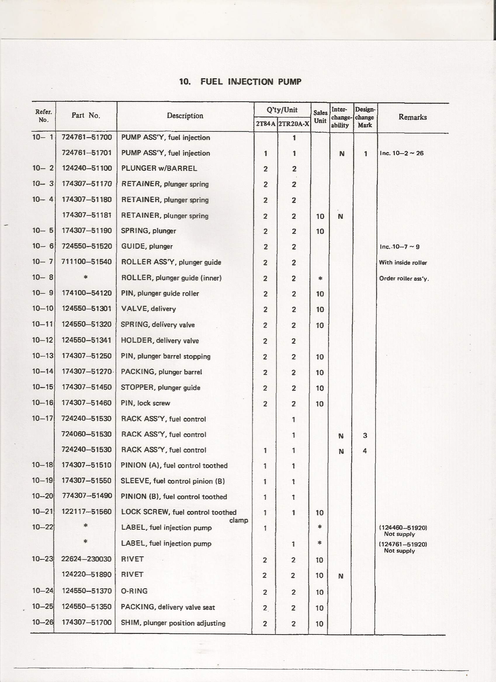

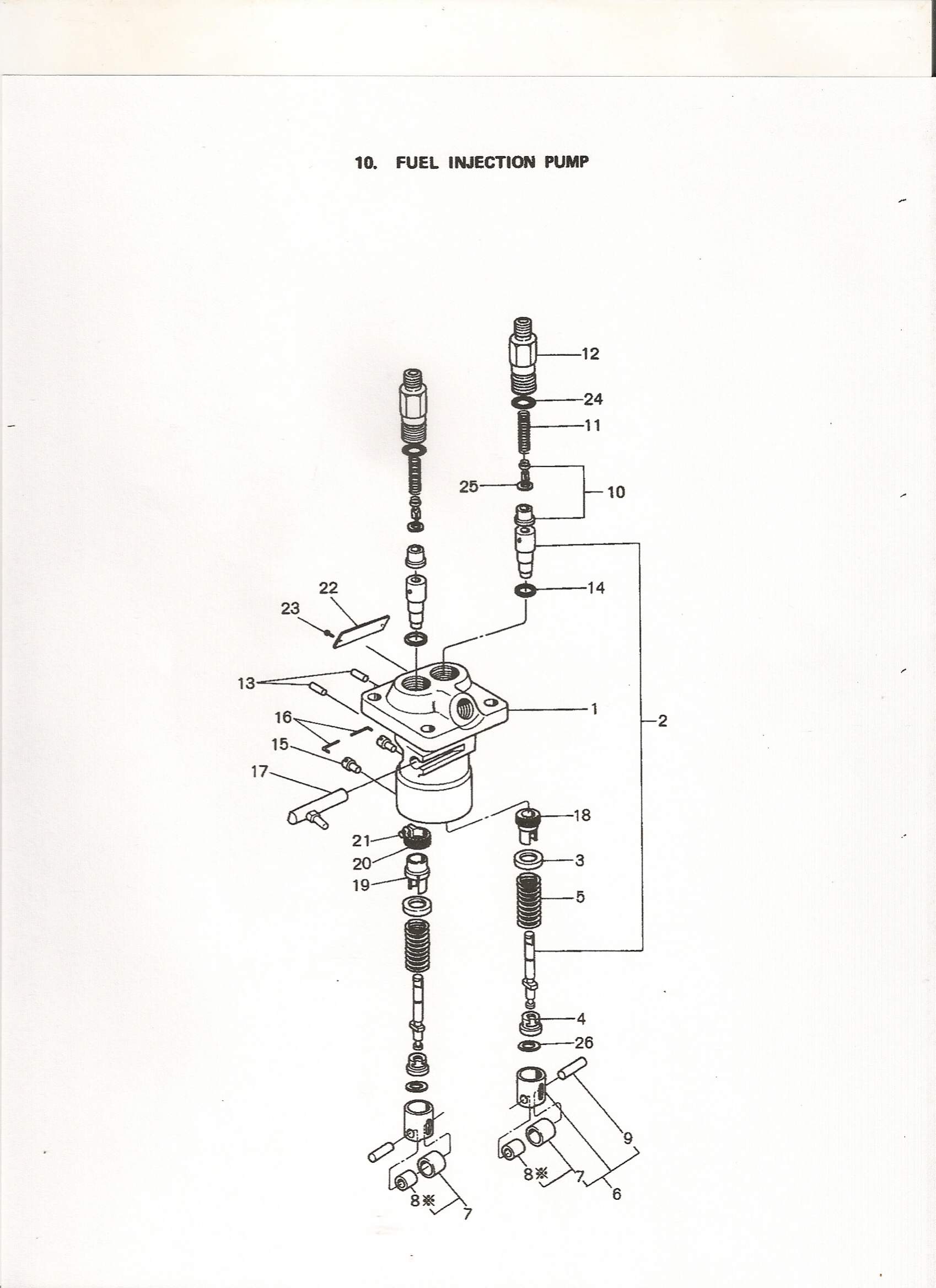

#18
I had it soaking all day in PB Blaster. I rinsed it with an industrial degreaser, kept working and the rack suddenly freed up. I still think i have problem internally. Does any one have a breakdown with part names?
   / yanmar ym2000 #19
Here is out of the 240 parts manual, I think the same as your 2000.
   / yanmar ym2000
#20
thanks Winston1. I doubt if i take it apart but at least i can call the parts by their proper name.
