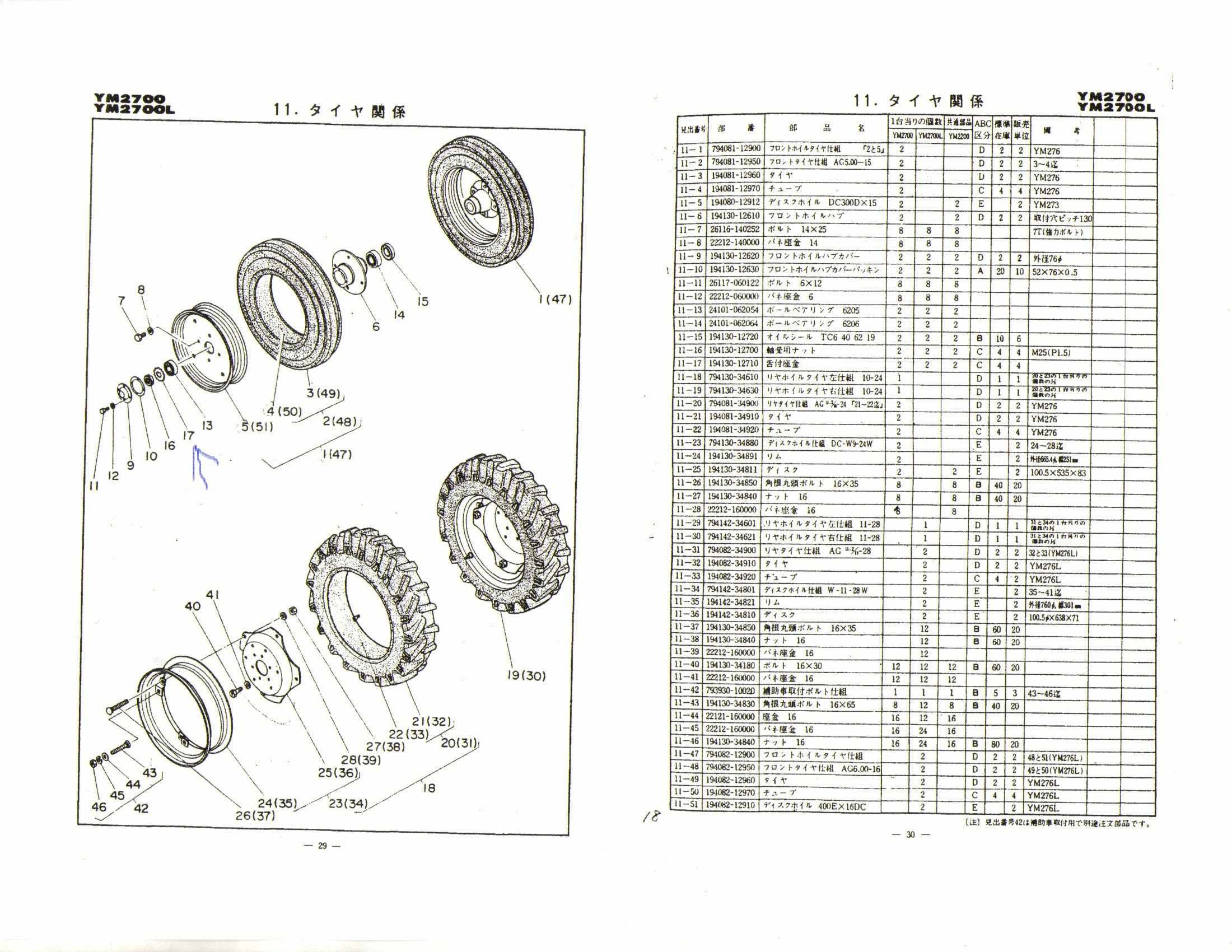

This is the #17 in question.

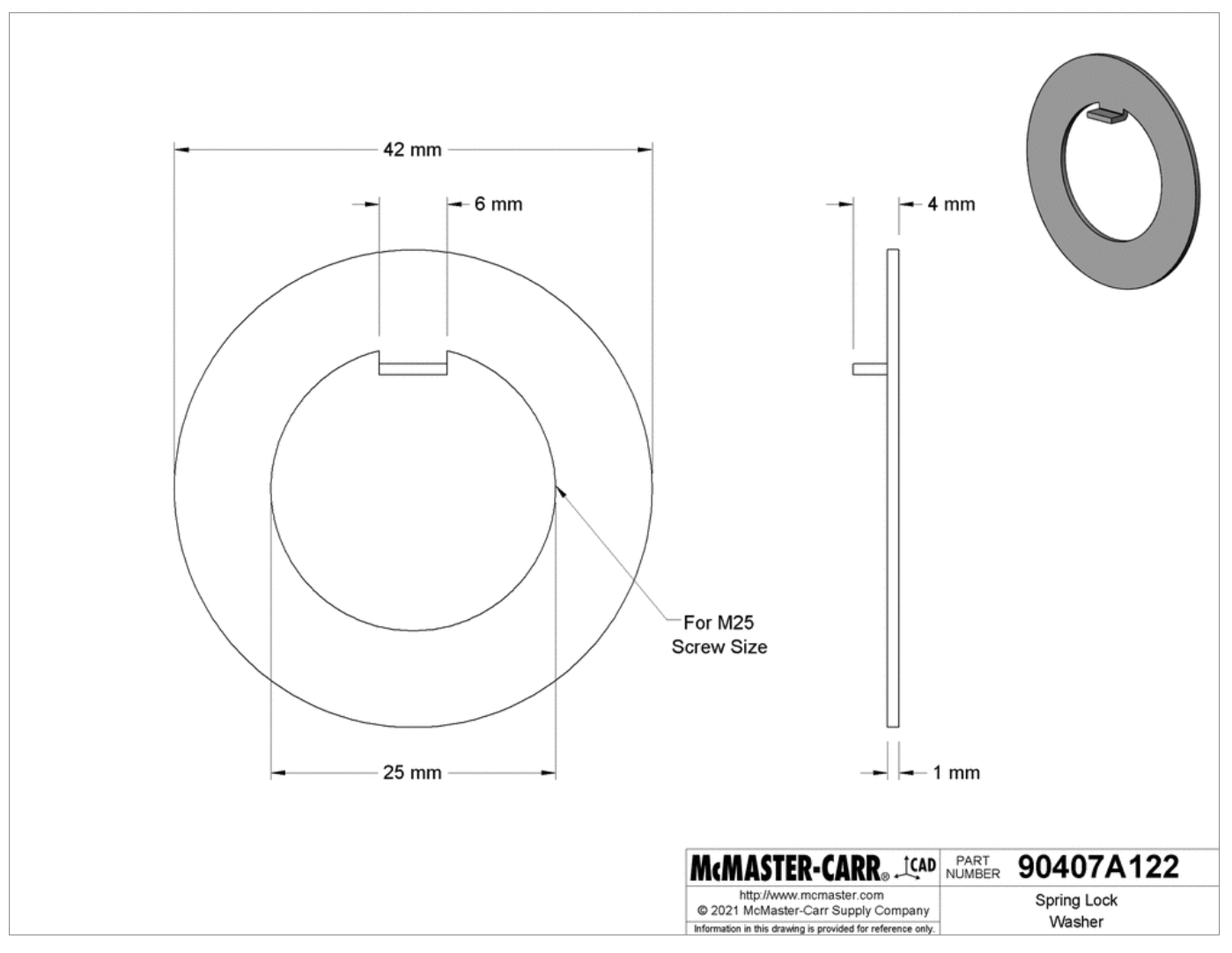

So, item-16 shows 25mm (about 1-inch hole)
I jumped to McMaster-Carr and found these.
I would assume this is either it or close enough.
The manual sure doesn't give a good image of the part. Not sure if the tang is internal or external.
I know it's not star-tanged because a bearing sits on the other side. So, it has to be smooth like a washer.
Other option is to find a 25mm nut as a nylock and use a 25mm ID regular polished chrome washer to seat against the bearing.
yes, that is the #17 I am talking about, thanks for the website. I have been looking online and have found this type of washer just not the right size. Looks like they have what I need. Thanks so much!
It is a tanged/toothed washer on the outside. You are correct, it is right at 1" ID
