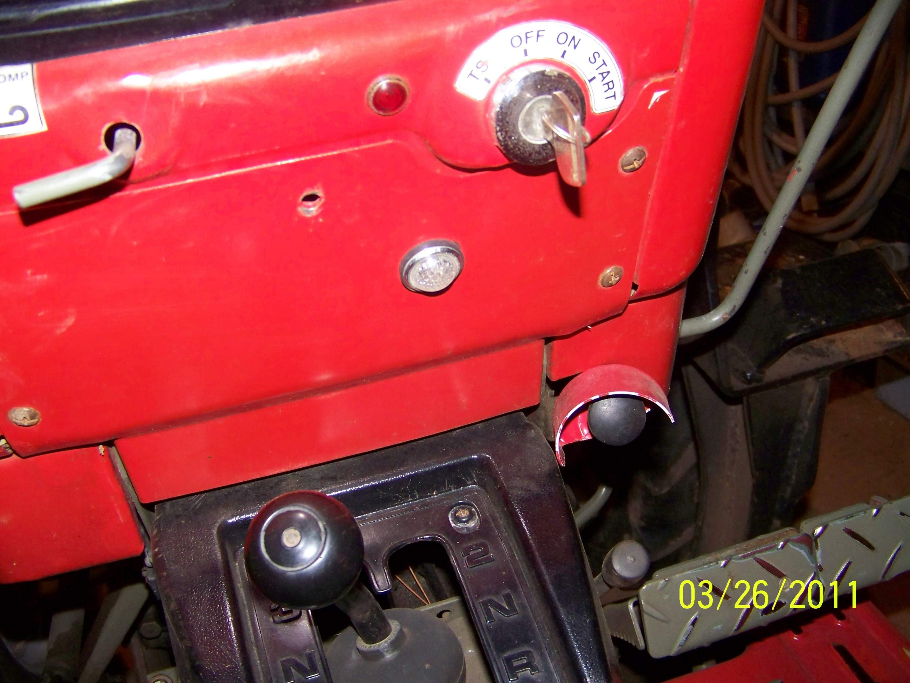

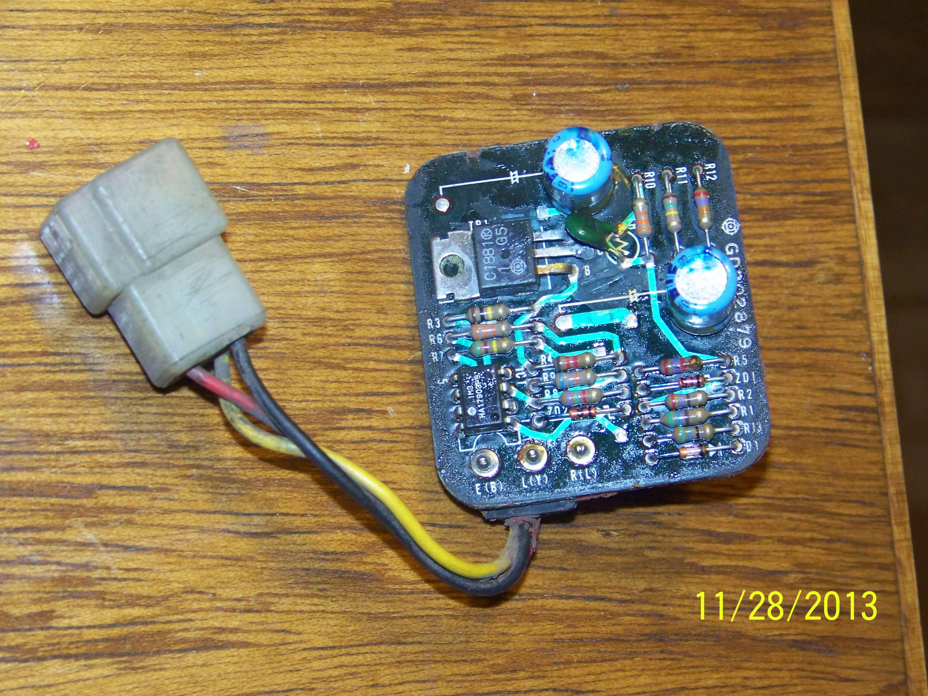

You got me thinking winston. How does that red light work? What does it sense? Heat, resistance, time?
Maybe it's something we could add.
/ Yanmar's Thermostart #23
Really can't answer with much knowledge. I can tell you this little black box was the control unit on it. It quit one time, I took the box apart, found something loose, soldered it back and it worked awhile longer and then quit again. It is the little box just to the left of the regulator.
