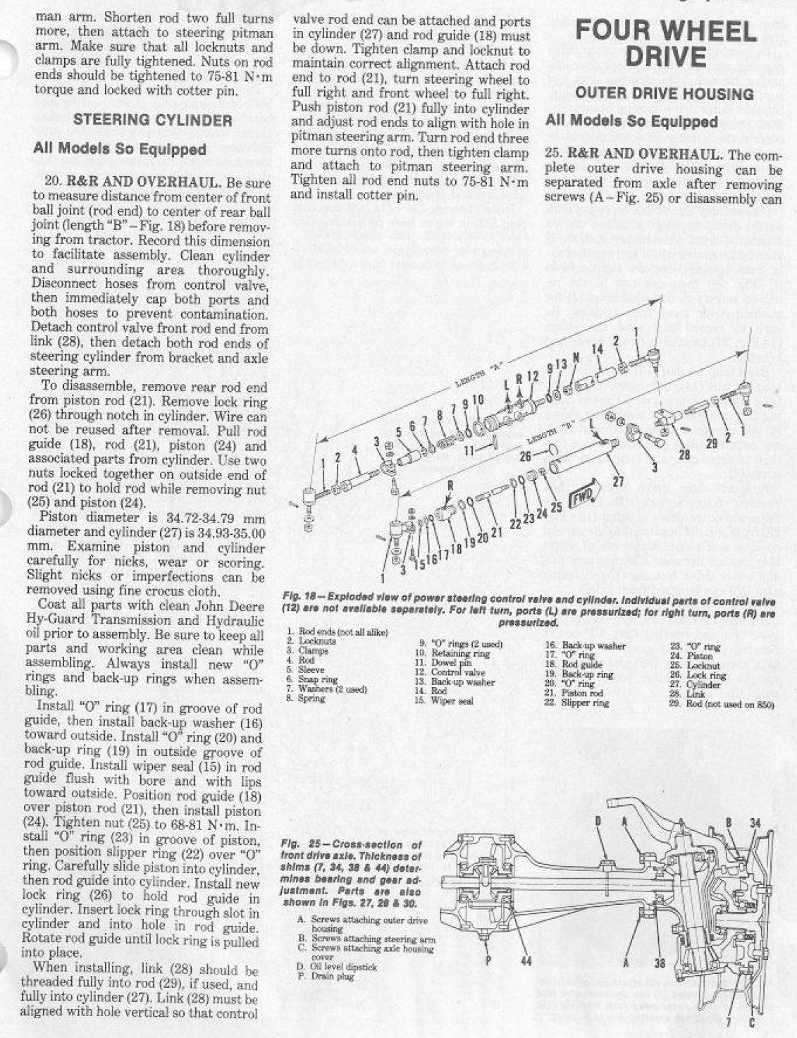

The 336 parts manual has a power steering breakdown. Might help you, yours will be very similar if not the same. Box

See attached. A few members donated these docs. Like Winston mentioned, it's not clear if one size fits all or there were certain devices with stroke length differences.
And for US models, there was a US optional equipment that is a bit different.
Attached are all the Yanmar PS docs I have to date. You can glean a good deal here.

Additionally, Yanmar made the YM Series along side the John Deere 50 & 70 Series too. Some more gleaning. :) Click on the image, then click a 2nd time to zoom in. When done, click off the image to return to the posting.
