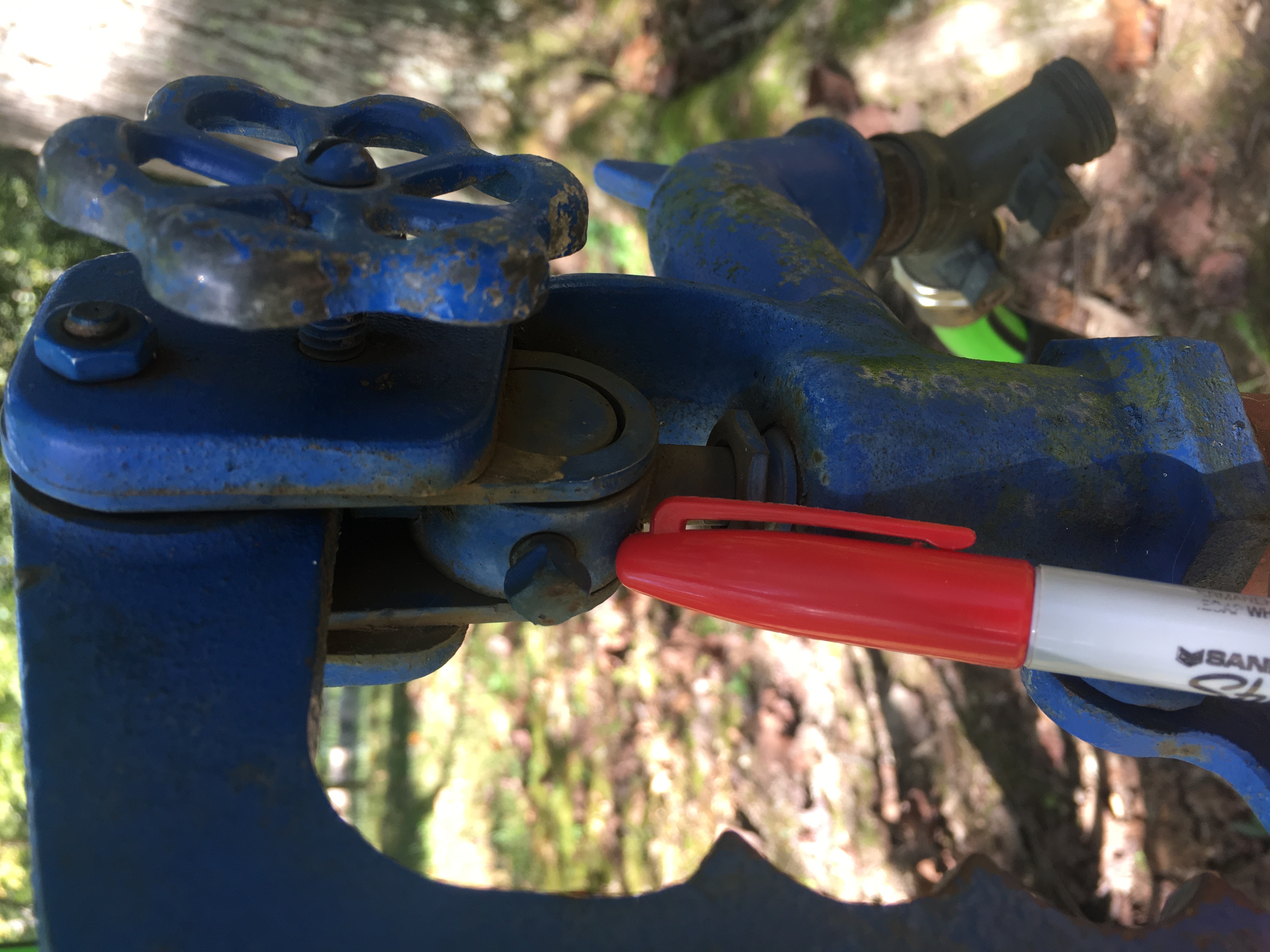

Does anyone know if it is possible to replace just the top (the part with the handle you lift up to start water flowing)?
The only thing wrong with our hydrant is the top has sprung a few (well, quite a few) leaks and the thought of having to dig up the entire hydrant, which is at lease 3 feet down, and reconnecting a new one to the underground water line is not something that fills me with joy, particularly since it is the only water source in our barn.

I have done a variation of that many times.
When the hydrant starts leaking, I pull the top end off, leaving the base, and using a rebuild kit, replace the gaskets, then put it back together. So far, no problems with leaks after the rebuild
If I understand you correctly, replacing the whole top mechanism, handle, rod, etc, would be overkill, unless they are damaged beyond repair.

/ Yard Hydrant Question #5
If its just leaking and not damaged and its like most hydrants.
You can adjust it to stop the leaks.
In the first pic there is an adjustment for the rod length.
Loosen the screw and raise the handle a bit, then retighten the screw.
This will stop the water from leaking in the off position.
In the second pic is the packing nut. It can be tightened to stop leaks around the shaft.
Of course sometimes the seals are too far gone and as the others
have said a rebuild is in order.

Thanks for all the replies! The problem we’ve been seeing is the valve body (the red thing on the top) was seeping water - It is like it had pinholes in the casting. I tried using the putty that you mix (can’t recall the name now) and even Flexseal - nothing worked 100%. Woodford does not offer the ‘red thing’ as a replacement part so I will be buying the entire hydrant just to get that part. Still better than digging up the current hydrant.

You didn't say who mad the hydrant you have, but I've got one yard hydrant down at the farm that is one of the Chinese products. Someone had adjusted the rod too tight and bent it so badly that it would never shut off completely.
One day while walking through TSC I saw their hydrants and thought "what the heck", so I bought an entire 4 foot bury, got home, unscrewed the old top and pulled the whole assembly out, screwed in the new top complete with the rod and all. That was three years ago, haven't had any problems since.
On mine, it took two people to unscrew the old top using a 3 foot and a 2 foot pipe wrench, didn't want to take a chance on busting the fitting down at the line, but other than that, no problems at all
