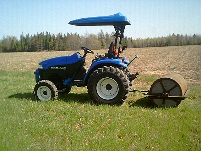

I tried out the roller. It is about 3000lbs total. I wouldnt want to go any heavier if you have some hills. It flattened the bumps about 50% I would say in my field. It seem to take out the small humps but not the bigger ones. I am going to roll it again next spring a little earlier then this and should get it good enough. It is terrible to haul a teddar through the field it so bumpy and reeks havoc with the tines. I attched a picture when clean.......

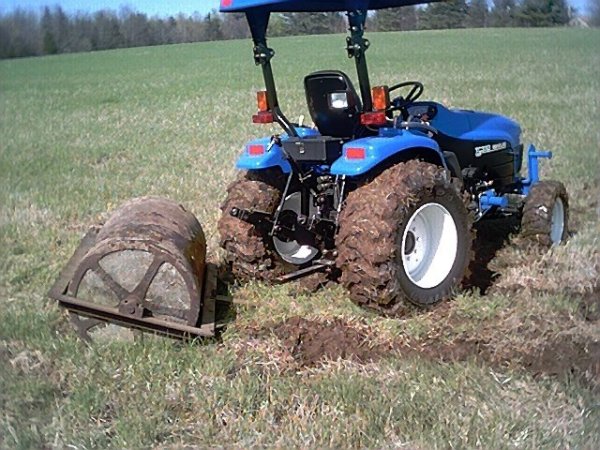

Here is picture when it got stuck in a soft spot. Got my tractor all dirty /forums/images/graemlins/mad.gif I had to hook a chain on to it and get on dry ground 30 feet away to pull it out. Wasnt easy!
