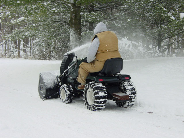

Home Depot, Sears, TSC sells 2-stage snowblowers that will fit your tractor. I live in a snowbelt area where we average 10-15+ feet of snowfall annually. I too have a gravel drive that I bladed with my garden tractor for several years. I've had a blower for the last couple of seasons and it works really well.

Argee, are their blowers 'generic', or specific for my Sabre? If it is generic, is it hard to adapt? Thanks! /forums/images/graemlins/laugh.gif

if you go the tractor-blower route, add an extra 150 to 200 pounds of ballast to the rear of the tractor along with chains. I have a 30 year old sears with a 42" blower and I have great traction going forward and blowing. But try to back up with the blower lifted and it takes weight off your rear wheels. I added 200 pounds of home made ballast to the rear of the tractor and it works great now.
