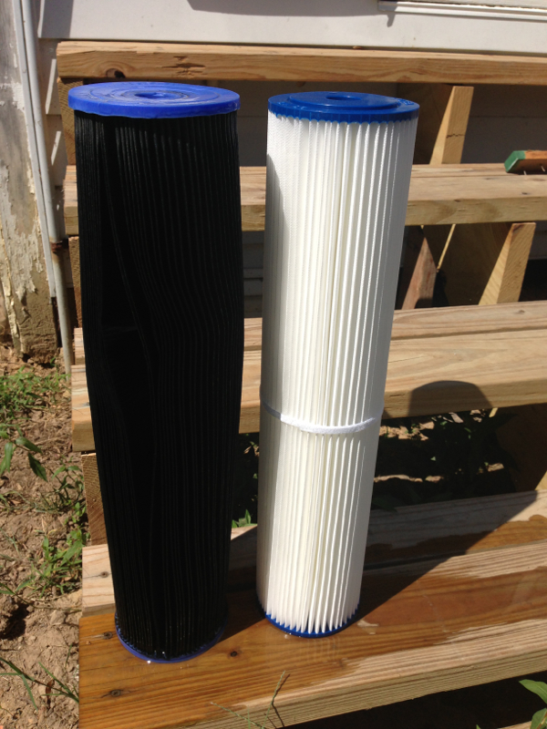

Here's a pic of new and old filter. Pretty rough. That's 3 weeks.

Get it tested!!! Something isn't right there for that filter to be that black (can I say black anymore???) in 3 weeks. We live in a high iron area and my filters are bright orange after about 3 months.
   / Ye ole well water stank #9
I don't have much more to offer to help your situation, other than no filter should look like that after 3 weeks, you have something else going on. I am going to ask something disgusting based on the color, is there any chance your water is close to someones septic / leach?
