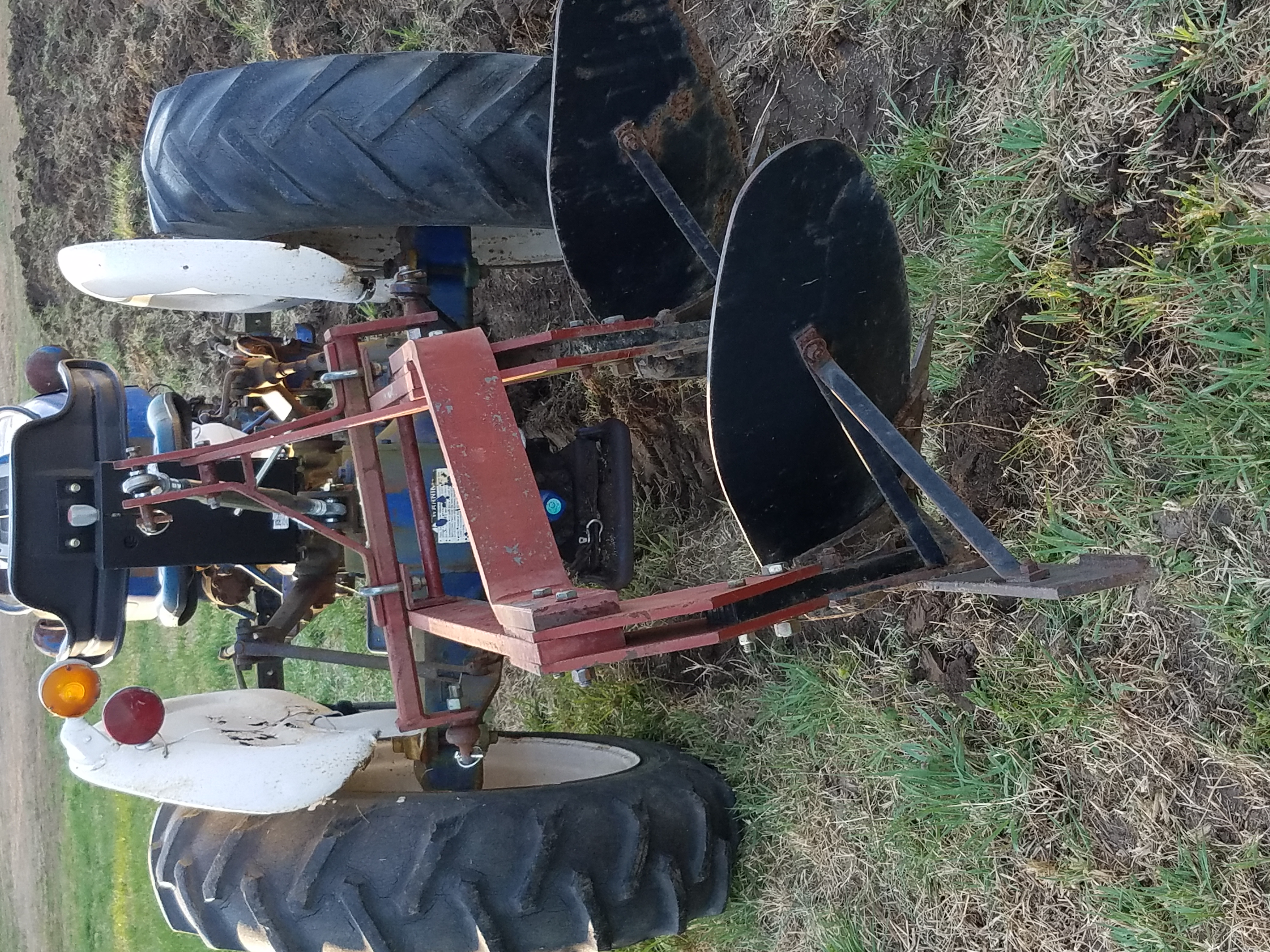

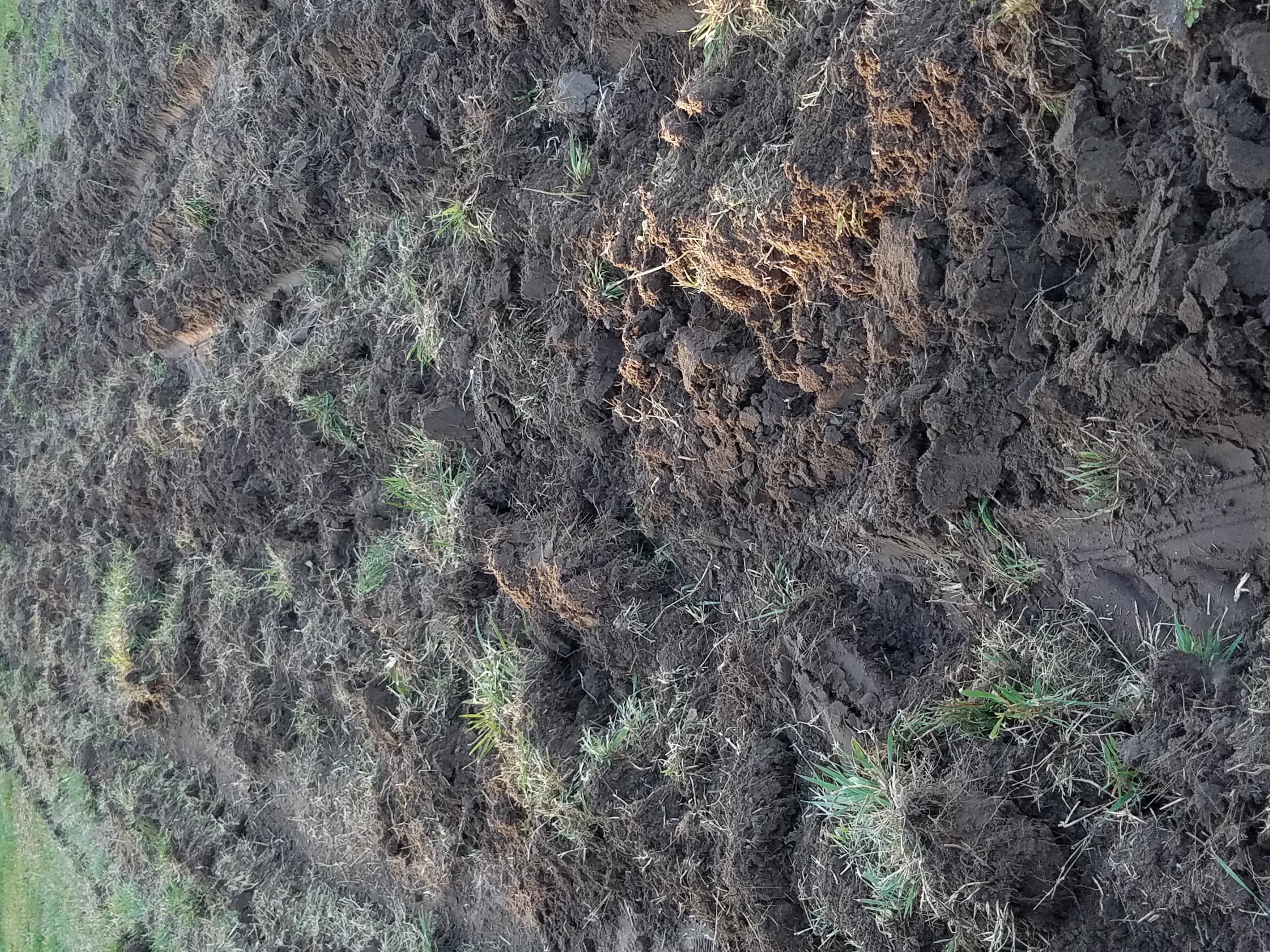

I wish I could get 2 furrows, so not gonna get it to the third one for a picture. I can occasionally get one furrow with a real uneven bottom, then I go back around and drop the wheels in there, and then absolutely nothing more times than not. Occasionally I can get it to go down some and then it either stays around 2 inches deep or it will dive to around 7 and pop both back out the ground. (This is without making any adjustments between the 2 extremes)
The plow seems to be in excellent condition, it was practically brand new when I got it. I do hear a pop sometimes coming from somewhere on the plow when I stop and pull it out the ground but can't trace it to where it comes from.
When I had the tractor on blocks, I had the plow completely unattached on the ground, and then adjusted the lift arms and top link to it to attach it. Is doing that going to make my measurements be that far off to work at all?
Here are some pictures. First one is with the plow in the air, second on the ground. Of the 2 pictures showing the quality of the cut, the one with me off the tractor makes the ground look alot better than it really is. The one taken from the tractor does it justice to show how horrible it really is. I'll add too that it still is pulling to left all the way, but my chains stopping it from going further, but the front plow is staying in correct position with where the furrow wall should be.

Thanks for the pictures. As shown the plow share points seem to be acting as rippers.
Looking from the back; try extending the top link and also extending right three point adjustment. No quarantees as I've of the mind the cross member also needs some adjustment but should work as is. To me the right lift arm could be longer.
Do the adjustments in the field and keep at it till you're satisfied. Don't get hung up on flat, level and blocked adjustments.
I'll give it a shot and see where that gets me. Hopefully this evening if the rain holds off.
