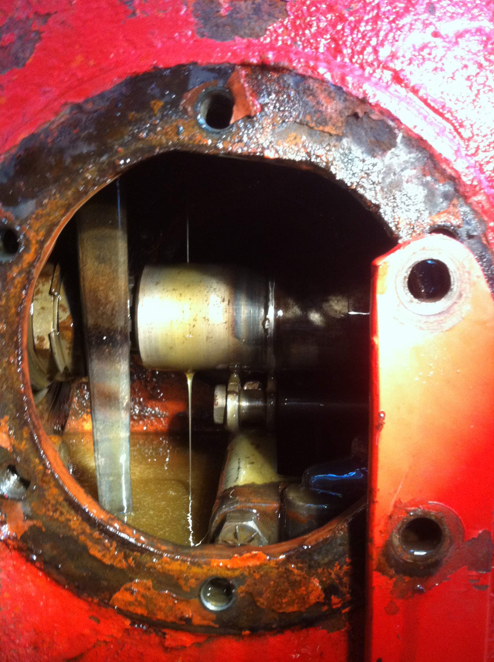

The oil being splashed up. I opened the inspection plate per your suggestion. If I look at the manual right sort of even with the front of the inspection hole, oil was being pushed up, I saw no sign of any oil except the oil being splashed (or bubbled )up from the front of the pump. Is that the area of the relief pump.

some oil movement is normal.

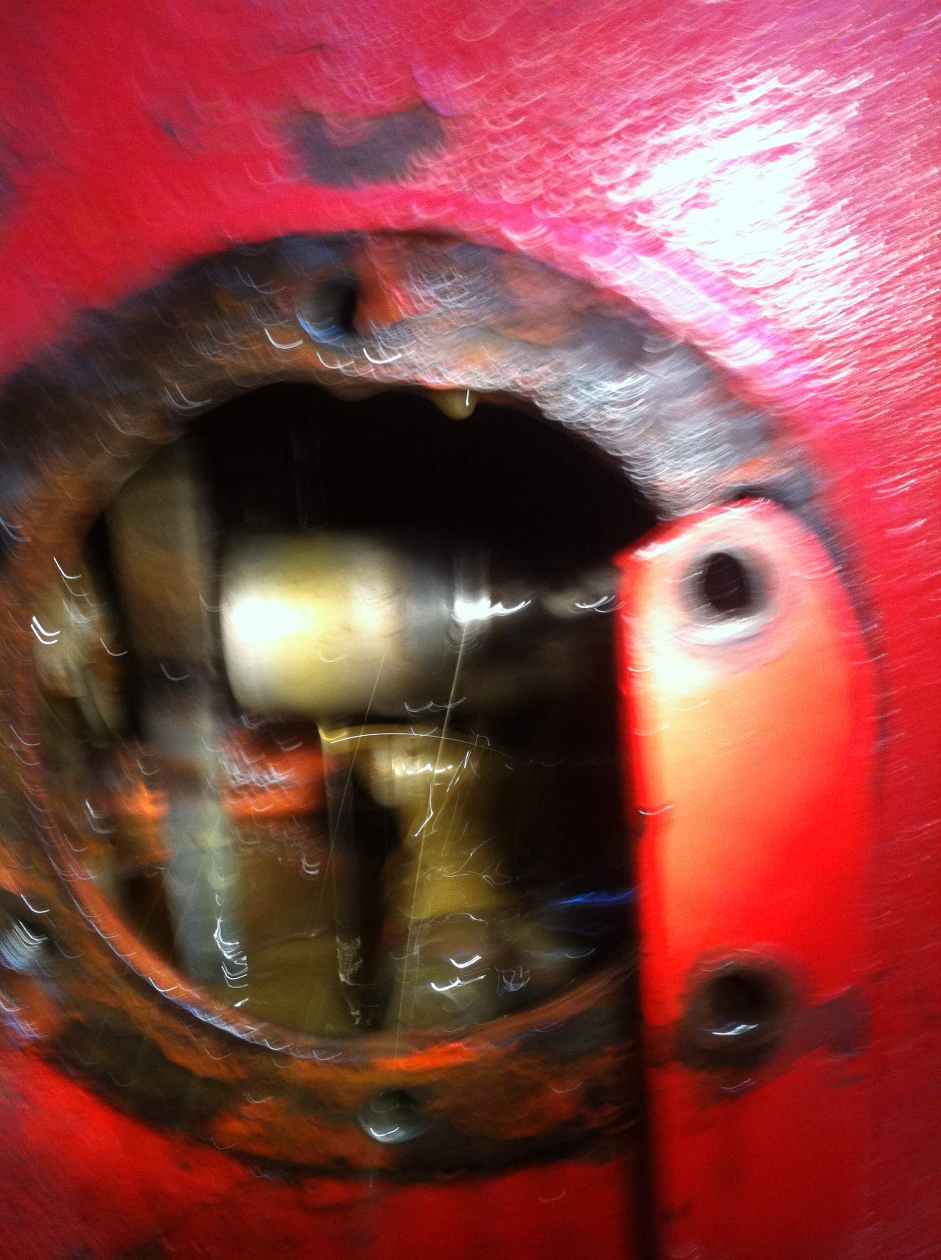

ATTACH=CONFIG]384286[/ATTACH] oil leak 024.jpg
Soundguy, I hooked up my real disc to the tractor today, opened the inspection plate and this is what I saw. I'm guessing that stream coming down is a bad thing

just worn piston rings, cyl bore or gasket under the cyl. no biggie.. just leaks..

Ok I know I'm a pain but. there is a gasket and ring kit for like 25 bucks and there is one with the sleeve for 95 would you go ahead and replace the sleeve out of principle or try to get by cheap. I think I've got the answer to this question but how does the oil get from the pump to the ram. I see what is called a oil tube on pg 96 fig. fo145 that is the only thing that I can find do do this, if it is, how much of a pain is it to line the tube back up

one with a sleeve? sleeve for what?
the stand pipe on the side of the center housing is how the oil gets from the pump to the top cover.
unless it was perforated.. there is no reason you should be concerned with removing it.

should of called it the ram cylinder? or cyl
